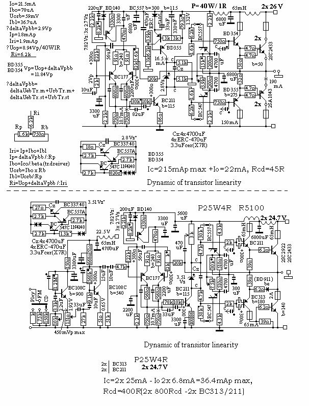

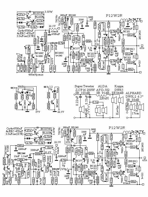

Calculations.
I guess that they are simplified thanks to the output power
devices lacking emitters resistors....
Amplifier power P = 200W does not have the clean power even for P = 1 --- 2W, good luck in the new projects.😀😀😀!

JMF, Thanks for the legwork. I guess we just have to wait until Adorn runs out of enthusiasm or conviction that this campaign is doing anyone a favour. Actually, he has responded to my provocation with the deeper specs of the TO66 drivers, BD354/5. However, I can't see any day soon that I would stick 3 x 65mH chokes in the power rails of an all-too-basic 25W AB class amplifier anyway. 😀
