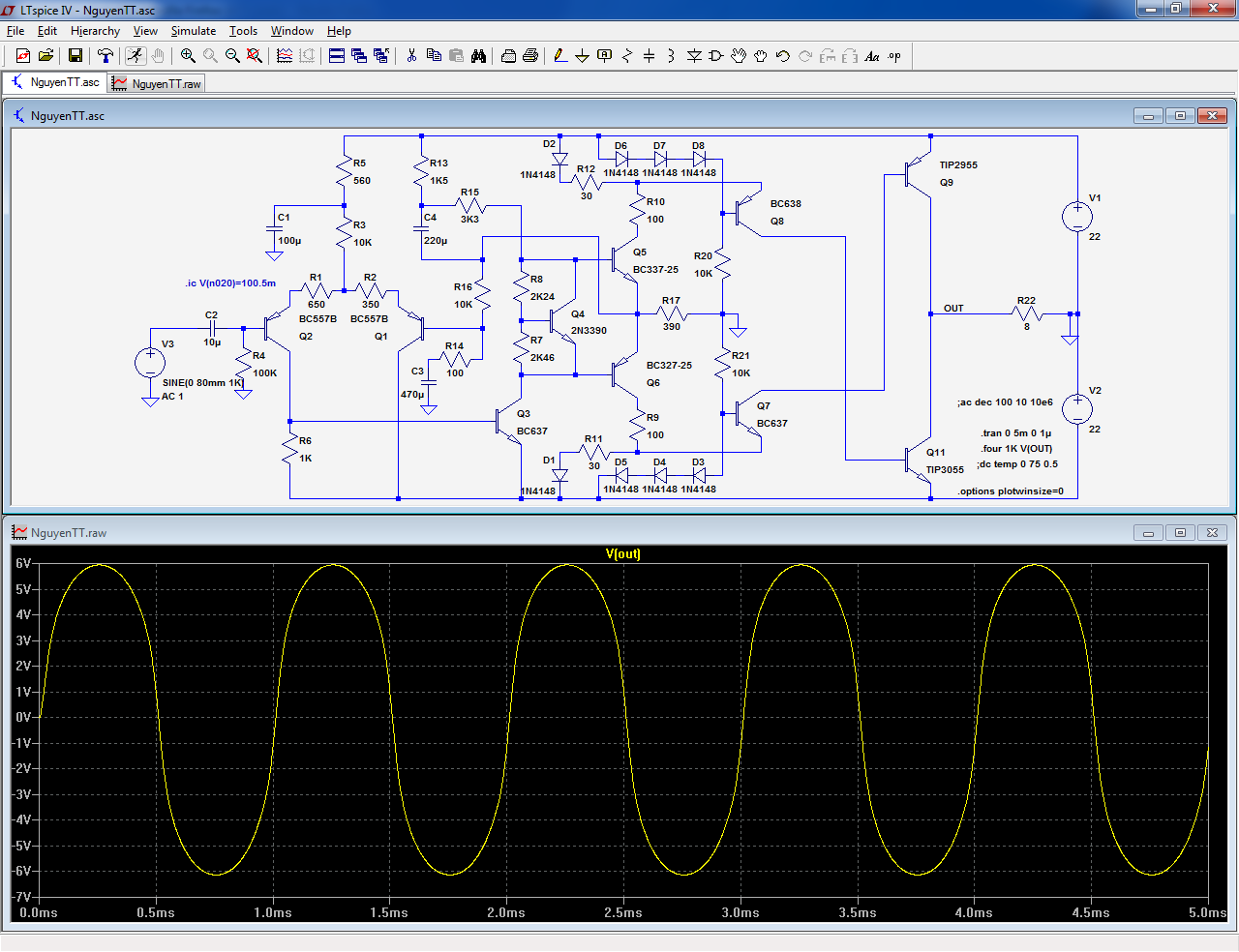

Hi, i noticed you had seen the BC337 NPN mistakes in the circuit & corrected them in your Pspice sim to BC557 PNP's 😉
Was there anything else you corrected ?
I have also changed the 1K resistors to 100R

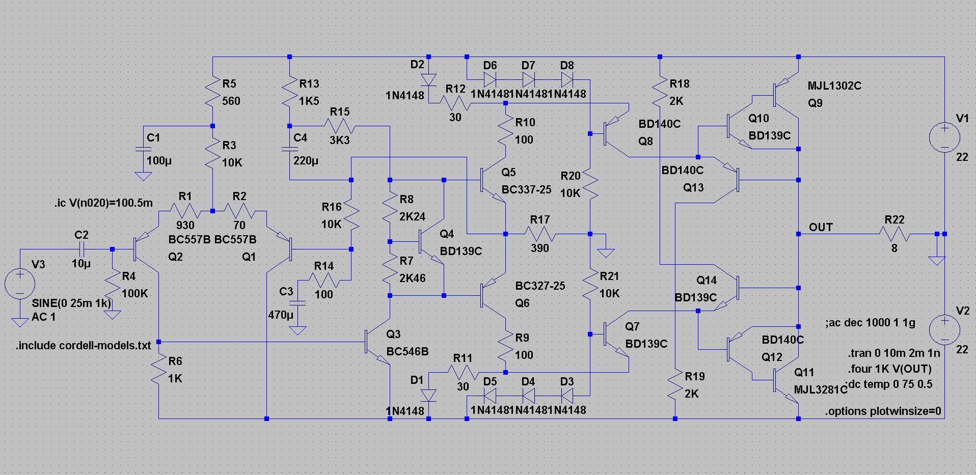

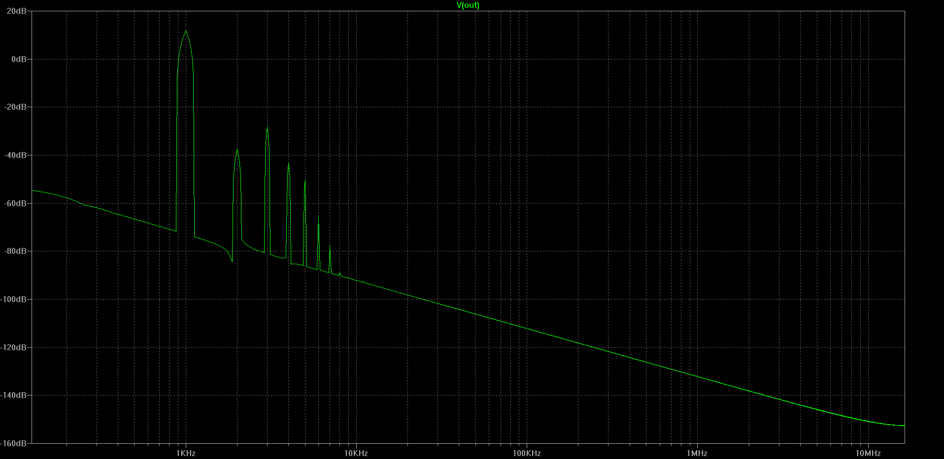

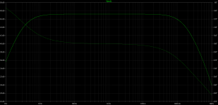

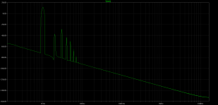

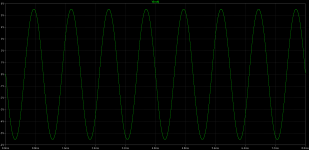

OK, here is a quick-and-dirty proof of concept.
It uses an opamp, but making a purpose-built discrete amplifier having better performances than a general purpose opamp for that specific use is not difficult: just tedious.
The important part, the mathematical "engine" is discrete.
This circuit is neither particularly accurate, as it uses many shortcuts and simplifications like V-I conversion with simple resistors, nor very clever because it is the direct translation of the mathematical function into circuit, but at least it actually does its job in a deterministic way.
A real circuit could be simplified and improved in many ways, here for example, the principal function resistors are 1Ω-100Ω-1K-10K, which doesn't give too much headache, but is certainly not optimal.

Of course not. I thought that was clear from the beginning:
This class of circuits, even properly implemented should have nothing to do with audio signals, and be confined to industrial processing and signal conditioning.
Anyway, by these standards my circuit is undoubtedly bad (I have no intention of building such a thing), but Tan Tai's is even seriously worse, quite visibly: it doesn't even do what it is supposed to good or bad, it simply harms the signal it processes.

I said that this class of circuits has nothing to do with audio applications. That include my circuit, and any future one, even one performing that function in an ideal manner. It could find an application in an effect box for guitar or something of the like, but that's all.
Anyway, my solution is demonstrably better: it is stable, predictable, introduces moderate amounts of distortion, and most importantly it does its job

OK, be specific: in what matter exactly is it much worse?
I think other members will have formed their opinion about this affirmation...

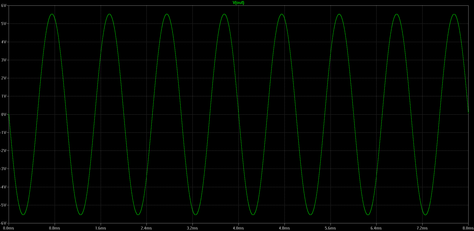

Another assumption of your superiority.
It does not well its job, because:
1. it does approximately the math function.
2. it does very badly the function of amplify an electric signal that is much more important.
With your simulation, you haven't demonstrated well nothing.
you have tried just two points that are also relatively close.
Now I think you'd agree with me that for two points can pass:
1. a straight line.
2. parabolic curve
3. hyperbolic curve
4. quadratic curve, etc
so to verify the mathematical function shoulda simulate at least 3 points. :smash:
Normally my simulations using the following steps: 4, 8, 16 ohms

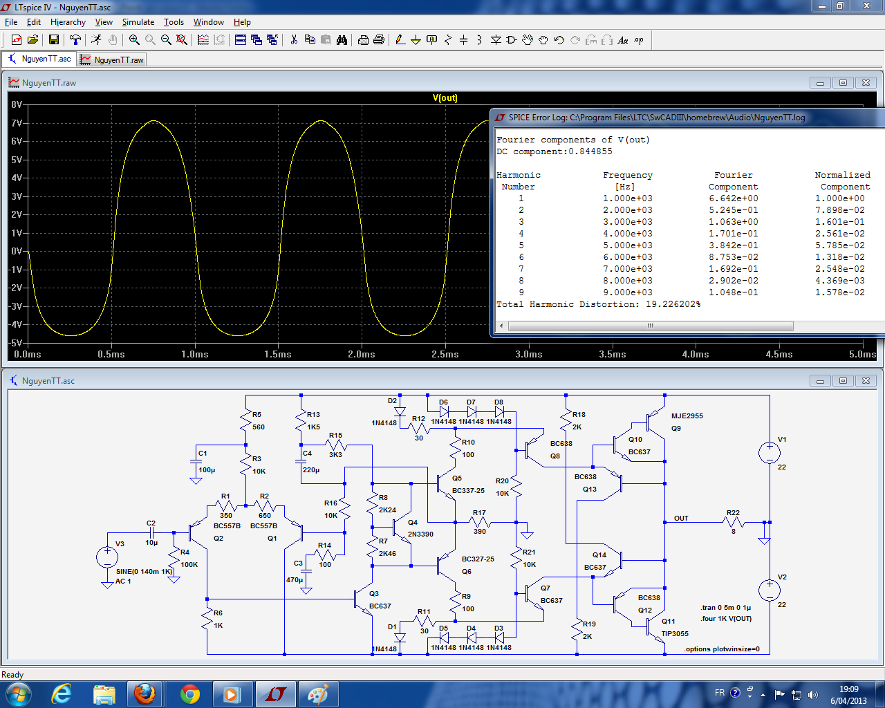

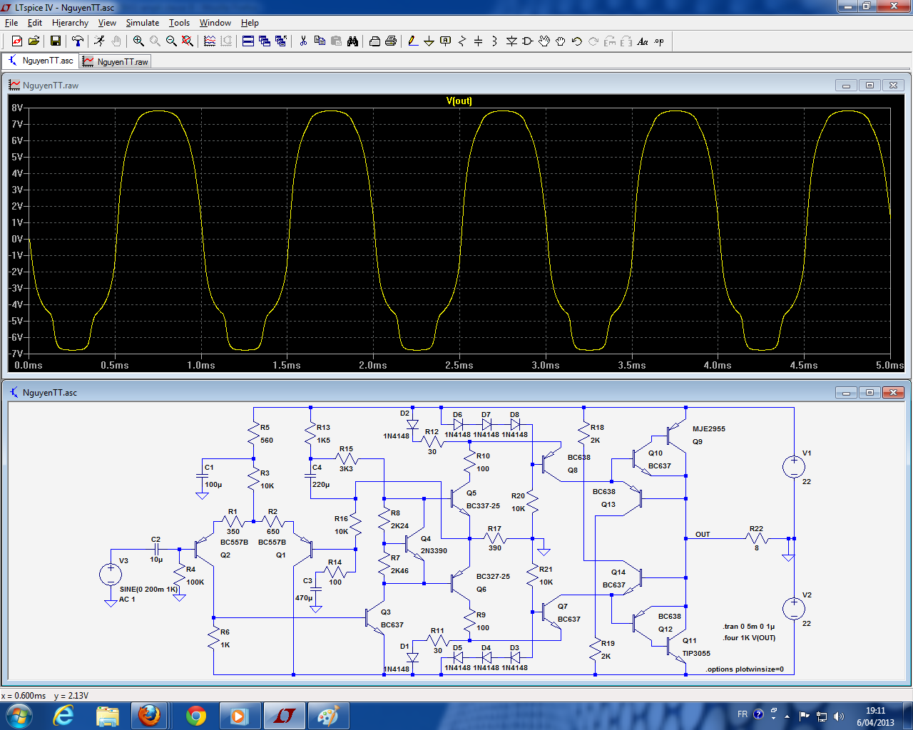

...and just stick to the somewhat unusual circuit of the first post
I found the circuit intriguing and unusual, and I wanted to see if it delivered on its promises.
But I was quickly disappointed: the thing appeared to be a complete lemon.
I wanted to make sure I hadn't missed something, which is why I asked for unbiased second opinions.
Apart from one (with very few supporting evidence), they all went in the same direction, and I am unable to find a single redeeming feature: not only does the circuit perform awfully from an audio perspective, but the constant power claim is pure fantasy.
