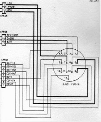

Attached is the nak pinout from the schematics of a CD-45Z deck. you will notice it has Data In, Data Out, Clock In, Clock Out, Reset and Mute lines as well as a DSP Select line.
Now i suspect that these are called different things by diff mfg. most have Clock, Data and a request line.

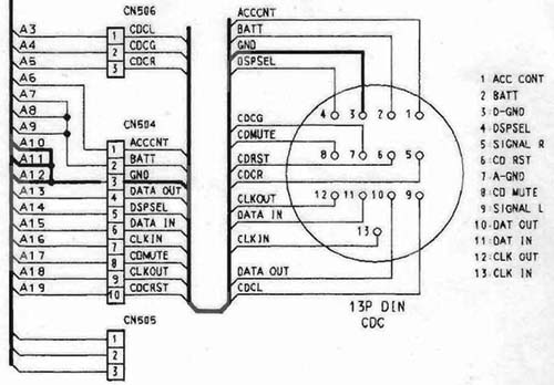

I have been digging in quite heavily again on this project. I am currently building a 13pin to 13pin break out box so that way we can use a logic analyzer to bit bang the bus and decode the Nak secret. which seems most likely to be a Sony secret more then a Nak secret as Nak used Sony chips for most of the CD control D/A functions etc. they used NEC microcontrollers and Sanyo IC's for everything else.
I managed to get a hold of an original service manual for the TD-45Z and for the MF-51 and while there were no major secrets revealed, there has been a tiny bit added to the pile here and there.
The Nak Decks work with the sony 10 disc changer so i would bet you could fool the nak deck into thinking you had a 99 disc changer for iPod control of play list's. but that's speculation. I have no doubt there will be some serious limitations controlling an iPod through the nak head unit. but all the basic commands should be workable.

Update on my earlier post. So far we have managed to decode the Nak protocol and have figured out how the Disc, track and Time information is transmitted and now just need to capture and decode the operational controls. I also picked up a very cool USBee SX Logic analyzer that will make this very much easier to do!

Clock, Data and Ground is all you need to control ALL of the naks functions. you can send commands to the internal MCU and have it do anything the front faceplate would do! it would be even easier to just use the IR line. that's just signal and ground and then you can do anything the remote would do, which is pretty much anything the faceplate does.
The hard part and its not even that hard, its figuring out what type of display the stock radio has and what communication is needed to talk to it from a MCU. once you have that down the rest is pretty easy.
The stock Nak faceplate however...has limited characters. the display is dedicated so titles and such are not possible. and i will be emulation and external CD changer, albeit one with 99 discs etc. I will not be messing around with faceplate stuff.
