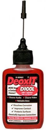

One common and often overlooked cause of PC failure is simply the connector contacts, of which there are "thousands" for memory, CPU, PS, buses, etc.
Blow out the dust, take everything apart, clean all the contacts with a quality contact cleaner like Caig D100L and re-assemble.
Fixed countless of seemingly dead PCs, and other industrial / consumer / automotive electronics this way over the years.
And of course, just exercising the connectors can work too, but it's more effective with the cleaner.
