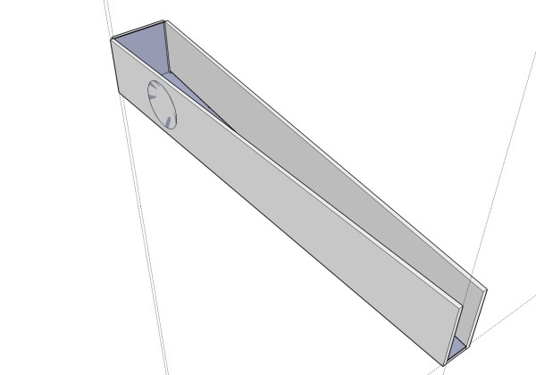

Ok, trying to draw this design. I'm finding it difficult to lay it out as a folded design. How do you calculate it, as in the folds? Say I want a height defined as 770mm, how can I work out the folds and thus the depth of the box? We know the internal width is 12" for this design.
Drawing it as a straight model is quite easy as you can see in my first attempt at using Sketchup 😀 . Is that program ideal for drawing speaker designs, only really need 2D I think. When Planet 10 drew a box for me it looked really neat as a 2D with dimensions, what was used?

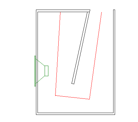

Dr.EM said:how can I work out the folds and thus the depth of the box? We know the internal width is 12" for this design.
I'm too lazy (or busy) to learn sketch up - one of these days.
Line length is down the centre of the space, as illustrated
in my (MS paint) drawing (red line).
I have had more luck with a scale drawing on paper to get the correct dimensions.

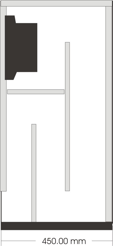

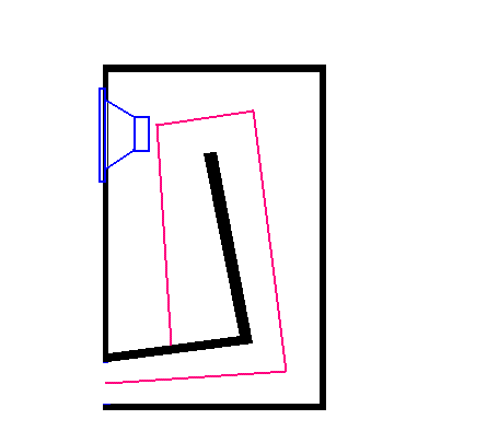

Here's my take, I like to keep the line simple, the taper is created by narrowing the depth of each turn. You can scale the height to get the right length & the depth to get the right cross-sectional area.
Not sure how to get the driver positioned at the 1/5th mark.
Andrew.
Andrew.
Ap said:Not sure how to get the driver positioned at the 1/5th mark.
Mount it on what is currently the back of the box. That will get it close.
dave
Greets!
Measure the internal long side path-length, ditto the short inside one, then L = SQRT(long*short), zdriver = L*0.2, so wherever this length terminates along the centerline of the pipe from the closed end is the centerline of the driver cutout.
GM

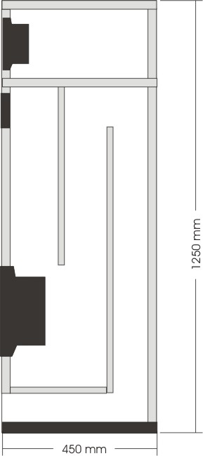

Ok, heres another design, this is 3 way with mid mounted above tweeter (due to height), however If you use a dome mid you can do without the top chamber & mount it below tweeter.
Having the woofer low to the floor helps reduce the floor reflection & also having the exit at the floor will give it some boundary re-inforcement.
I'm guessing line length at about 2.8m which is 30hz. (1/4 wave)
Andrew.
