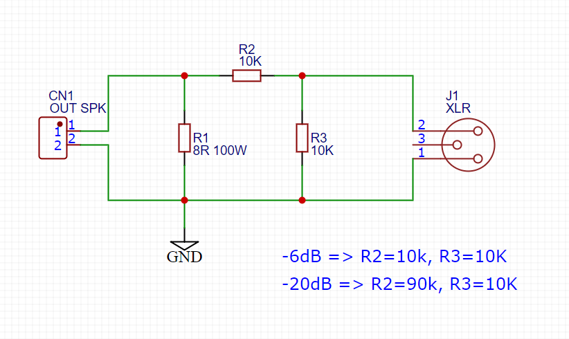

As an aside, I am using a sound card for analysis, it needs an attenuator to avoid overloading it. I found this diagram for a simple circuit:

However, I found that I need to dramatically increase R2 to 180k (from 9.1k for a claimed 20db reduction) to get a decent attenuation around 23db (550mv down to 3mv). Can someone post the calculation for the DB attenuation for a given R2 resistance?

You also have to take into account the load you have on the attenuator. The values given are for open circuit loading.
It appears you have somewhere around 1k of actual loading. Check the specs of the sound card.
Hi, it's the same as the earlier DIY article I linked to, the only differences being the change in R2 to 180k, and use of a .25" phone plug instead of xlr (goes into the same jack). https://www.diyaudio.com/community/attachments/mes_setup-png.1129894/
So for 23dB attenuation ( with R2 in k ohms) you need:
-23dB = 20 x log ( 10//60 / (R2 + 10//60) )
10^(-23/20) = (10//60) / (R2 + (10//60) )
0.0708 = 8.57 / ( R2 + 8.57 )
R2 + 8.57 = 8.57 / 0.0708
R2 + 8.57 = 121
R2 = ( 121 - 8.57 ) = 112.5k
If the math is right, the difference is probably in the measurement of the 3mV.

I have built my attenuator using the 180k ohm resistor mentioned above.
Voltage drop (using a 100hz tone to drive the amp) shows 21.4vac (rms) output on the amp drops to .114vac with the attenuator.
Using the formula RV = 20*log(V2 / V1), I get a 45.5db reduction.
I have always thought +10db = 10x the wattage (or +3db = 2x watts), but this calculation doubles that: 10db=20x. Most amplifier meters also show +10db = +10x watts.
What am I missing? Something to do with peak to peak measurement?
