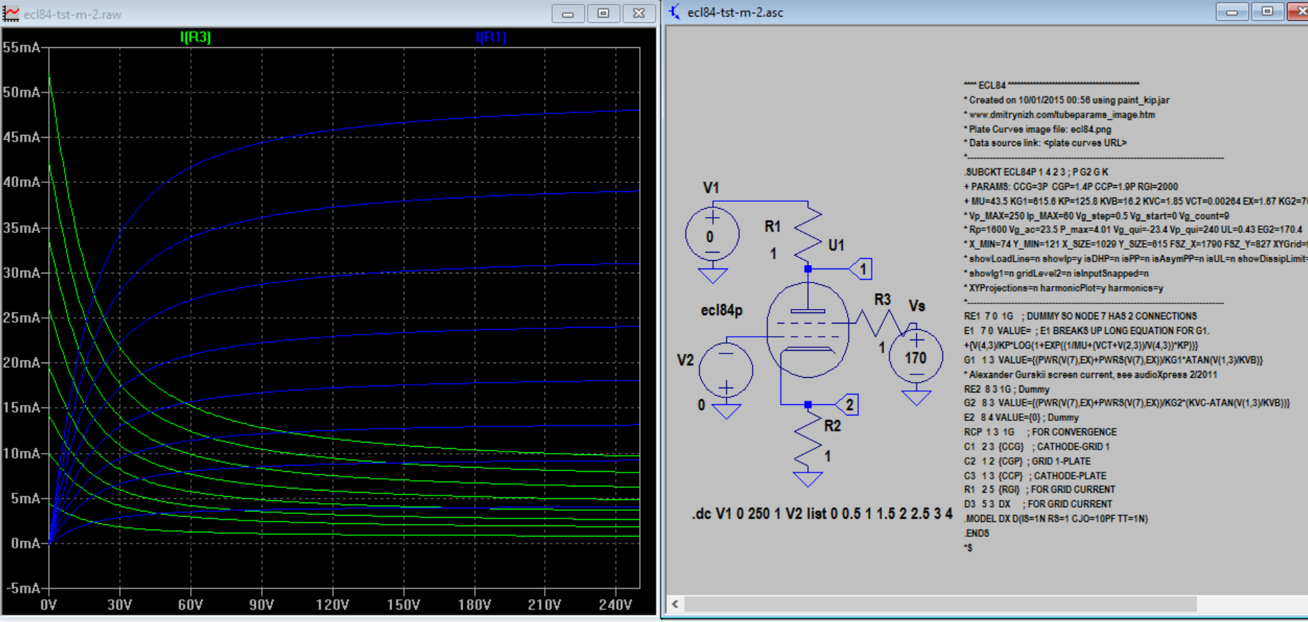

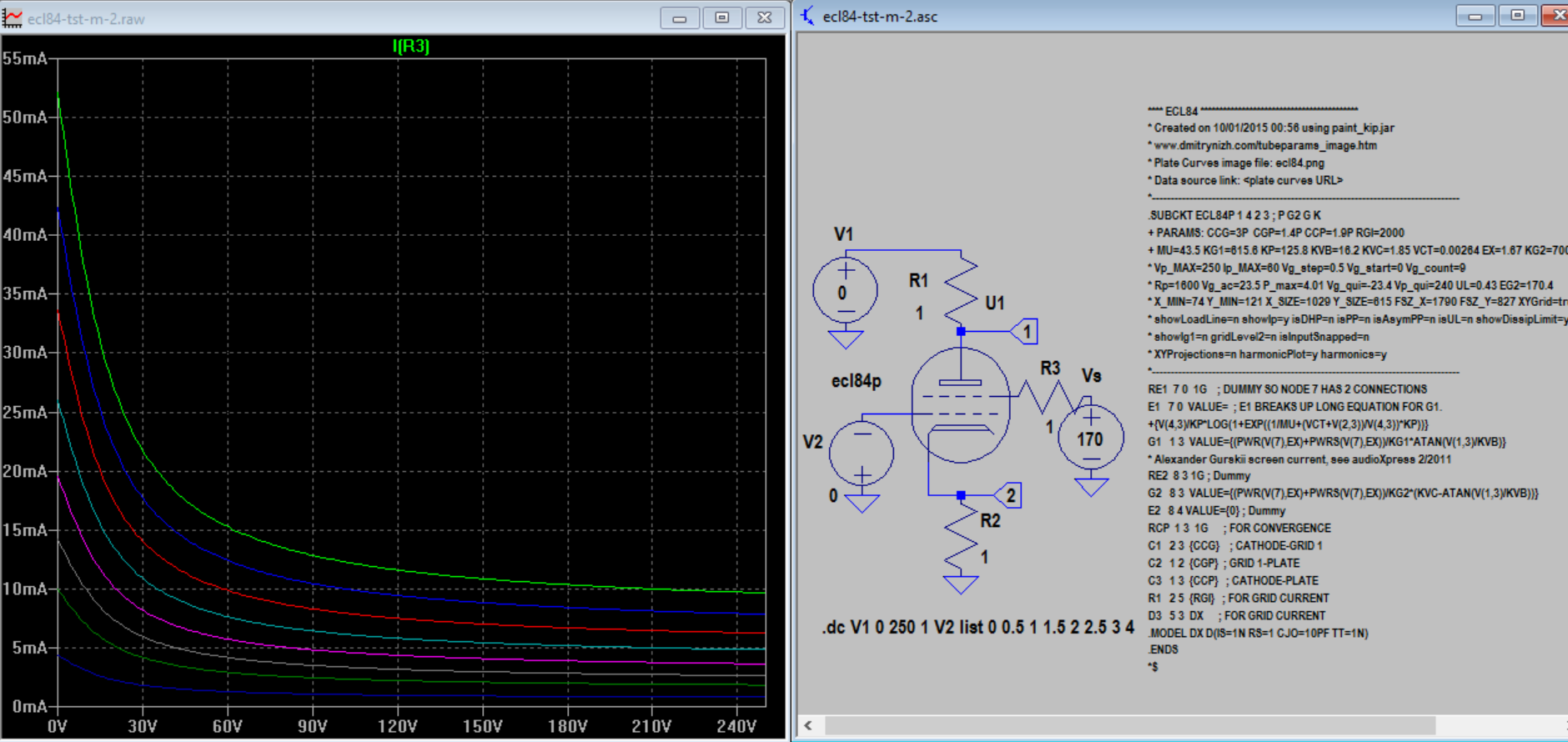

No, I'm unable to confirm it, according to my test sim putting 2 side by side, a change of KG2 does not make any difference to either model. It could be the improvement of Koren's model is more accurate as you can see formula for E1 & G1 is quite different.
Oh not the formula, I replace the original Koren's model data with the data I captured, the plot is the same!, it has something to do with original data, try to replace yourself, see below:
SUBCKT ECL84P 1 2 3 4
*X1 1 2 3 4 PENTODE1 MU=43.66 EX=1.350 KG1=344.3 KG2=4500 KP=201.06 KVB=26.0 VCT=0.00 RGI=2000 CCG=6.7p CPG1=0.6p CCP=4.1p ;
X1 1 2 3 4 PENTODE1 MU=43.5 KG1=615.6 KP=125.8 KVB=16.2 KVC=1.57 VCT=0.00264 EX=1.67 KG2=4500 RGI=2000 CCG=6.7p CPG1=0.6p CCP=4.1p ;
.ENDS

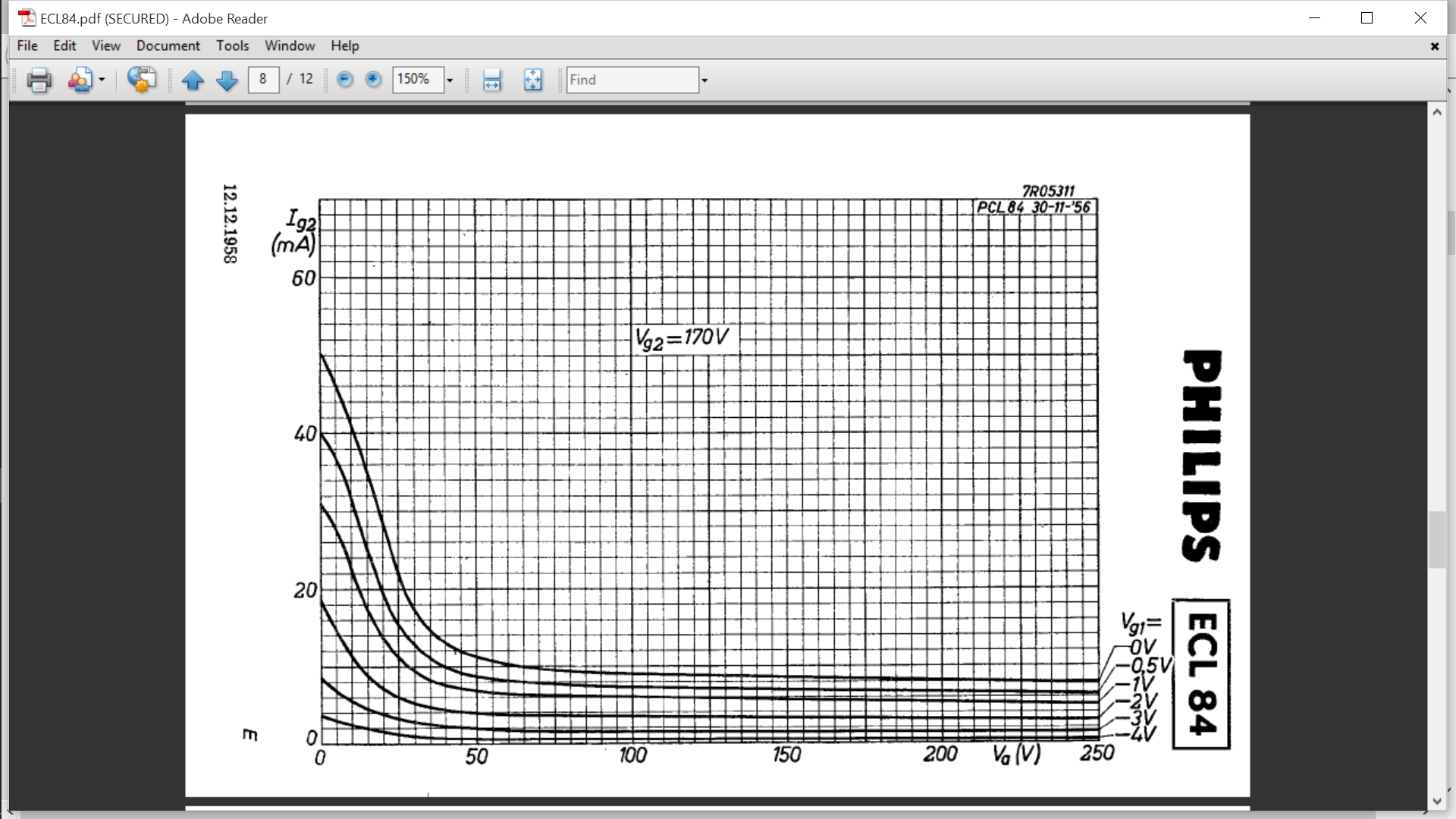

Ok sorry about the confusion over KG2, which indeed has effect on screen current (i overlook earlier). Now I change KG2 to 700 and KVC to 1.85 to get screen current (170V) close to original data sheet. However there is no corresponding on the other model (only KVB and KG2, with the formula on I am unable to obtain the accurate screen current plot.
