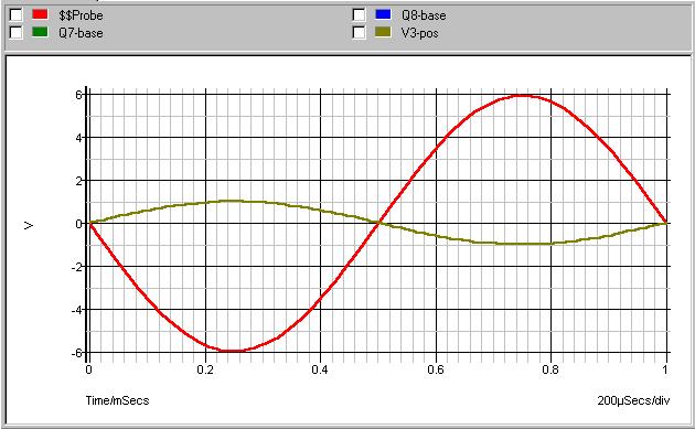

Thanks for your help. The sims seem to work well and I have a much better understanding of both the differential pair and that specific type of gain stage.

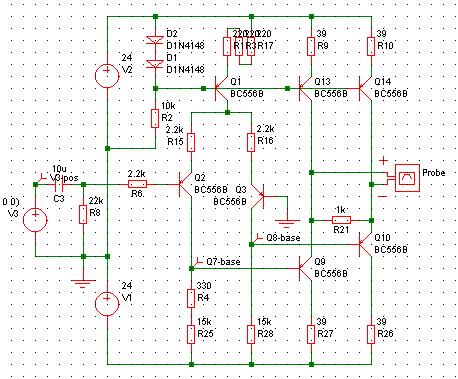

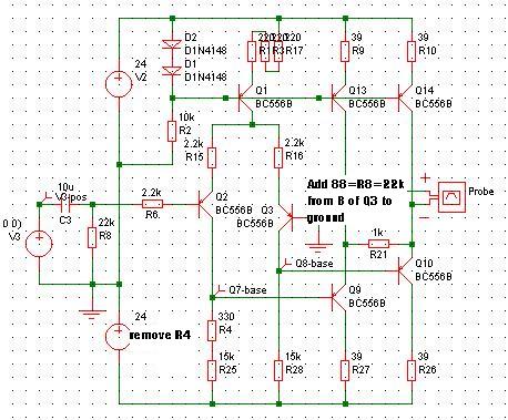

I gave your suggestion a go and it works quite well. I'll post the schematic/results for you.

what you essentially have here is a "differential Zen" Q9/Q10 (with the load on the emitter rather than drain / collector in the Nelson design), driven by a "balanced-> unbalanced" converter / preamp (the input differential stage, Q2/Q3).
Yes, it should work.
