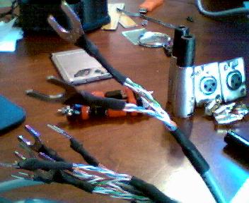

CAT-5 Sounds harsh To M Ear.
Nicely made effort, but ime Cat-5 sounds harsh.
To my ear not quite enough copper and hard sounding insulation and sheath - try 10 or 20 pair.

Star-Quad Cat5 Speaker Cable
Plain Cat5 is good but you will get better results if you first untwist all the pairs and retwist them in a star-quad configuration. First, compared to twisted pairs, a star-quad has a lower inductance and better noise immunity. Second, each of the pairs in a Cat5 cable has a different twist pitch. This is done intentionally to reduce cross talk between the independent data channels that are normally carried by each pair. When used as speaker cable, each pair is caring the same electrical signal and summing the signal after it has traversed multiple different paths, each with a different length and LCR, results in an audible smearing. I found the difference between ordinary Cat5 and star-quad Cat5 rather dramatic, i.e., not subtle. The star-quad is more coherent with better resolution and clarity.
To verify that the smearing I heard was due to the different path lengths and not just to the different geometry, I constructed a star-quad cable that preserved the different lengths of the wires as they came from the Cat5 cable. Quads made from the longer pairs of wires were twisted tighter. Then, one quad of each color was twisted together to make the final cable. This multi-length star-quad cable exhibited a similar audible smearing.
