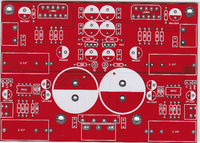

Hello, everyone,
This also my first post and, as luck would have it, I am also about to start putting together a chip amp using two LM3886. I am just beginning to get my feet wet in this field. Therefore, I bought a PCB on ebay, all the way from China. The PCB has everything on it: preamp (NE5532), PSU, and power amp. The circuit is somewhat different than the NS “typical application”. Instead of the parallel 10R+0.7uH in series with the output, it has 10R+ 100n (in series) installed in parallel with the output. Frankly, I don’t know what difference does it make and how good the circuit is, but I will build and test it. I will also post here the results of my experience.
I have all parts, except for the heatsink, which brings me to the question for the more experienced contributors of this forum: Has anyone experimented with a CPU heatsink (including the fan)? This is right now my option at hand, and I would greatly appreciate any comments on the issue. Thanks in advance.

Hi aandre2200,
My gainclone is using two realy small graphics card cpu heatsinks that i got for a bargain.
i ported out one of my PS transformers' secondaries and regulated it to 12v with an lm317.
This run the amp super cool, it did introduce a little hum which only if the volume is a high without music you can hear if your ear is close to the speaker.
The fans also make noise themselves, so its ok if you are not sitting next to the amp.
