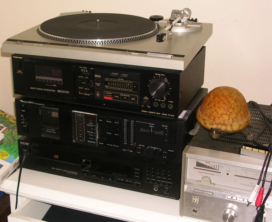

Maybe it's because of where it's placed? It's on a stack of 3 tape decks.

Even without cartridge there is hum pickup. If I unplug my cassette decks, there's less humming. If I unplug the TT there's practically no more of it. (Even if the transformer is off when the TT is off)
I think that it's because there are AC wires going under the platter(One for the auto-return and one for the speed light)
I think that good cables could help too!
If I still hear hum I think I'll have to go for a balanced pre.

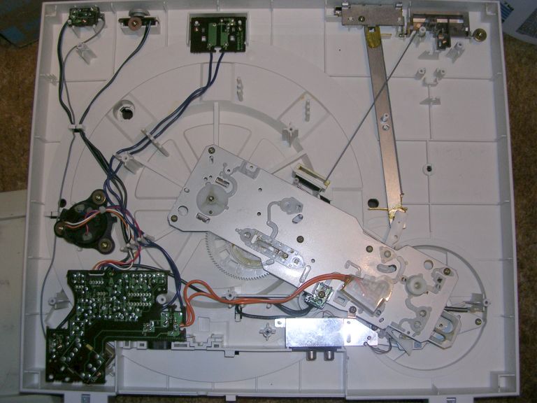

Are you able to post pictures here? A photo of the wiring under your TT could help to find potential problems.

I'll make a pic of the wiring maybe in a few minutes. I have to wait for that cheesy Styx album to finish.

The wiring layout looks pretty good at a glance.
You say the noise is worst when you have other equipment plugged into your amp?
Try isolating the turntable by only connecting the TT, amp and speakers...nothing else.
If there is still significant hum/noise, first see if the RCA jacks on the turntable share a common ground (screens connected together on the back of the RCA socket). If this is the problem, then you'll have to modify only ONE lead of the RCA pair by disconnecting the screen from one end only. This eliminates the gnd loop.
If that's not the problem, then look at the solder side of the PCB in the turntable. Check for 'dry joints' where the solder is cracked or damaged PCB tracks. You can go over all the joints quickly with a soldering iron to re make the joints if your not sure.
On the component side of the PCB look to see if all the capacitors look OK. I might suspect a bad electrolytic if the circuit has been unused for some time. A multimeter might help detect open circuits or shorts.

Bought 100$ while I could have got one for 15$. I rebuilt two motors and the other one would need to be rebuilt too.
No, when they are plugged in the power bar. The transformers make EMI that the TT picks up. With and without a cart.You say the noise is worst when you have other equipment plugged into your amp?
One thing is that when I unplug it from the 120v, the hum reduces a lot. The only thing that happens when I do this is that one of the wires going to the switch(In the auto-return mechanics) stops receiving current. The fact that the mains wire is near make it pickup some hum. I think it's more related to the cheap RCA leads than anything else in this case.
A question I didn't answer : Yes, there is a separate ground lead.
One thing I might try would be to relocate the transformer in an external case.
Note that I didn't show the bottom cover but it's also made of plastic.
I'll try with the ground loops, even if it seems AC related only.
