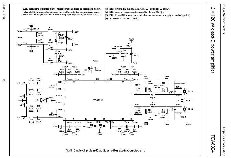

I have attached a 240w class-D schematic from a new philips chip TDS8924. This is attractive for a DIY subwoofer as it has a very low parts count (simple design), high power, acceptable performance, needs a small heatsink & small power supply. Only trouble is it is not available to purchase yet as the chip is new.
