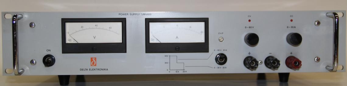

Or take a look at delta elektronika psu, I got the sm6020, which means 60 volt 20 amps, very low noise even when pushed, I'm still looking for a second psu so that I can series connect the two, on the back theres pins for remote operation.
Yes they are old, but build to last forever.
Ps. The never models have lcd.
