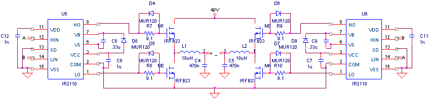

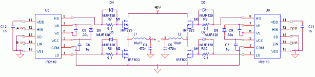

Ok, what about using a MAX4295, a full bridge, filterless, 2W, Class D amp to do all my PWM. I have 2 eval boards here and they work wonderfully so far. I am listening to them on full range speakers and they do well. Anyway, that would give me the signals I need to run a half bridge driver, or a pair of them for full bridge - like below.
A and B would be the two outputs.

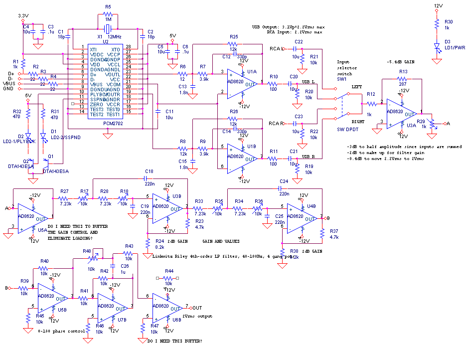

Here is the input section I have developed. I am contemplating a different phase shift section that uses 2 op amps, this one is from Randy Slone's Audiophile Projects book.
There are a couple notes on the schematic if anyone is interested in helping answer them. Feel free to make any other suggestions. The gain will need to be changed if I am to run the MAX4295.
The LR-4 filter values are all incorrect. They are right for a 2nd order, which I copied when I doubled the filter order.

I have worked with an amp using the HIP4080A and it was rather noisy. I repaired another amp with the HIP4080A and it used a C to ground on each gate - apparently to slow down rise times and eliminate noise? Or perhaps that was the dead time? It was a Kicker DX700 car amplifier. Those experiences sold me on a pair of IR2110 half bridge drivers.
I have the bridge drivers ordered, and hopefully everything will prototype well. I am concerned that the MAX4295 dead time will not fit my application. However, since the MAX is an IC I imagine dead time would be low, and I can increase it externally. So hopefully everything will work out 🙂
