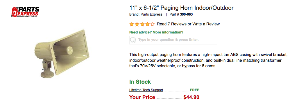

The cheap 87 dB sensitivity Goldwood is likely no louder than your Seas 10".
If you want loud and cheap, and made for outdoors, look at paging horns like the one listed below. With just 1 watt at one meter it does around 110 dB, the Goldwood 15" would need 200 watts to reach that level.
Your "volume control all the way up" may not be driving whatever your using to power the Seas to full power.
I'll look into it. Just what I need to blast off.

I think you better fast forward to Eminence Alpha 15A, Eminence ASD 1001, and one of the horns in the 11 bucks zone. I don't think Goldwood would have sufficed. You can sell these anytime for good money if you execute the design skillfully, I figure so.
For outdoor use, +1 on Art's suggestion of a paging horn.
