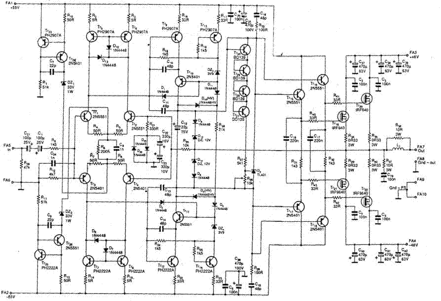

Revisit first thread
I have spent much time and effort on the Goldmund schematic as it appears in the other thread and make the following conclusions. If some have other views please feel free to comment. These are my views only.
The opening thread states as follows:
This thread is to discuss improvements in performance, stability, and reliability.
Among the issues which were brought up:
1: The circuit can be unstable:- This is speculation. Any circuit can be made unstable and there is nothing to suggest that the Goldmund is less stable than any other amp provided it is loaded as specified.
2: Output stage bias has no clear adjustment:- Replace the bias resistor with a trim pot of 1K and bias is adjustable.
3: The topology can be improved:- I think a number of alternative schematics were offered, whether these would be perceived to sound better or worse is debatable.
4: The front end CCS is strange, it is hard to know what it was designed for. A more conventional CCS will be less confusing and more flexible."]Regardless if it is strange or confusing, it obviously works. If anyone is uncomfortable with Goldmund's CCS then replace it with any of those discussed earlier in the thread. Whether this impacts on the perceived sound is hard to tell by just looking at a simulation.
5: Front end rails may have sub-optimal power supply: - They incorporate a separate source with capacitance multiplier, nothing sub-optimal about that.
6: Transistors used don't have adequate voltage specs for the rails: - As far as I can see all the transistors are adequately rated in the application that they are used. Unless for some catastrophic condition all the semiconductors will operate properly.
Several options have been offered to enhance the amplifier using similar topologies. Some have suggested other topologies as well. Kean, it is your thread so concoct one from all the replies that you feel is the best and then make a project of it.

Nico Ras:
In response to just two of your comments...
1. The circuit itself may be okay, but the PRINTED CIRCUIT board proposed in the other thread is an unknown... IMHO it aint what I would build, with or with out a ground plane.
2. I would never ever build that amp with the output transistors of that rating, due to the complex loads it will be subjected to AND the unknowness of the PCB used to build it on.

Krisf, If you look at my amp virtually identical topology, it is a slight over design, four devices per rail and 65V max, rated 200 watt, why? I felt this would be okay, more reliable but not infaluable.
Goldmund uses three devices, 80V, why? They must have made a commercial decision that the number of failures that they will encounter under warranty would not eat into their margins and that they can afford it judging to the selling price.
Maybe Kean should consider adding more devices, those who want to can fit more, those comfortable with less can do so. I would like to add anyone who plays music continuously at 300 watts has rocks in his head.

Hi Nico,
Regarding stability of the Goldmund I have tested several samples, granted from a few years ago and all showed signs of instability into a capacitive load. I have compared them to the Thresholds, Levinson and Audio Research units of the same time period, none of which exhibited this behavior. Most people don't realize that the amp can be helped by attaching another Zobel at the speaker end which usually improves it's sound considerably.

Hi Jam, it seems too simple but place a 47 pF capacitor across the feedback resistor, it is then stable, but you forfeit some volts in slew rate. Toss a coin, what is more important to perceived sound; infinite slew or infinite stability - I would like the coin to land on its side. But if it was my call adequate slew rate high stability.
The problem with the designer is probably that he was hooked on slew rate being the highest regard to sound quality, like some of us are hooked on THD or phase or what not.

For me I would want to make it stable enough to remove the output inductor, while at the same time maximising/maitaining the bandwidth.
Once that has been achieved build a better power supply.
Then work on a good pcb layout.
Essentially that is all that needs to be done.

Where to now oh Great One?
Attached are the mods to satisfy your requirements.
The circuit mods incorporates a feed back cap in parallel with the 10K NFB resistor. Unfortunately you cannot bandwidth limit and have high slew rate, they are related.
Slew rate is still >40V/uS and I think this is adequate for 300K bandwidth. Phase change over the bandwidth is very acceptable. 1.5 deg at 10 kHz and 17 deg at 100kHz, better than most amps around.
I have added the bias adjustment pot.
The feedback NFB cap brings 0 dB gain to within the phase inversion thus it will now be more stable for 20 uF in series with 2 ohm loads much worse than several parallel connected electrostatic speakers.
Distortion was improved a little by shorting the ac path between the input Diff amp legs. Thus degeneration does not worsen the THD but remains dc stable.
I really think that Nagy's got the power supply wrong, so I adjusted the driver PSU for 80V and output at 65V, makes more sense and there is not much difference between the Goldmund original output voltage swing with the modified one one.
I am not sure why they used a reverse biased transistor in the CCS, but it seems to work for a wide temperature range and I left it alone.
The zeners and diodes are removed they have no purpose because these lateral Mosfets already has them built into the die.
