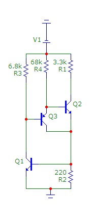

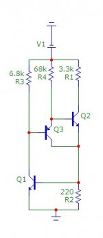

here is a high performance CCS you may want to consider. I used in RAS240. It may have the characteristics you are looking for.

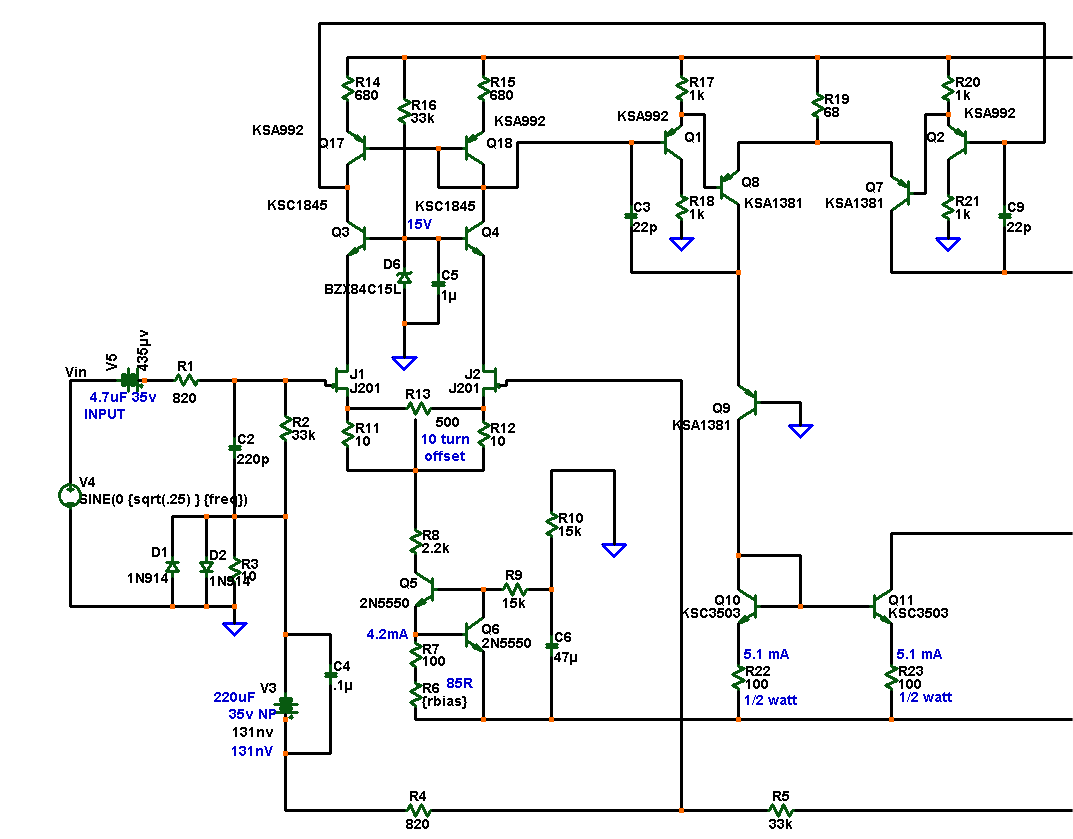

RAS ELD has been my Goldmund for more than 1 year but is now a commercial amp with a few changes. It does sound pretty handsome and it contains almost everything that has been mentioned in these threads. The commercial equipment contains a regulator on each channel as well as a few other refinements which I cannot show here, but what I show is a complete working machine in every-day use.
Some may not call it musical for what that statement means, but it is like water, it has no taste, no color, no flavor, no smell and, it gives what is inputted, no more no less. Some my prefer flavored drinks others fizzy drinks, etc, this amp does not do that, it is completely vanilla.
Maybe you could use some of the ideas from it. I have not been a fet input fan, I stick to BJTs, of course one change is front end that now uses 2SC2240 and 2SA970. I will post some sims below, not that they are of much use in practice, but gives an indication.

Ah, the negative-impedance CCS... Homemodder showed me this before...
Did you know there is a way to tweak it for maximum output impedance?
Unfortunately, it is a super-powerful feedback loop, and instability might be an issue.

I said I had some sneaky mods. Kindly have a look at MAT03 from analog devices and use this in a cascode. You may change your mind.

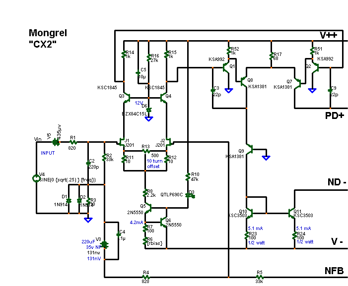

MAT01 (npn) maybe , mine is "flipped around" from your ELD (BELOW-mostly N channel) , I will add your decoupling to my CCS. I have to use what I have a lot of (100 ea. 2sc3503 , 2sa1381, 2sc1845,2sa992) That mat is REAL low noise but I would have to cascode at 33v to just barely make my derating (45v for the mat /40 for the JFET = 75v rails). I really do get noiseless operation with the 1845/992's plus 120v Vceo - $.08USD apiece , buy a hundred and match them. 😀
My ha ha "CX" "goldmund killer"( below) ($11.00 a channel 😎 less total than a single MAT01 )
OS

Hi Nico, thanks for posting this. Is it possible to make double sided boards at home or do I need to get them professionally done? I would like to scale this to +/- 80V. Would changeing the Zeners and making sure cap ratings are fine be all I need to do?
Shouldn't the C5 filter cap by referenced to ground? This same error was in another schematic you posted here.
Also, try using NPN's for Q1 and Q2. Fed by a 100k resistor to ground. NPN's will have higher gain and hopefully be faster, and also have better loading than the 1k resistors. Or perhaps you've already tried this?
- keantoken
- keantoken

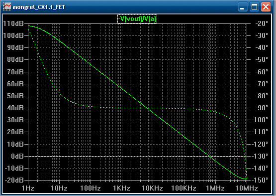

I did try that , as well as "flipping around" the circuit like in the ELD (nico's) , added nico's decoupling to ccs , added a CM to the "mix"... 'cool beans' ... even lower distortion. LG shot up to 100db+ at Low frequency. Sort of just what my goals were. I did change that zener bypass 😱😱 .

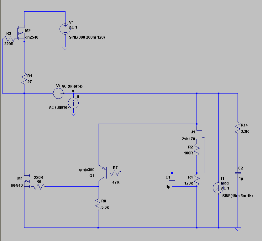

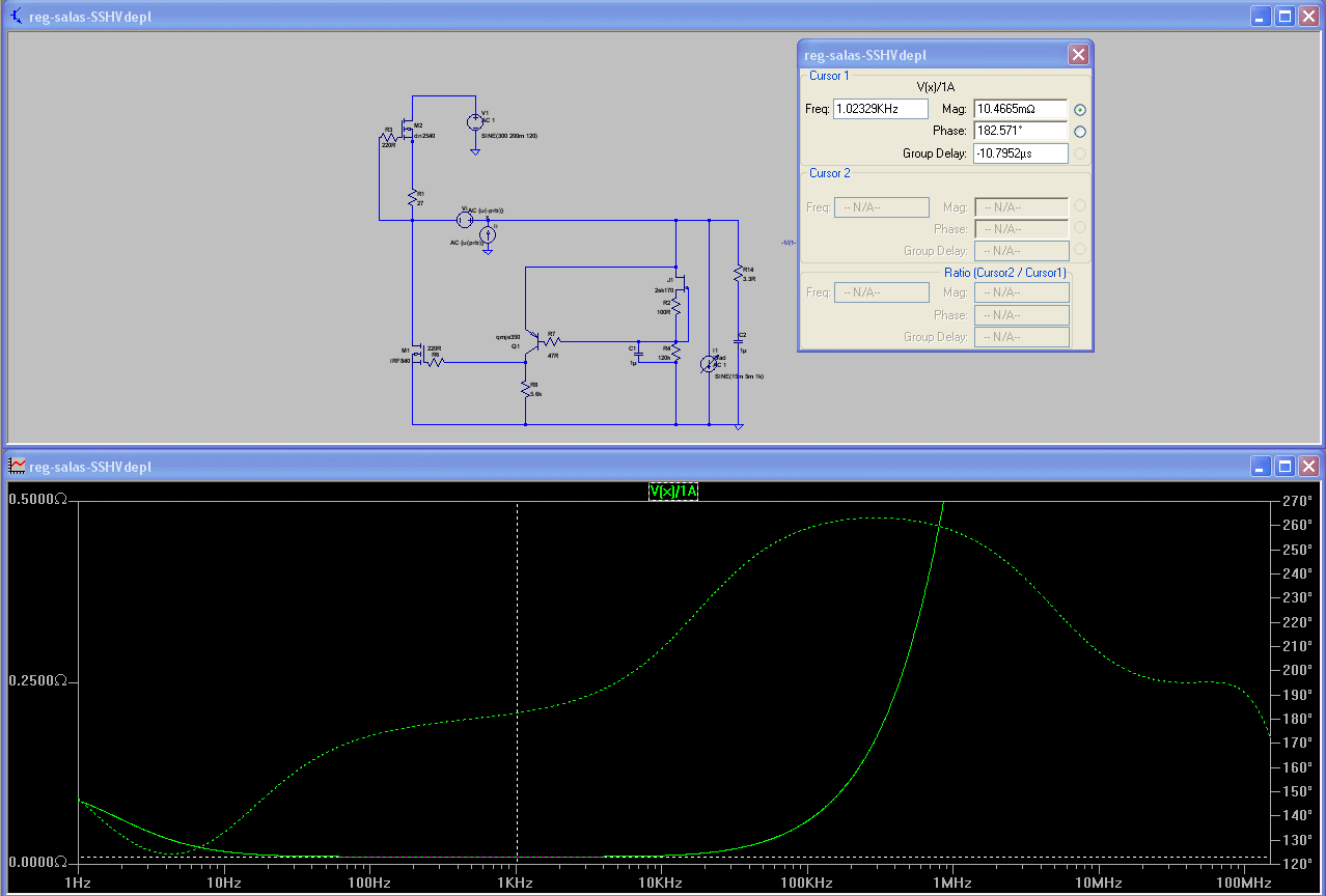

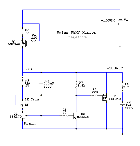

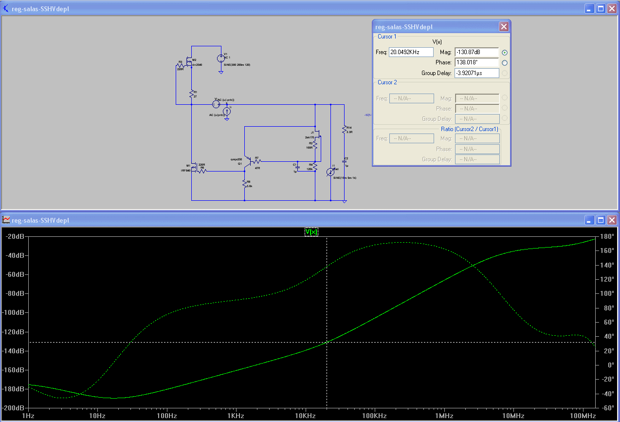

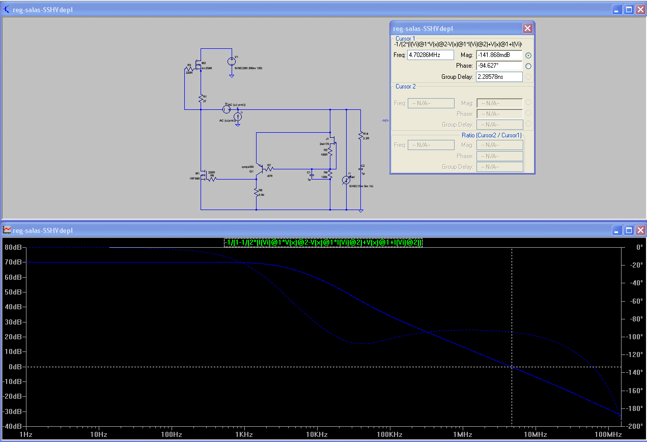

Guys the simplest I can give you, is my SSHV with err... simplified CCS. Its been used from DHT preamps to phones amps by I don't know how many. It has very few components indeed. Keen maybe you can sim up the negative too in LT, since it comes from another simulator with not comparable features? Best thing is, look ma! No electrolytics! The Norton Vref is very silent for such an output level and adj. too. Sub a low ppm res after trim.
I enclose an LT Spice Analysis of the positive and a mirror example for negative, including the proper values for circa 100V out operation that should be migrated to the positive one too. Just put something in the rails, will help much, be it a good C mult. a shunt stabilizer (watch out the Vref element's physics & noise), or a shunt reg. This one needs 20mA left residual for 10mOhm Zo, hence my example is for circa 40mA total. Can go lower if running more, but the depletion has certain Idss limits too. Assuming you need 20mA for each rail, each IRF840 will dissipate 2W for 100V, and the depletion only Vin-Vout times 0.04A. 10V-20V drop is royal to keep it stable.
