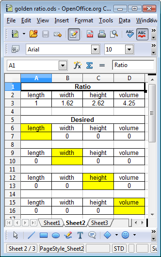

Wasn't sure where to post this spreadsheet tool for calculating golden ratio and volume.
View attachment golden ratio.zip
Enter value in yellow field and it calculates white fields.
The image looks good. The Zip didn't keep the package togther thou (so is a useless mess). You should save out as a pre-xml Excel file so that it is more compatiable
Excel sucks as a spreadsheet (a good example of how world dominance stifles innovation). It should be possible to put it on 1 visible line (but would likely require some temporary cells elsewhere)

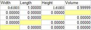

Formulas I used are a little different.. Columns B-E, Rows 3-6
B3 [=E3^(1/3)/D2], C3 [=E3^(1/3)], D3 [=E3^(1/3)*D2], E3 [Blank-Enter Volume]
B4 [=D4/D2/D2], C4 [=D4/D2], D4 [Blank-Enter Height], E4 [=B4*C4*D4]
B5 [=C5/D2], C5 [Blank-Enter Length], D5 [=C5*D2], E5 [=B5*C5*D5]
B6 [Blank-Enter Width], C6 [=B6*D2], D6 [=C6*D2], E6 [=B6*C6*D6]
