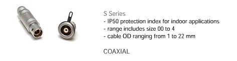

I’ve mounted several thousand BNC’s and never encountered this problem. Anyway the 75 ohm BNC’s have no isolation around the female contact so adjusting is easy. What is sometimes a problem is that the centre pin of the male contact can turn in the isolation. After many connects/disconnects the centre conductor of the coax will break from the pin due to turning when the centre conductor is made of stranded wire. With a solid centre conductor this is not a problem.
If you are looking for a really good 75 ohm connector that withstands many connects and disconnects go for LEMO. Not cheap but also not that expensive (app. $15)
http://www.lemo.com/
Lemo
Hi Pjotr,
Yes I concur, The Lemo system is the non-plus-ultra in connector sytems. But not universal.........
Hi Pjotr,
