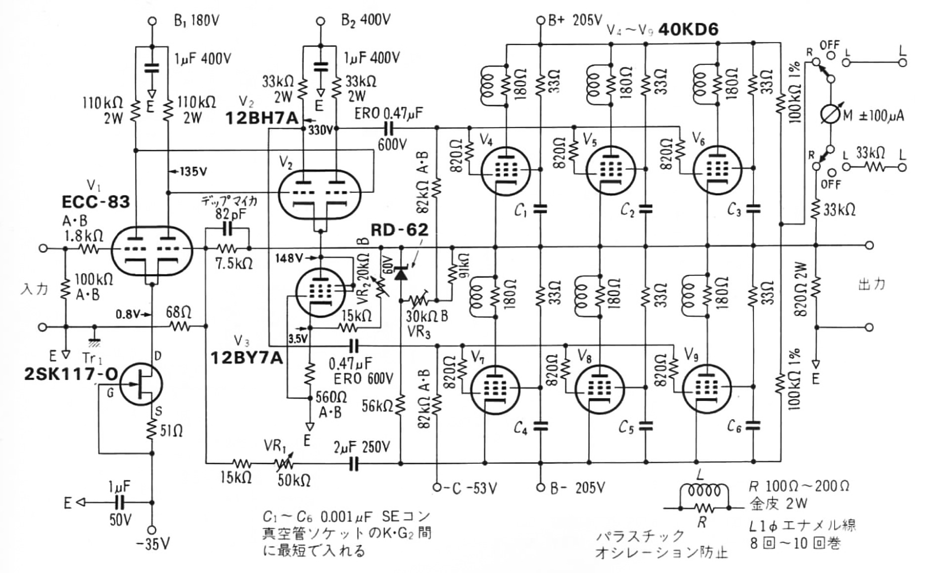

As always, Safety First!
Prevent the "Surviving Spouse Syndrome"
A general statement that filaments and cathodes should be tied together by a 'recommended' resistor (not just the 40KD6 tubes), depending on the circuit topology, can have both safety and performance implications.
A few Newbies might be confused, and might build either an Un-Safe circuit, or a Low Performance circuit, or both at the same time.
Please, tell me I am missing some important point . . .
If you start with a concertina phase splitter stage, and then tie the heater to the cathode with the recommended 10k or 20k Ohm resistor, the Concertina performance will be degraded.
It will be true, whether the filament is AC or DC powered, if the filaments share a common supply.
And, if you start with an LTP phase splitter, and then tie the heater to the cathode with the recommended 10k or 20k Ohm resistor, then that phase splitter performance will be degraded.
With a single AC or DC powered filament supply all the cathodes will be resistively tied together by the suggested filament to cathode resistances.
Floating Cathodes will no longer be floating, and many circuit topologies Require 'floating' cathodes that are not tied to another circuit by a 10k or 20k resistor.
Just my 2 pennies worth.
