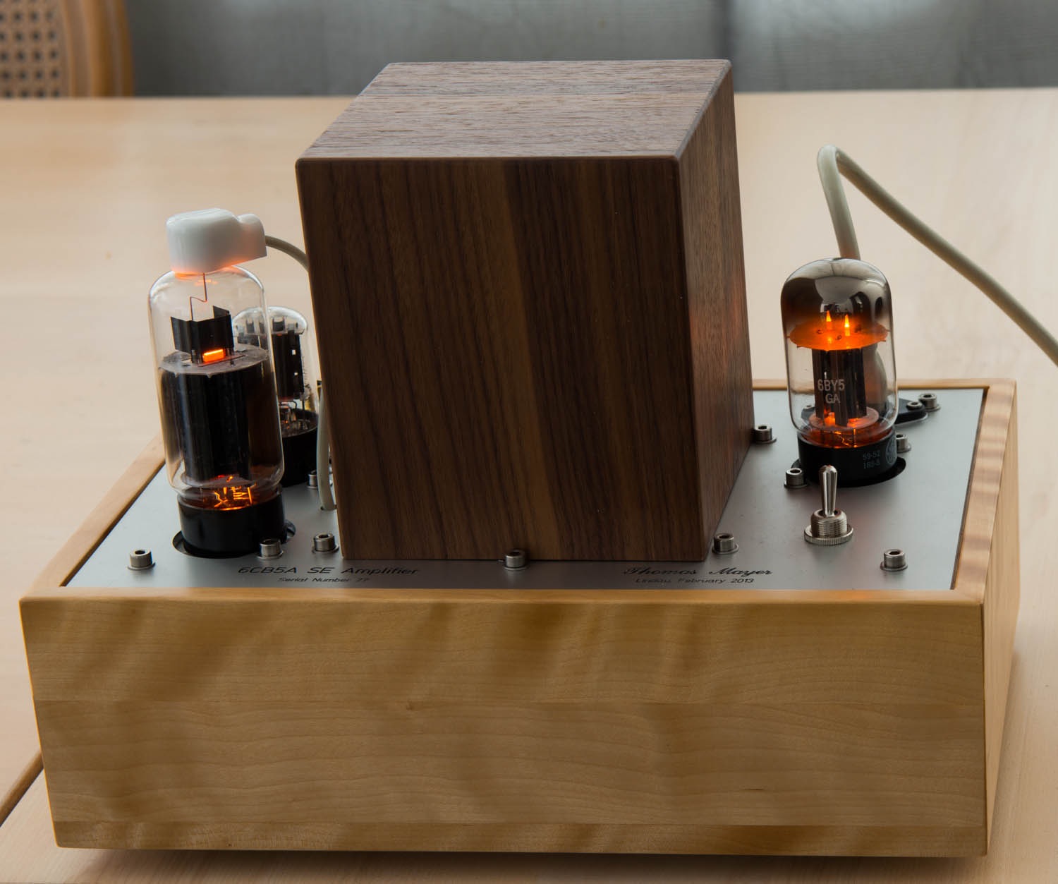

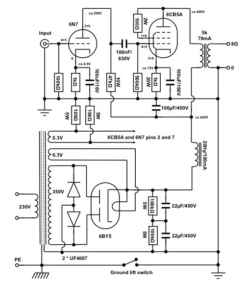

Yes please Diyers let's keep this thread about schematics sources with tubes 🙂
We can find some interesting ones and build guides on
VinylSavor: Low Cost Single Ended 6CB5A Amplifier - Part 1
some work was inspired by Sakuma San.
Best regards
