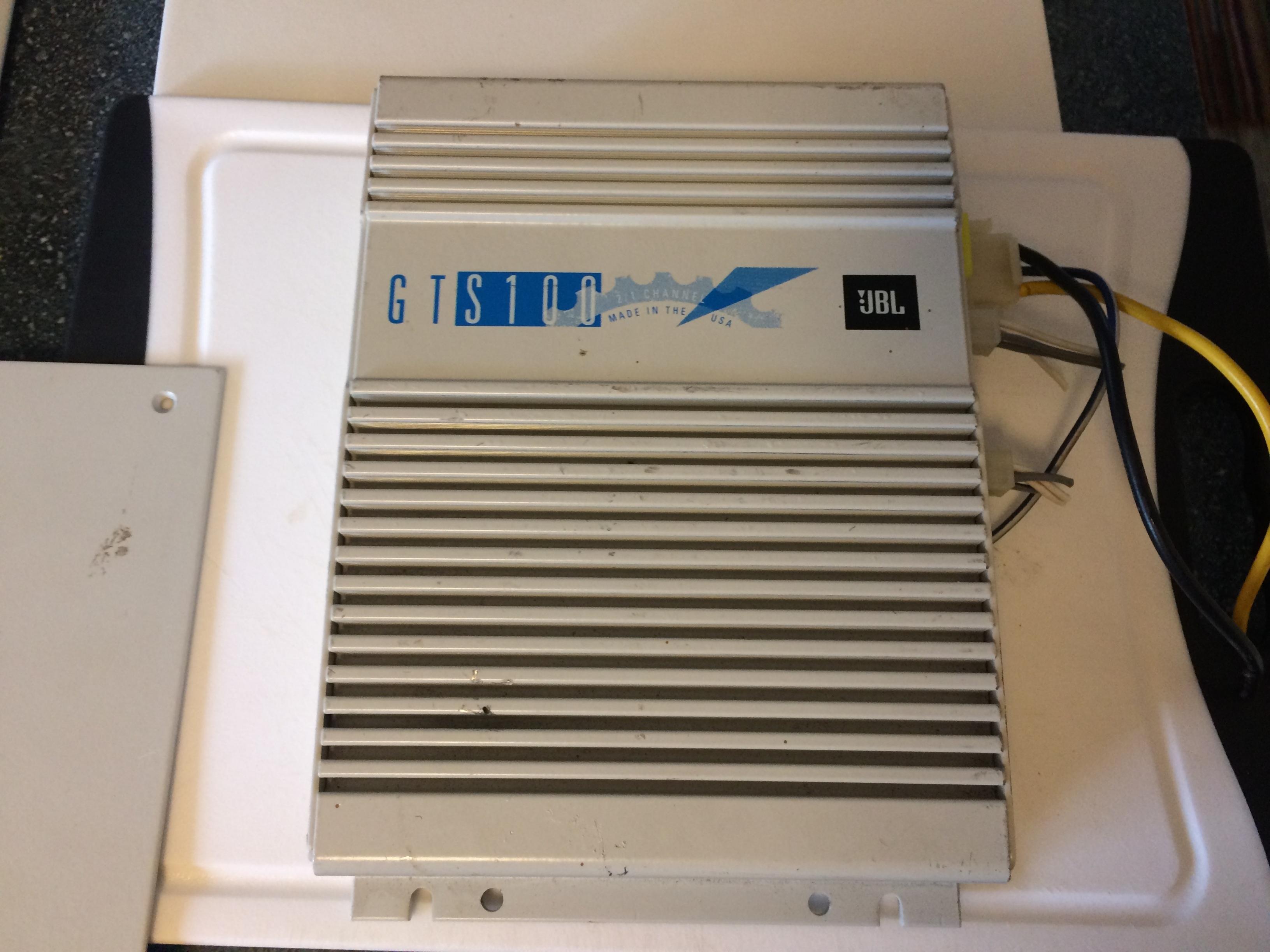

According to the previous owner this blows fuses. I was able to find the technical manual, so I have a ton of info.

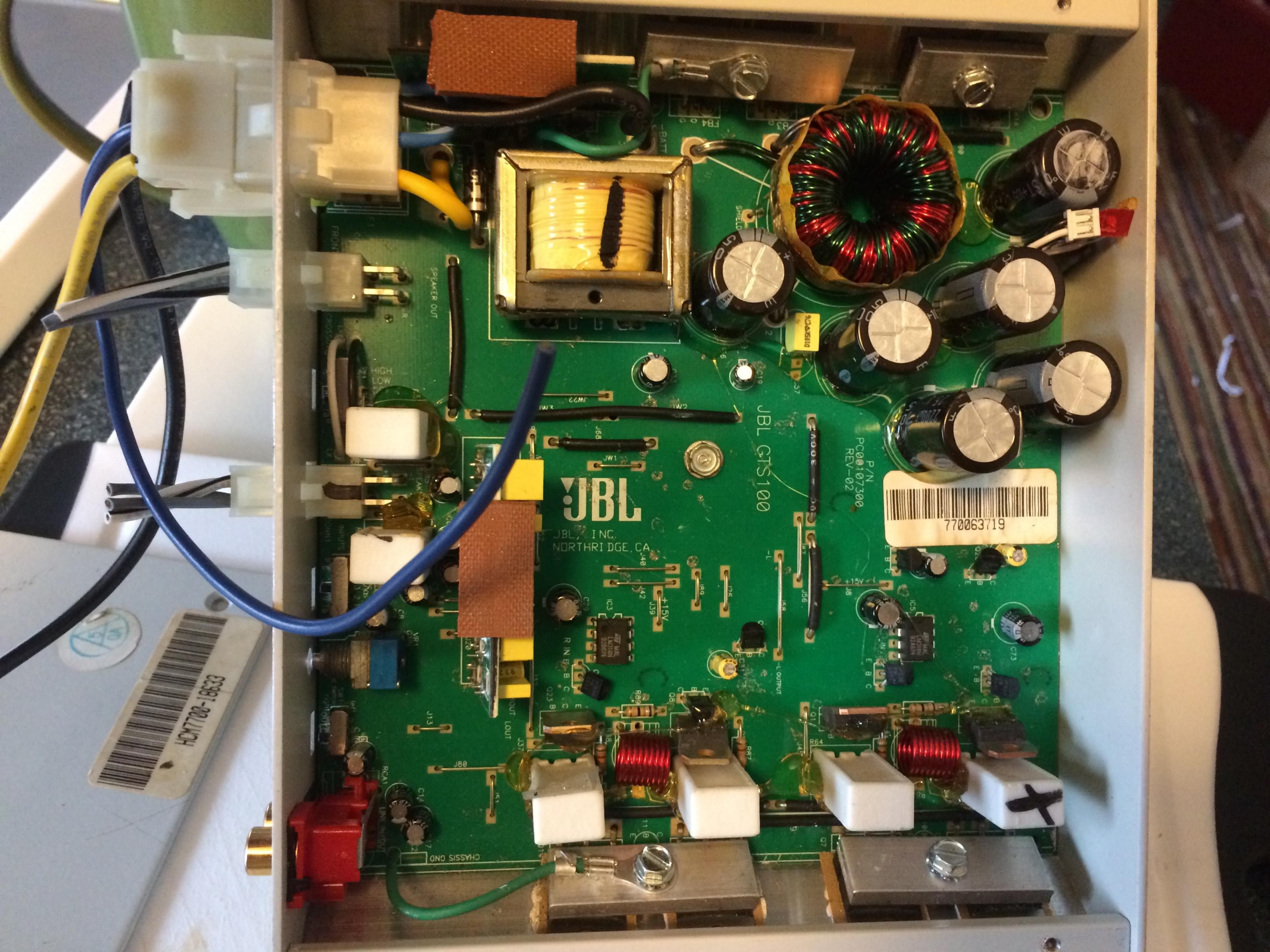

I saw one component that I wasn't sure about a 10k ntc thermistor, I measured it and got 3.5k at room temp. I'm including a pic.

If it's not powering up, there is little risk to the heatsink mounted components. It's going to be an issue if/when the amp is operating out of its heatsink.
The thermistor is connected to other components that could be making it read low in the board.
For this type of amp, the ground screws on the board aren't critical for the amp to function.

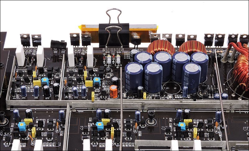

For a temporary heatsink, there's no need to get fancy. Aluminum bar or angle with office supply bider clips work well enough. The insulators have to be installed so the metal-backed components can't short to the heatsink. The binder clips also have to be clear of the metal parts of the semiconductors. The attached image shows bar stock (doesn't need to be that thick) with kapton tape as the insulator.

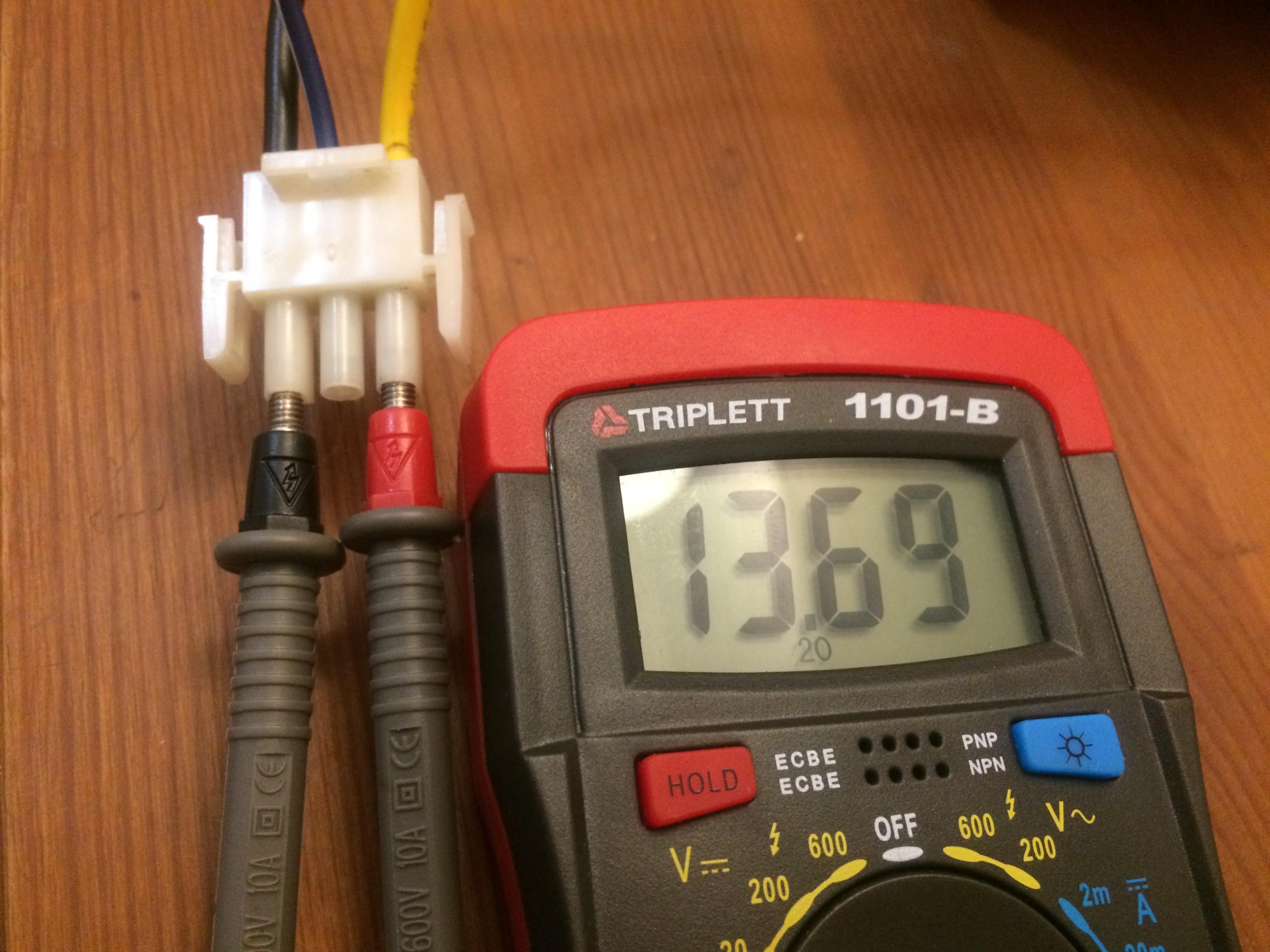

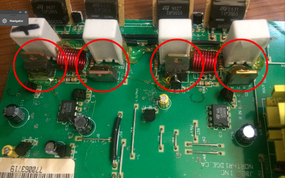

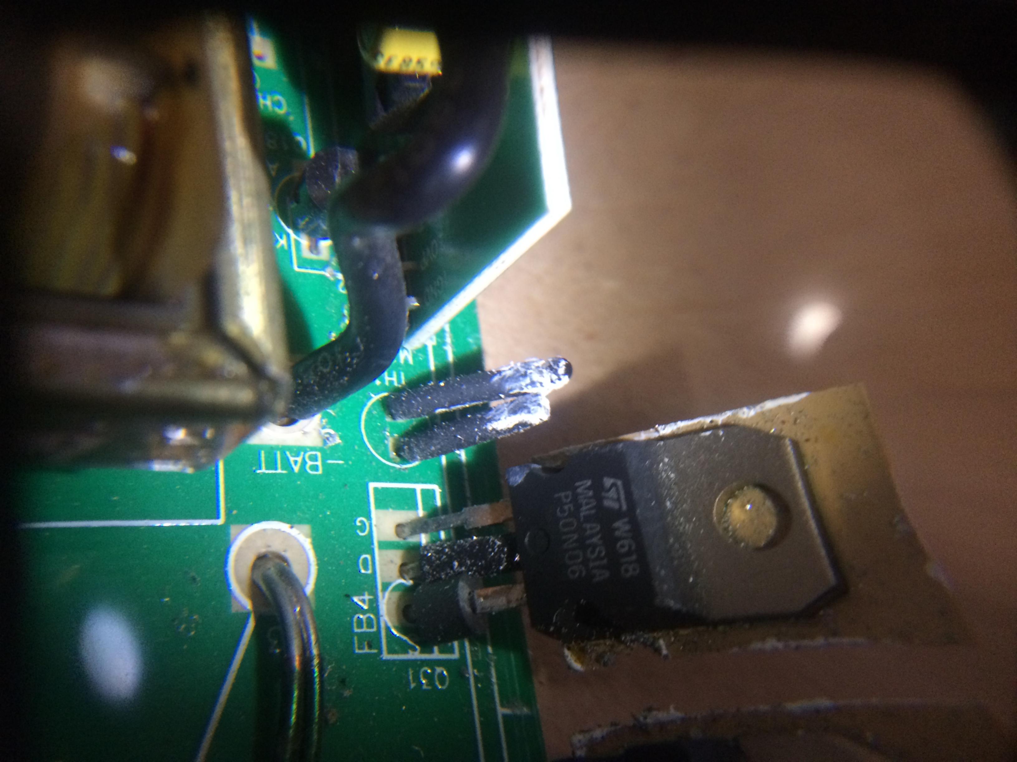

Here's a pic where I circled the components I just measured. The center leg on all 4 was 0 volts and the power wire going into the amp from my power supply reads .03 volts when its hooked up to the amp and the power supply is on. I checked the power supply when its not hooked up to this amp and it puts out 13 volts.
If you haven't done so, read the basic amp repair page in the sig line below.
Those are driver transistors, not the power supply transistors. The PS FETs are Q30 and Q31.
OK ill read the guide. Thanks for your help. And the center legs on q30 and q31 are .01v and 0v.

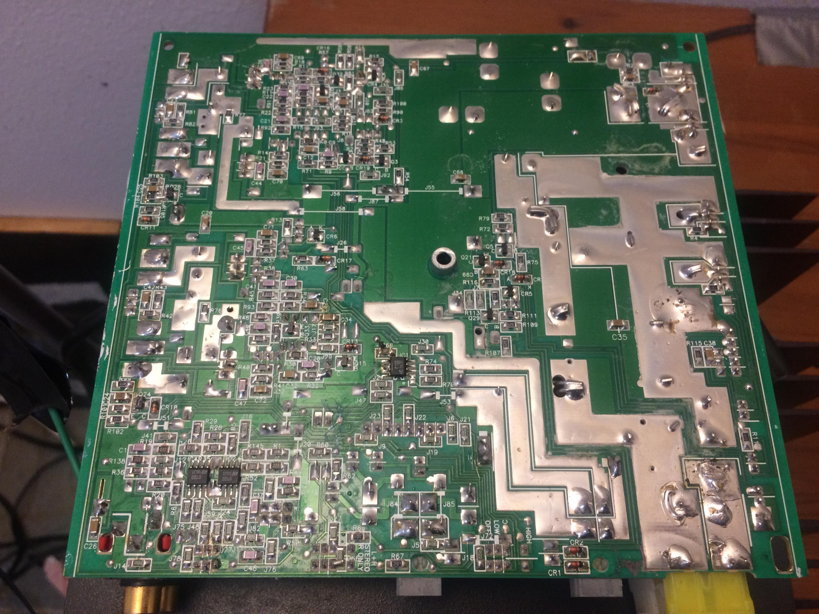

I can't see anything definitive. There may be some questionable solder connections.

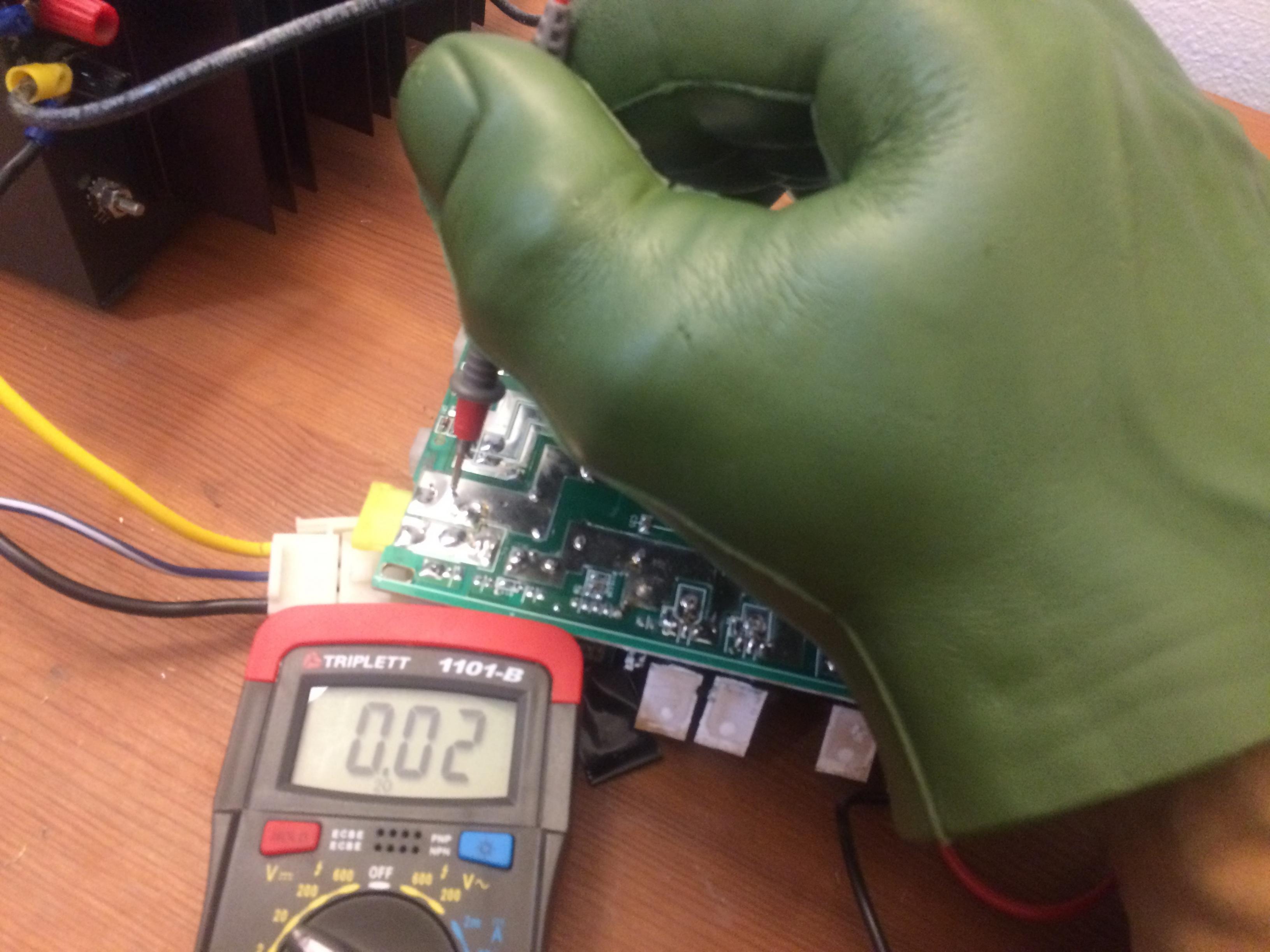

Here is a pic showing the wiring that came with the amp hooked to the power supply and another pic measuring one of the pads the fuse holder is soldered to. The other side of the fuse measures .02v. I can measure the wires where they go into to molex connector and get the same .03v and .02v readings.
L2 reads .01v L4 reads 0v

What's the resistance across B+ and ground on the amp? Maybe something is shorted and shutting the supply down.
