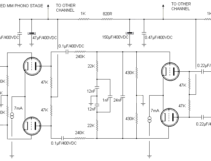

What you have in mind for the MC stage is a balanced hybrid stage, probably using a 2SK...something with a valve on top as a cascode.
I would parallel a couple of 6DJ8s or anything else low noise and linear with Vg=0 and high transconductance.
I could do the whole thing with 6DJ8s and the main reason for doing so is that I won't have to worry about availablity.
We could use fancy tubes such as the 3A/167 but noise would be an issue.
The 6Gk5 is a fine candidate for MM levels, not suited for MC though, IMO.
Nobody seems to be posting circuits so I'll stick my neck out...all valves are 6DJ8s.
Since I'm only human, there must be mistakes...

Hugh,

What I could get from the all tube MC-design was ~ 50db signal to noise with an average (medium output) MC-cartridge.
Since this is above the vinyl surface noise level I stopped to workout and have moved to transformers on both sides of the Phono Stage.
With these there is no need for a balanced circuit layout any more.
A different solution is what Allen Wright did with Fets in his RTP3C design and off concern in a tube topic.
- I would be curious about your ideas -
Klaus

I have no practical design, maybe Allens circuits are good from a technical viewpoint, I don´t like the sound, cristal clear but no emotion.
Wonder how the guys from BAT get a S/N of 78 dB with a single
6922 and 59 dB gain.
Had a look at Broskies circuit with grounded cathode and floating grids. Don´t know what to think about.
Reinhard
