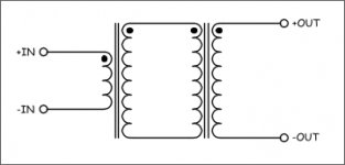

The BIG question. How best do we convert fully balanced to single ended output, without throwing away 6dB of voltage gain?
And if we continue with this topology in balanced mode, how much more voltage gain is required, and what tubes should we use?
I suspect we should have a reasonably low Zout at line level so we can separate preamp from amp and run long cables....

Re: Re: Transformers
Aren't you missing the protection diodes and the damping resistors? 😉 😀
Steve Eddy said:How 'bout this? 😀
According to what I read at Tubecad, there are a few possibilities.
Opamp, Anti-opamp, CF etc.
Either way, it seems the 6dB advantage would be lost by going balun, although JB doesn't seem to mention that explicitly.
I'm still in the process of digesting this though...so far it has always been the other way around; going from unbalanced to balanced.
To me at least, it seems the summing of the polarites is best done at the amps' input...or better still, go balanced up to the speaker output.
I admit, I've never dabbled with anything like it but it looks interesting enough to me.
Cheers,😉

grataku said:Aren't you missing the protection diodes and the damping resistors? 😉 😀

AKSA said:OK,
Nothing happening........
A couple lengths of wire and some thin sheets of MuMetal come to mind. Woof! Woof! 😀

Which is why you play it safe using xformers, right?
Cheers,😉
