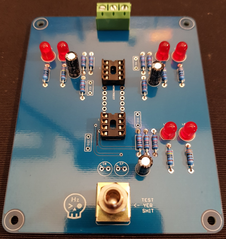

Hi all,
Can someone recommend a good circuit for testing if an op amp is still functional vs. dead? I've tried to search the forums, but the algorithm dislikes anything with less than 4 letters... 😛. Googling has shown me a few options, such as:
Dual Op Amp Tester Kit (#6783) | NightFire Electronics LLC
and
Tester for 555 Timer and 741 Op-amp ICs - RadioRadar
However, these won't work with all op amps. For example, the first one has issues with any op amp that isn't unity gain stable. I know that a simple go / no go is a fairly complex issue when it comes to op amps and there is a lot to take into account. Is there anything out there that could do the job without needing a scope and multimeter? Heck, even something Arduino based could be fun.
Thanks guys 🙂
The NightFire plan should work even with fussy opamps. The HF gain is near infinite, not unity; and the PFB will slam it around anyway.
It is "possible" a way-off-spec opamp could flash the lights yet behave badly in more critial work, This is the flaw in ALL "testers"-- they test what they test, not what you need in your specific case.
So I ended up building the NF one, and it works very well indeed. Gave me the info I needed 😀
