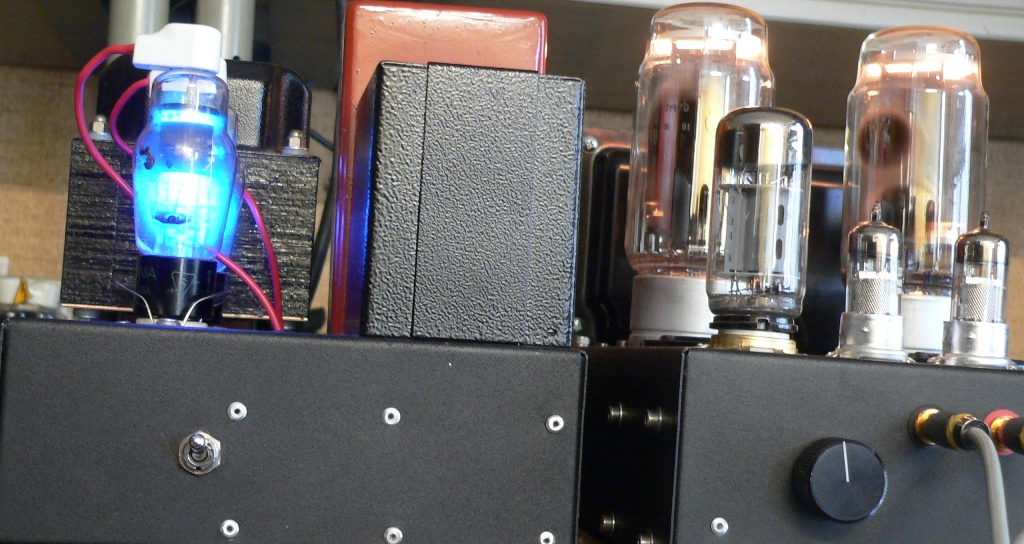

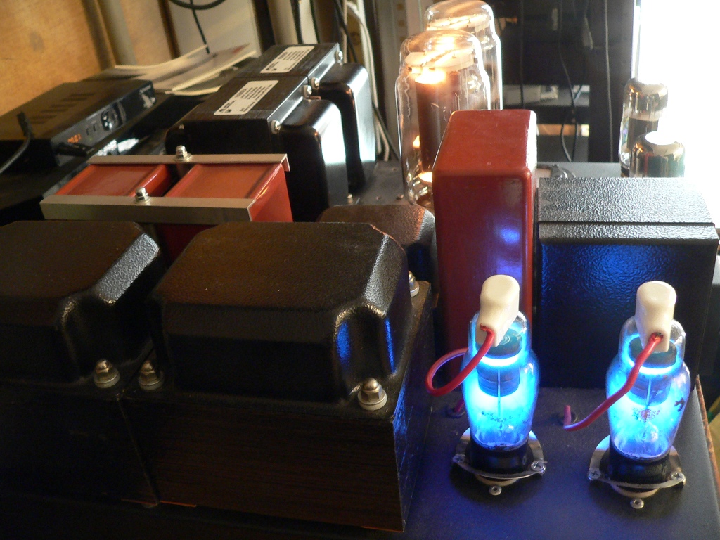

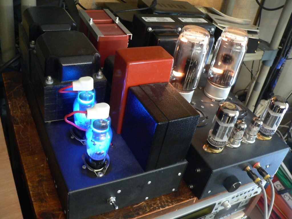

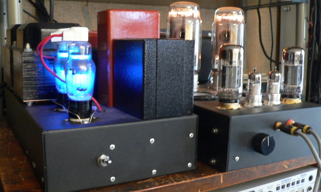

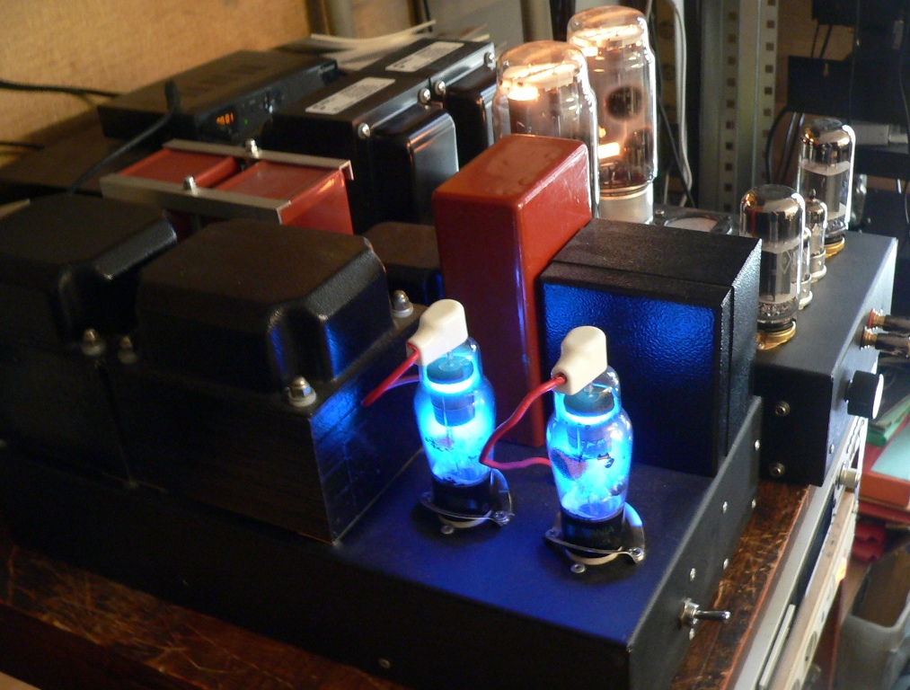

just back to my personal GM70 SET, change plate choke to cathode choke and
negative bias for 6L6 (6P3S-E) and GM70 and rectifier 816 MOV to replace 866A
much more color and beatyfull music
i do not need much power so preamplifier its an option for full power

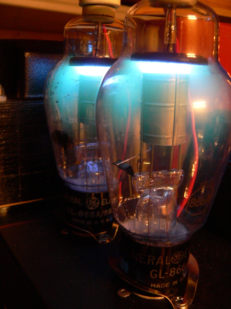

Those bluish glow from 866's are the best. Magnificent‼. Wonderfull job, guy‼. Enyoy.

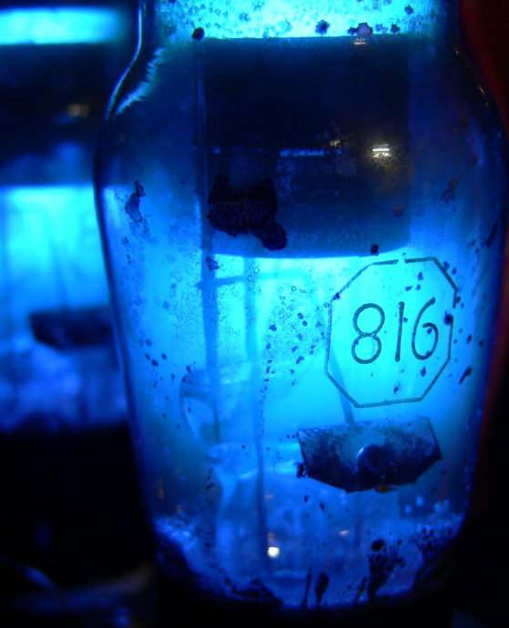

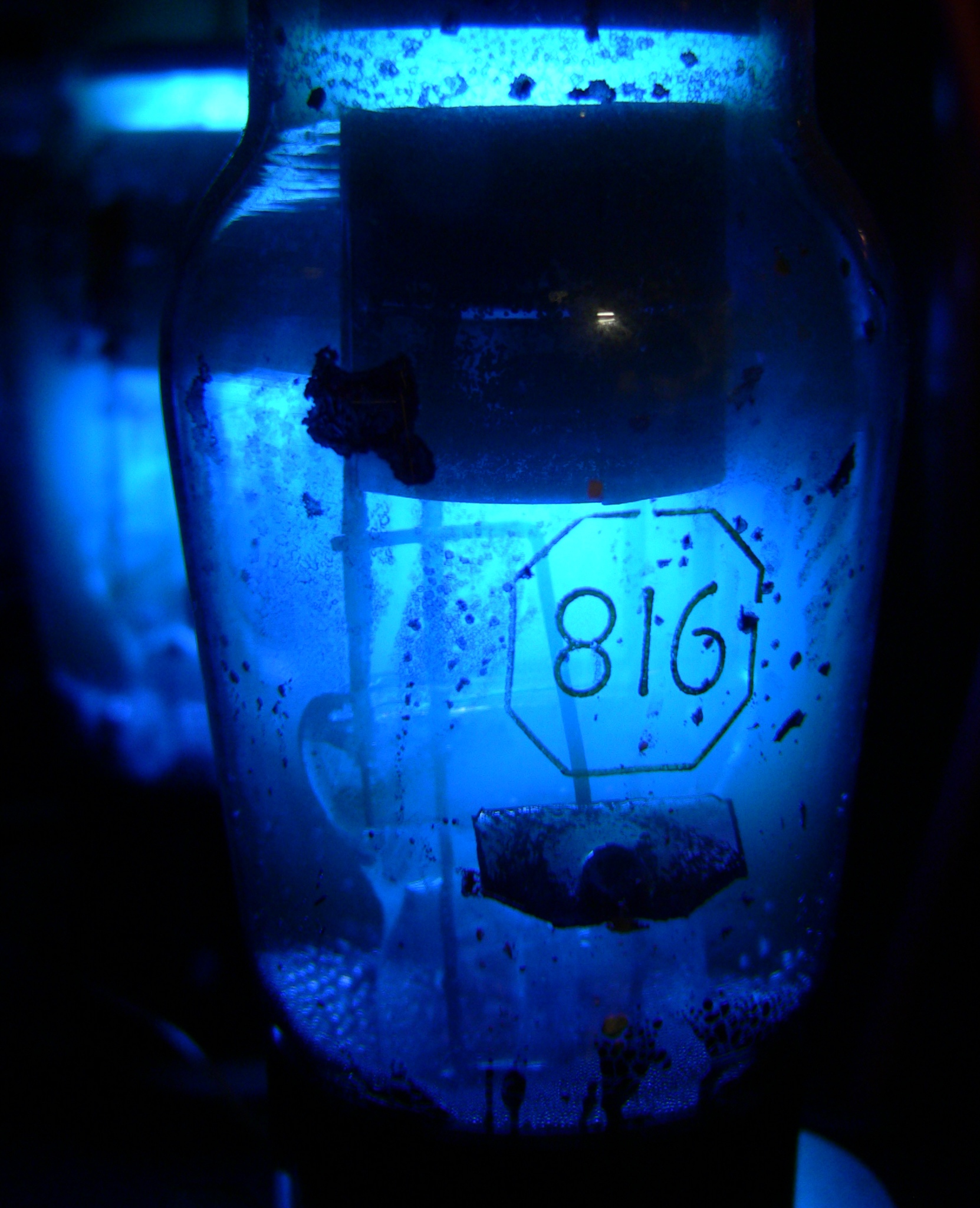

these are 816 its smaller but no problem psu 280mA 950V
OK, I believed that were 866 junior, as they are known here (Thinner than 866's).
Congratulations for your job.

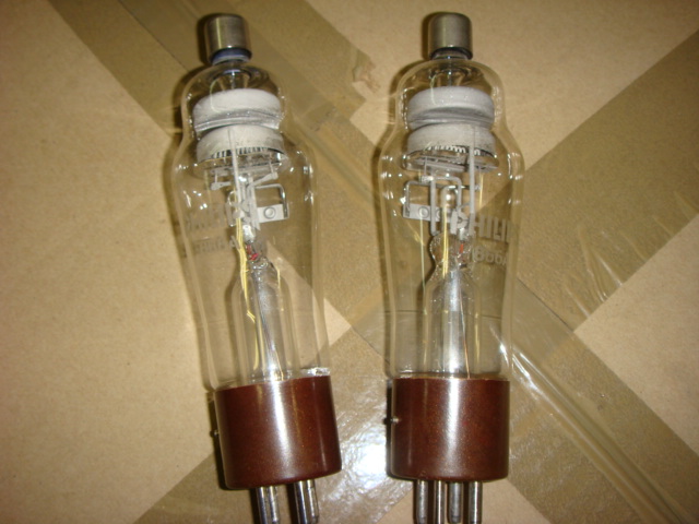

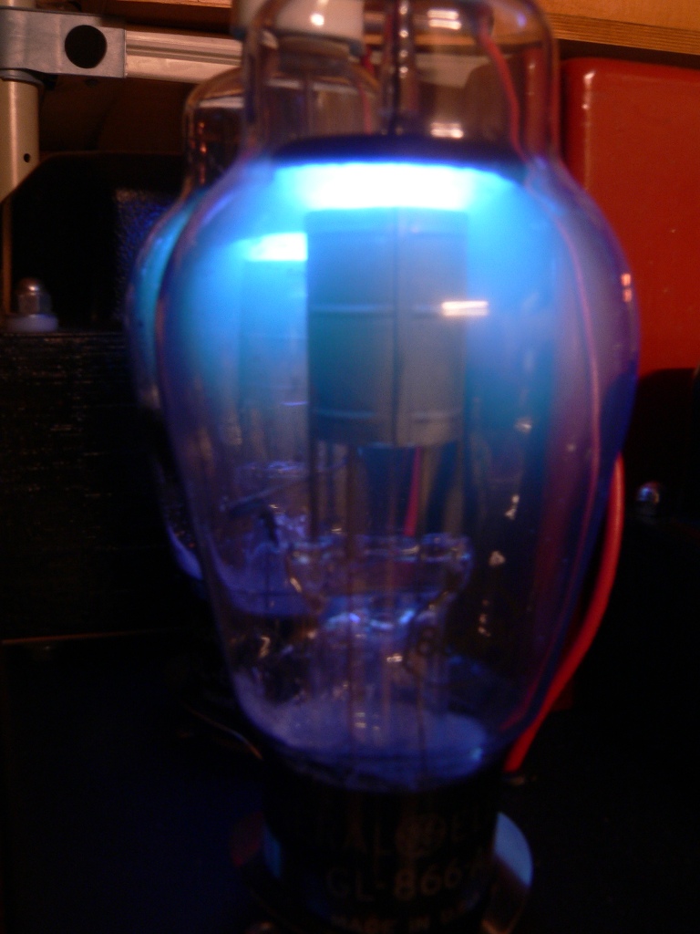

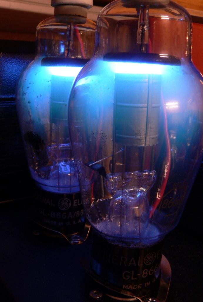

thanks Osvaldo, the RCA 866A sometime get old, GE866A also vacuum problem
i have new 866A nos philips very beatyfull
i sell the firs amp with mullard 866A still working

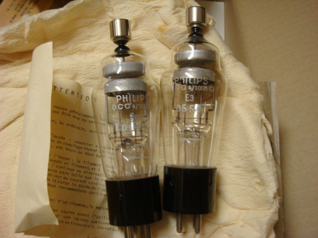

Do you guys have any idea of the lifespan of these rectifiers? I have the DCG4/1000 made by RTC and I run them in a C.T configuration at 110mA with a choke input filter. Startup delay is respected every time I turn on the amplifier.
several years ago, I had an 80/40/20 mts ham radio transmitter (AM, now prohibited) 2 807 * 2 1625's class AB2, that had 866's junior as the main rectifiers. I loved to use them as a kind of "VU meters", ja ja ja....

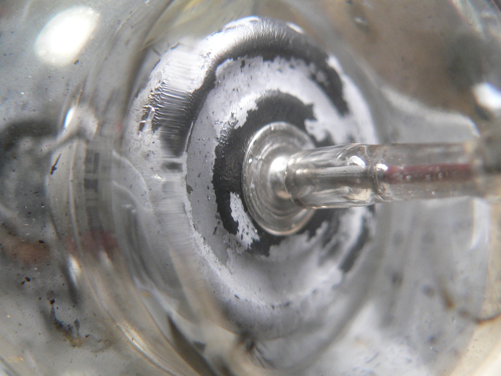

MOV should vaporize mercury before HT come on, also first time and each time they moove let tubes preheathing 20'Do you guys have any idea of the lifespan of these rectifiers? I have the DCG4/1000 made by RTC and I run them in a C.T configuration at 110mA with a choke input filter. Startup delay is respected every time I turn on the amplifier.
RCA problem see jpg
otherwise these are a the same time fragile and everlasting
the beatyfull glow demand minimum 0.2A HT better more and more
or small 816 glow easy
sorry for the bad english
