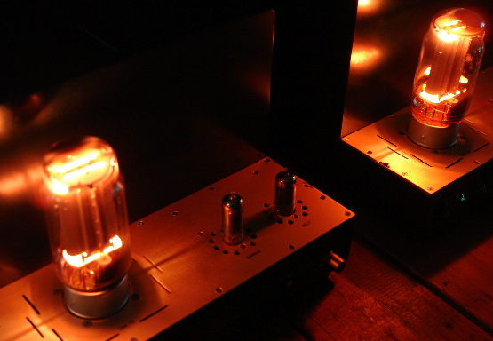

Actually two of my friends and I are working on a single ended integrated amplifier so we thought why not to write about it here in order to use group wisdom.
OPT and power transformers are made by a friend whos job is pretty good in building tube amplifiers:
he suggested to use 6n6/6H6 as input tube and two 6E5P Russian tubes do drive one GM70 but without any further details. here are PSU and amplifier schematic I got so far:
I'm not sure about using 6N6/6H6 and 6E5P. I may consider other tubes if I have access to. any idea is much appreciated.

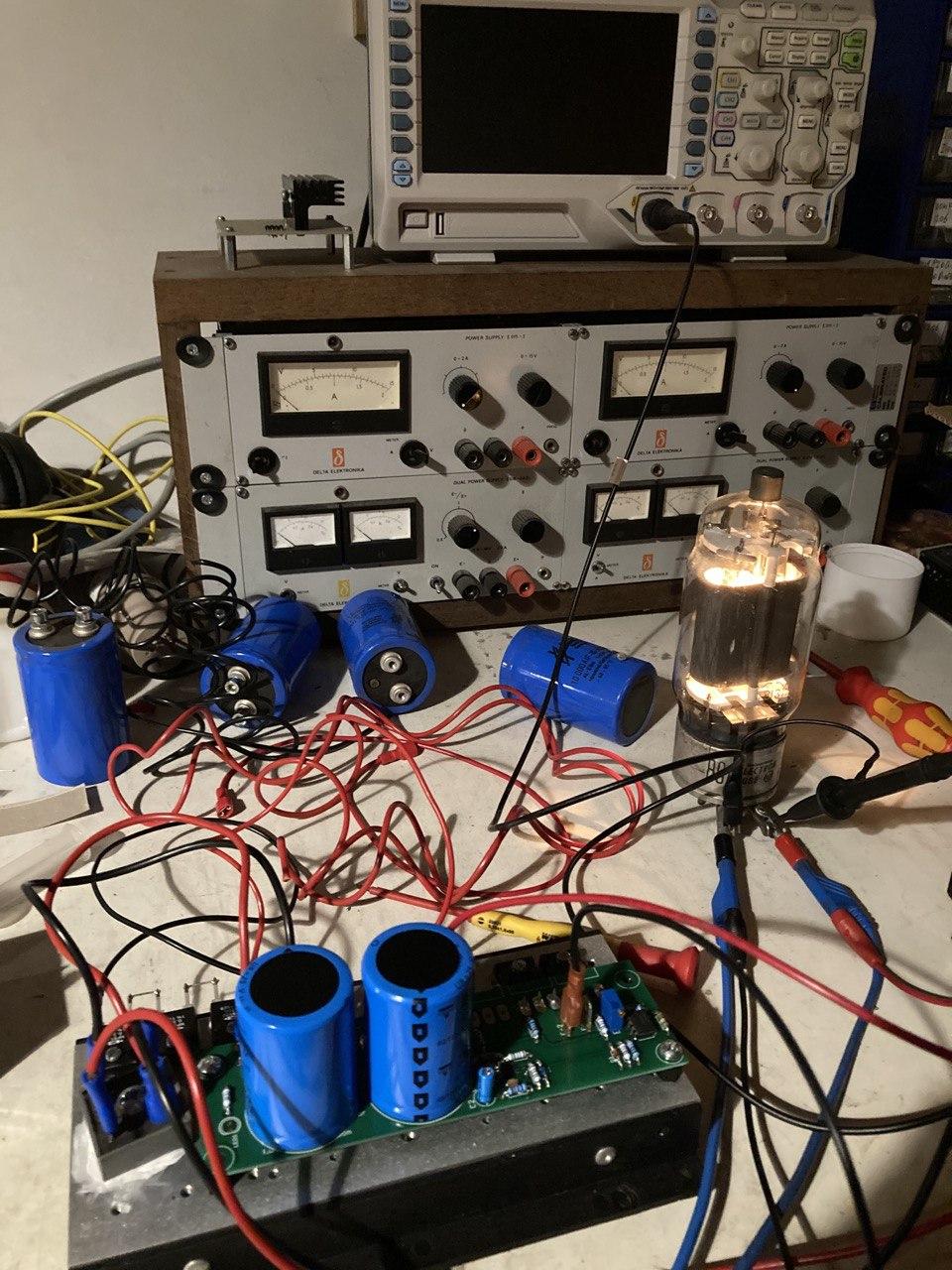

I can comment on the heater supplies, 20VAC rectified with a 50A diode block will give you more than 20VDC output, and the voltage will vary with the mains voltage.
I have developed a heater regulator that is capable of glowing a GM70 as well, this may be just the thing for you. Dropout can be set very low, and if your heater windings are beefy. E.G. capable of 5A AC these will drop right in.
Attached picture is that of the module glowing a 813 10V 5A load.
As far as the high voltage supply goes, i need to look at that better to see if there are no drawing errors. I think you are using a GZ34 as the tube rectifier, correct?

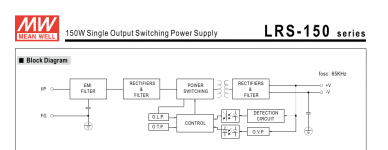

Yes, a mains→DC converter creates broadband noise that is not easy to control.
In my day job, I often have to add multiple-stage EMI filters to industrial equipment, just to reduce the SMPS noise enough to get the industrial product through the EMC standards tests.
This is not usually a problem for the DHT amplifier, if it does not use cathode bias, and it has been carefully wired.
The problem arises when there is a continuous ground connexion between the DHT amplifier and a DAC, or if the DAC is close enough to the amplifier to pick up EM interference. Broadband noise can degrade the DAC's analogue section, or the timing of input signals. It can be demodulated in current to voltage stages [I2V] if older opamps are used (before modern designs arrived with their EMI-hardening). Worst of all is EMI corruption of the Timing source - the crystal oscillator. If you have paid out extra for a low phase-noise oscillator (an excellent investment IME) the last thing you need is some clumsy power supply coming along and undoing the good work.
Think about why USB → I2S stages often come with a set of digital isolators - in order to break the USB ground connexion from noisy laptop PSU bricks.
This is the (main) reason I don't recommend mains→DC as the raw DC for use with my filament regulators. The problems arise in unexpected places.
Preamps or MC stages can also suffer, especially if NE5534 , AD797 or other older op-amps are in use.
The problems can be solved, more or less, if your design skills cover RF and EMC adequately - but the performance is usually still worse than if a good screened power toroid is used. And now that these are more widely available, and low cost (Antek AS series in the US, Canterbury Windings and Air-Link (audio grade) in the UK/Europe, Toroidy in Poland - there is little advantage from these converters.
The pictures in the previous post were to illustrate a couple of other points.
In the block diagram, the capacitors from input to ground, and from output to ground will form a loop from the noisiest part of the converter (Raw mains, rectified and chopped up at the switching frequency) and ac-coupling it to the output negative which is connected to the filament. This is not a very happy place to ac-connect the filament to.
The other shot is of the Leakage current specification. This is the value of ac current that might flow from mains into the output. Needless to say, it's very noisy.
If you use cathode bias, the current flows through the cathode bypass cap, or the resistor.
Note also, that the converter's output cap is now in parallel with the amp's cathode bypass cap - which is not helpful.
I'm not trying to say it can't be done - but I do question whether the convenience is a good trade off for the performance, especially if remedial work is needed
