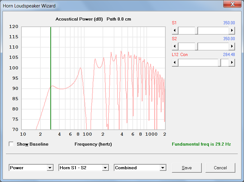

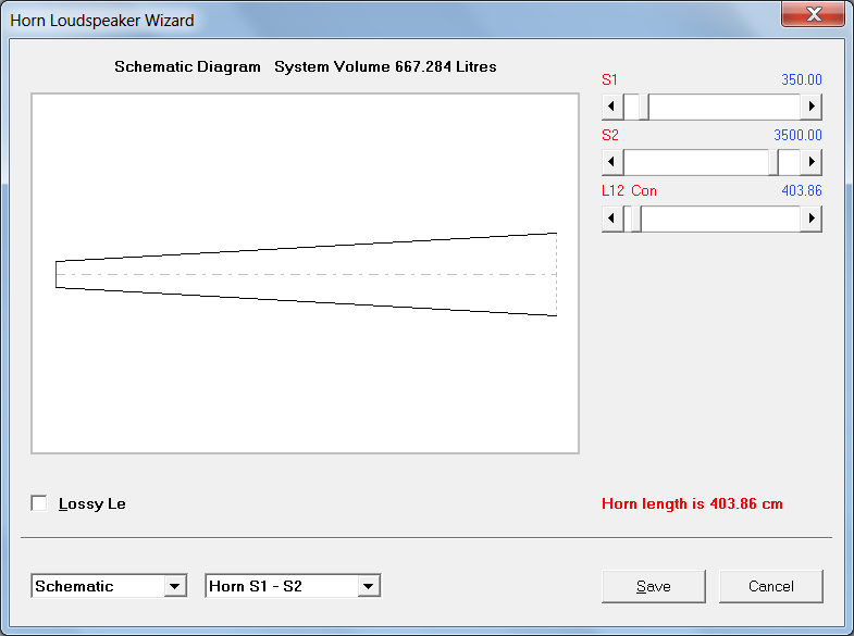

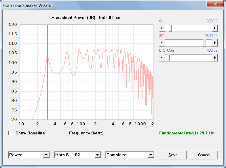

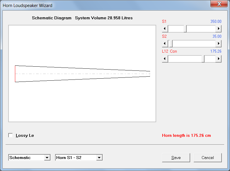

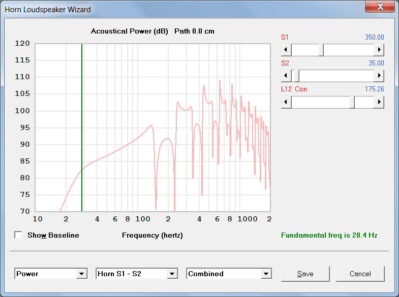

@GM - TQWT with hornresp for Beta 12CX, ASD1001, & PXB2:2K5CX?
For instance, if you wanted a 1/4-wave resonance of 30 Hz, a non-tapered line would need to be ~112" long. If the line had a negative taper of 10:1, it would need to be only ~69" long. If the line had a positive taper of 1:10, it would need to be ~159" long.
... as shown in the attachments.

Greets!
Those are two different designs with the first an inverse tapered TQWT best suited for lower Qt drivers and the other horn tapered vented [ML] TQWT such as Freddi's which are best suited to higher Qt drivers, while a constant [straight] taper [ML] TL is best suited for medium Qt drivers such as the Beta CX12.
Of course you can mix n' match, just this 'rule of thumb' [ROT] has its [minor] benefits, so planning a simple MLTL [no folds] like worked so well way back when, but need to know at what height off the floor you want the driver and what, if any, dimensional limitations.
GM
