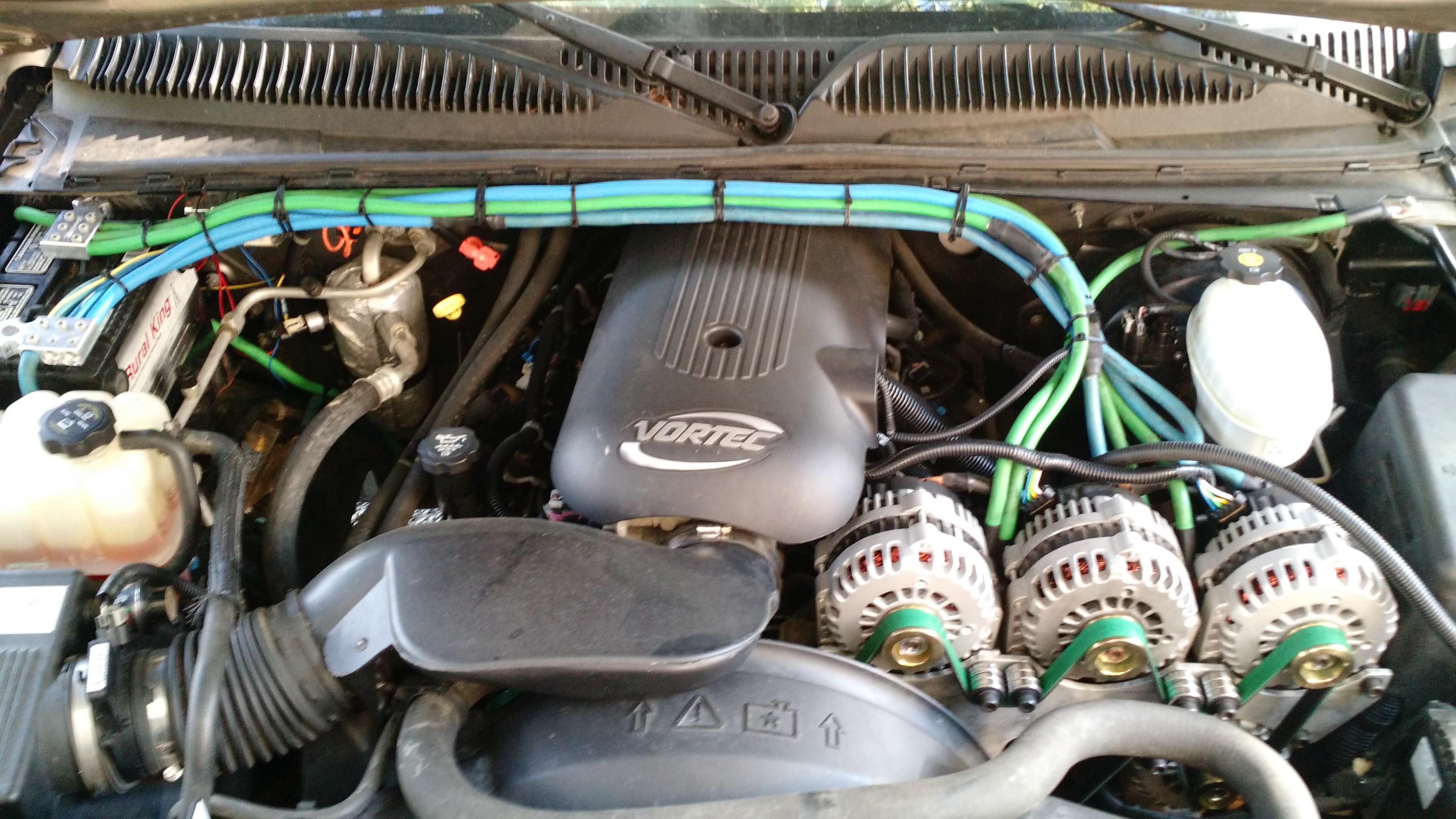

I got tired of blinking lights so I did a little upgrade to my electrical system. All the quad alternator brackets I looked at on the web didn't allow access to the power steering pump which is kind of important... plus they are way over priced. So I made my own out of 1/4" 6055-T6 aluminum plate instead. I need to ditch the lead acid battery for AGM and put in a bank of 3 or 4 AGM batteries for a 10k power inverter also. But it's a work in progress. Needless to say my amplifiers are happier now and so is my truck, no more disco lights!

Hi Perry 4 x 250 (1000) amps. All the alternators tested a little more than 250 amp (max) but i'm calling them 250 amps each.
I'm looking at installing a 10,000 watt inverter. So I can power the house in case of emergencies and also run power tools off the truck. I'm still shopping for an inverter but from what I've reading they require a bank of 3 or 4 deep cycle batteries and runs of 4/0 guage wire.
those alternators wont last long at idle while running your house. the ad244 is a wire wound alternator and will make most of its power at 1700 to 2000 alternator rpm(not engine rpm) and will over heat at idle. a 10kw generator would be a much better option. even the best aftermarket builder cant beat that. Also most engines cant produce enough idle HP to turn 4 alternators at full current draw. i know you wont be pulling that much power all the time but it would be more efficient to feed a 18hp single cylinder vs a V8.
But if that is your desire to do it that way then i might suggest a fast idle control for your truck. Thumbs up on making your own bracket. Best wishes.
Hey Bill thanks for responding. I built these three phase alternators myself so if the diodes burn it's my own fault. I don't have the part numbers handy at the moment, but I went with NTN bearings, 250 amp strator, high quality rotor, voltage regulator with 14.7 volt set point (15 seconds on 90 seconds off at peak), full copper heatsink recitifer with 6 x 80 amp diodes. I also added 10SI 1 7/8" overdrive pulleys to bring the alternator RPMs up at engine idle.

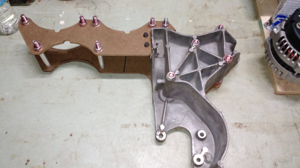

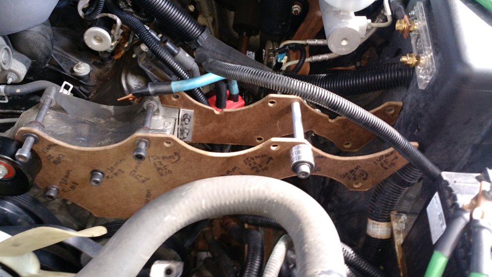

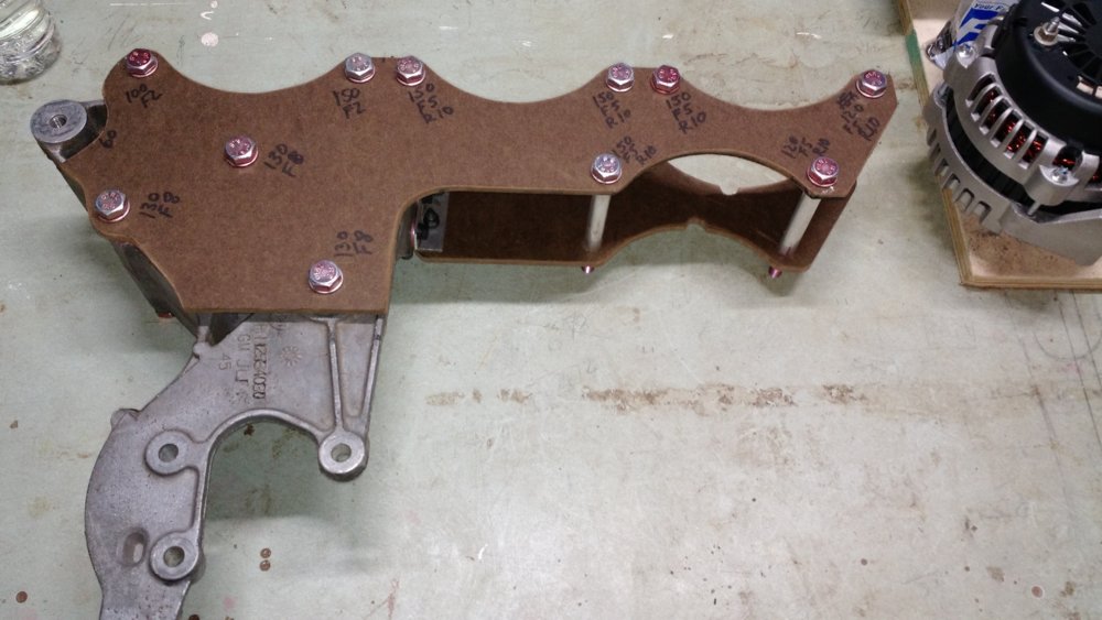

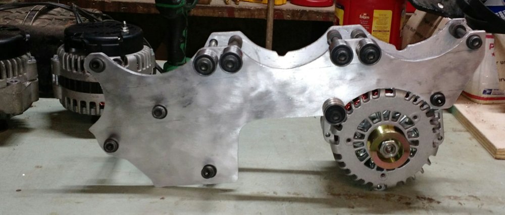

I do a lot of wood working so the alternator bracket was a cakewalk. I first went to the junk yard and bought a power steering bracket. Then I made the alternator brackets to fit the power steering bracket out of 1/4" hardboard. I then installed the hardboard brackets in my truck (test fit). I had to reroute one ground wire and move the PCM (computer) forward about 3" to make space for the lower alternator. Once I had everything tweaked with the hardboard templates. I used my woodworking router and a flush trim carbide wood cutting bit to cut the 6055-T6 brackets.
There is some slight modification need to the cast aluminum power steering pump bracket but it's nothing major at all.
I also had to go with a 60mm idle pulley to replace the stock idler pulley so I could use an off the shelf 06 ~ 10 Ford F350 Gates heavy duty fleet runner belt (125 5/8").
Here's a few pictures of the work in progress.

The small roller bearings your using for idlers will be turning some really high rpms, do you know what they are rated for ? Its a well made setup, neat and tidy.
They are SKF 6200-2RS (single row 10mmx30mmx9mm 2 rubber seals) rated for 15,000 RPM MAX with a temperature range of -40 degrees to 212 degrees F.
I was originally going to go with 5200-2RS (double row 10mmx30mmx14.4mm 2 rubber seals) but they are only rated for 7500 RPM MAX, 1/2 the max rpm of 6200-2RS and surely would have failed.
