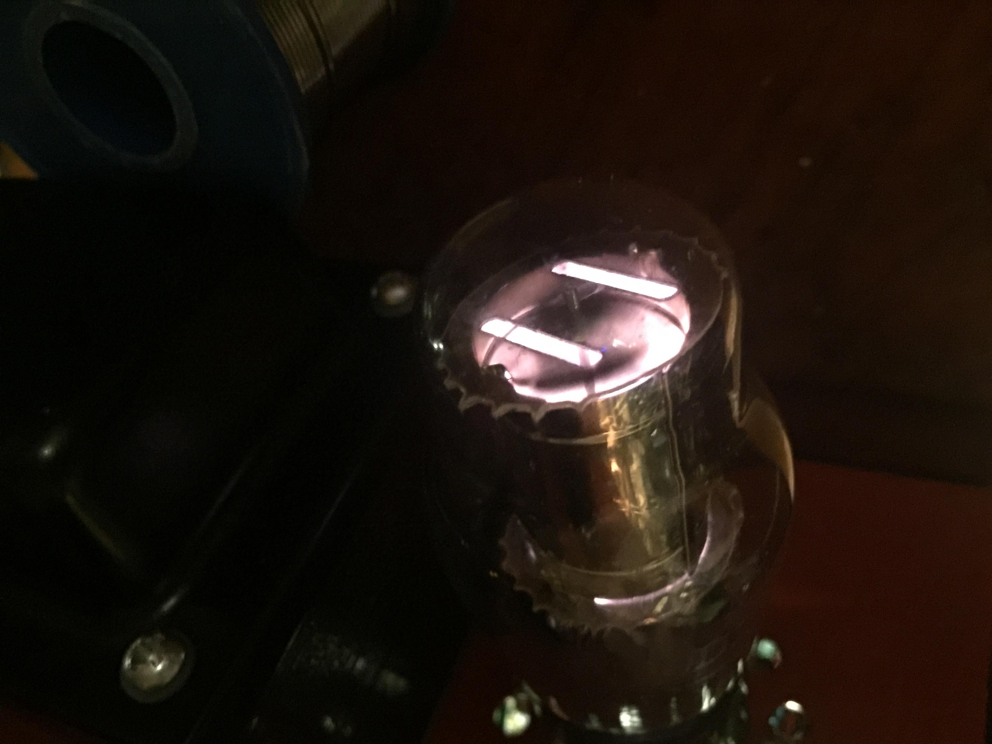

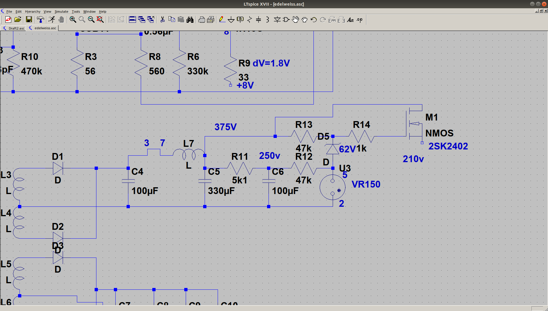

Today I made a power supply for an amp, including a regulated G2 supply using VR150 voltage regulator, 62V Zener, and a MOSFET. It glows, and provides together with Zener diode a reference voltage.

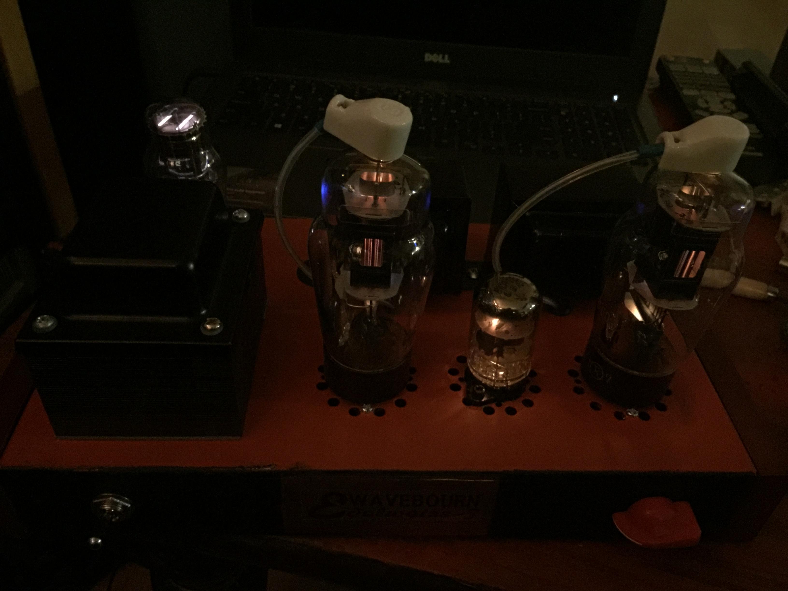

Awe… that's cute.
So, Wavey Davey, I love the design. Simple, to the point. Question is, how does it work? I'd bet it is as quiet as a mouse. GoatGuy

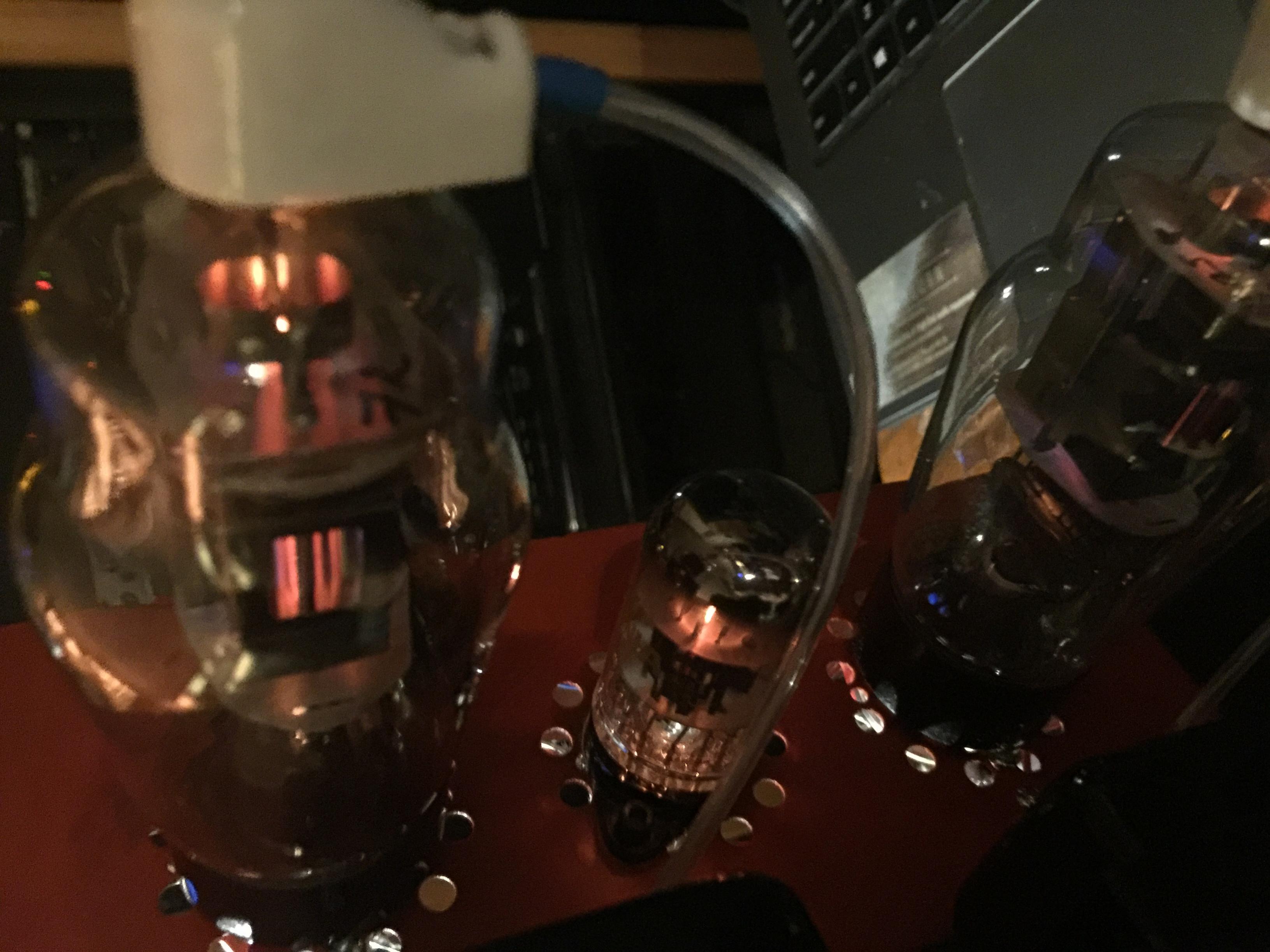

Yes. Previous 2 versions of Edelweiss were absolutely quiet with 98 dB/W/M speakers. This one is not finished yet. But the main purpose was not to make it quiet, it was to reduce distortions caused by G2 voltage depending on the signal envelope.
