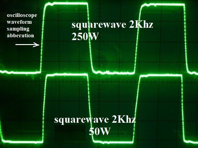

The particular output transformer I was testing with in the Williamson had a dominant squarewave ring out at circa 200kHz, which was convenient to use as an indicator of stability margin, and for comparing different combinations of feedback compensation. That allowed a good indication of an appropriate value of inductance to use (given I was able to iteratively test with the same base Panasonic ELC-08D220 part but with different numbers of turns). In contrast, the Encel amp's output transformer appeared to present quite a steady gain and phase change out to resonance (circa 160kHz) with no convenient squarewave ringing to use, up until unstable operation. A 1955 report illustrates the variety of higher frequency resonant responses that can be expected from even 'good' output transformers - https://dalmura.com.au/static/NRL report 4136.pdf .

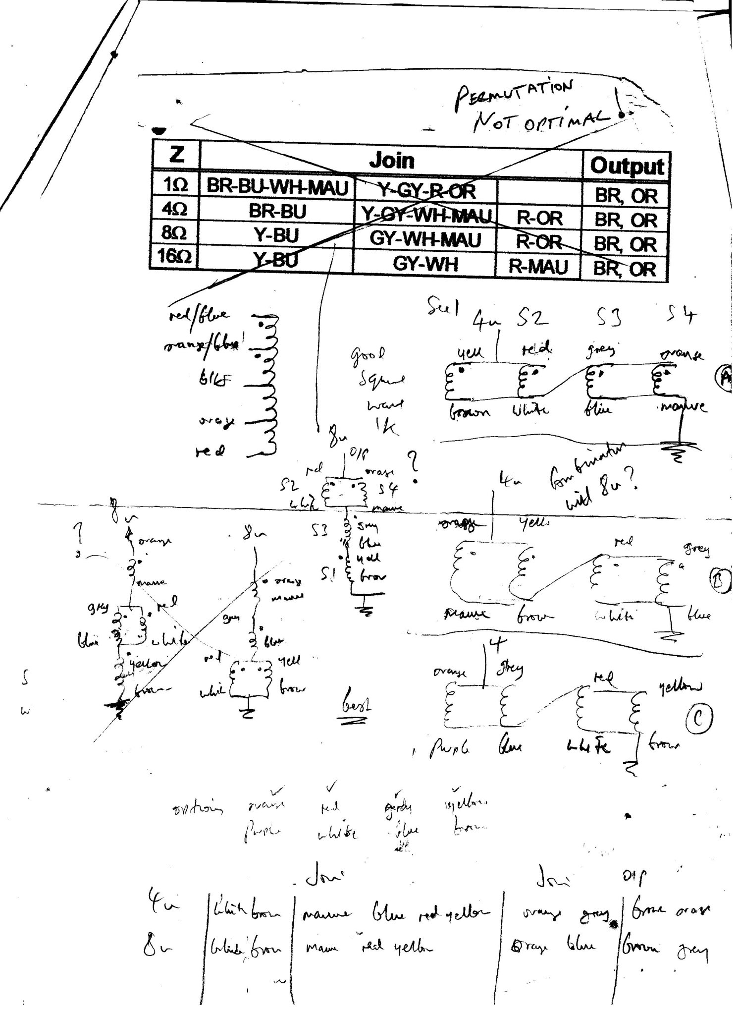

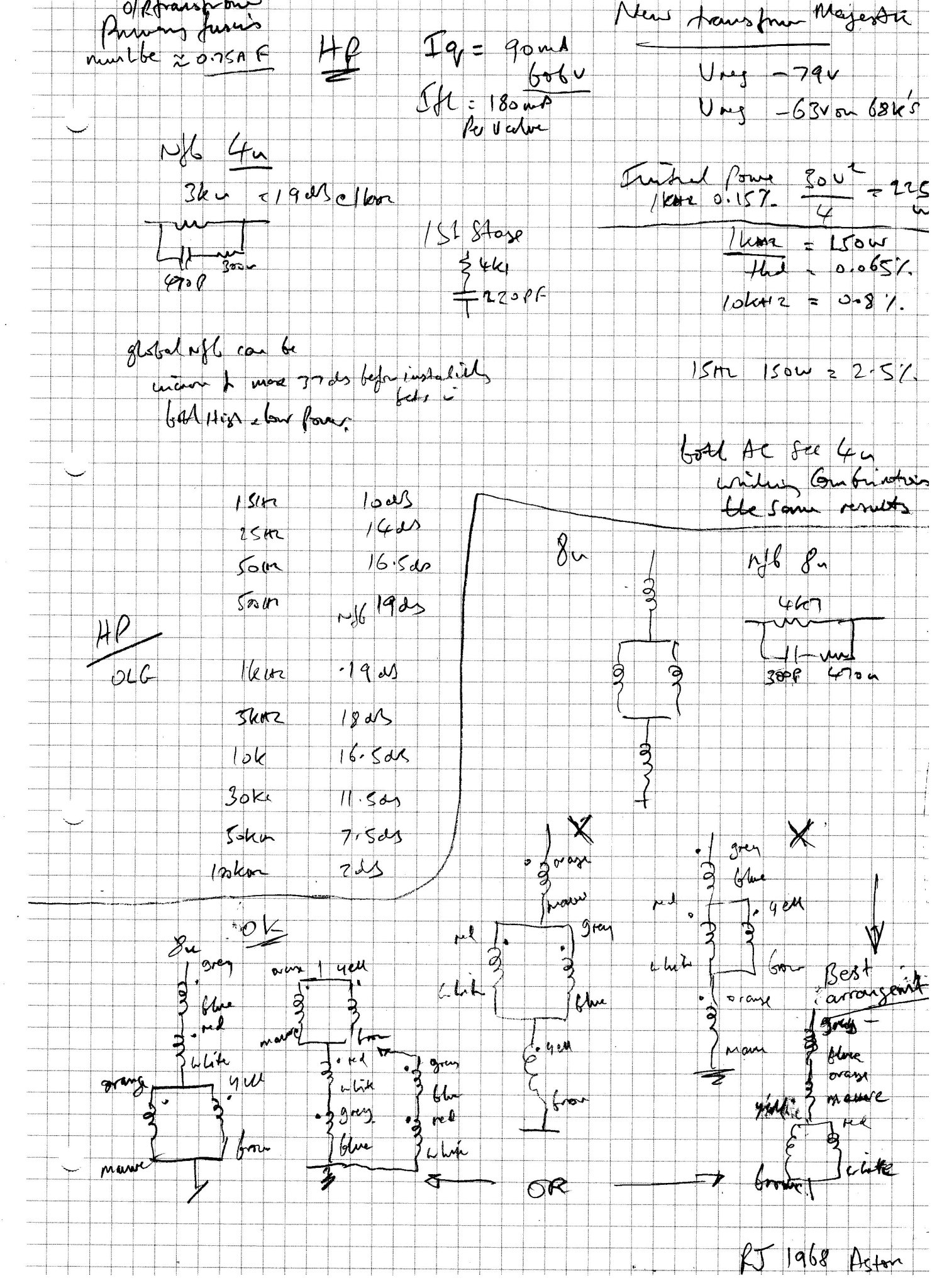

In 1968 as finishing UniI I revert to my hazily scribbled midnight notes regarding the connection optimization of a p-p UL output transformer with identical multiple secondary windings. (I´ll keep the math and complex waveform analysis out of this). At that time, I was curious about the Quad amp cathode tertiary feedback arrangement. Was that transformer winding optimized over the stray parasitics? The McIntosh designs of bifiliar winding the entire lump was a solution so long breakdown didn´t occur. I never owned a Quad amp but serviced a few in my time. Here in pic is a typical label denoting secondary arrangements of a good quality transformer. However, read on.
More recent times, 15 yrs ago I bespoked two custom 18 section Williamson design o/p trannies to an old time UK winding house who had the original interwinding configuration details. After receiving, and some testing I soon found out that one should never take for granted the identical multiple secondary winding configurations that winding houses provide for load permutations. The transformers as they stand with suggested connections put into a circuit would offer excellent results that maybe no-one would spot performance differences; but get the squarewave performance optimized, much inter-swapping of secondary permutation eventually arrived with bandwidth improvements with minimal ringing. (See pic)
There were secondary configurations that could make a mess of the square wave, contradicting the series R/C´s and phase corrections in amp circuits. So complex L&C´ parasitics, even by a slight winding orientation misplacement is enough to manifest as Morgan Jones found out. The higher the frequency and rise-time, the more irregularities one spots. There is another; that RC combination often used between the UL screen tap to anode. Most designs use 1K+1nF, but values also creates subtle differences in the rise and fall squarewave ramp. More work to be done on this.
Also on hand, I had two similar transformers from another manufacturer (7 sectioned designs from Sowter) so the differences could be compared. I decided to examine/ optimize the secondary configuration before all was bolted to the chassis. After a little testing I found the Sowter had higher winding resistances and capacitances. I strongly suspect their designs are computer optimized designed whereas the more intensively hand-made 18 sectioned Majestic used the backdrop of the old Williamson details.
Each output transformer weighs 12 kg. With 2KA-A, 43%UL taps, each secondary winding is rated over 200W. The large core rated for distortion around 1.5% at 15Hz; that implies the midband could easily handle 500W before other issues arise. With the large bobbin there is a fair amount of wire so mean LPT (length per turn) tendency towards a high capacitive interlayer exposure, so the parasitics and eventual upper frequency curtailment were a prescribed certainty. A knowledgeable winding house can compromise much interwinding conflicts and advise on Si-Iron grades; provide expected power bandwidth, cutoff freq; and distortion prediction. Langford-Smith Radiotron Handbook mentions all these parameters can be theoretically worked out.

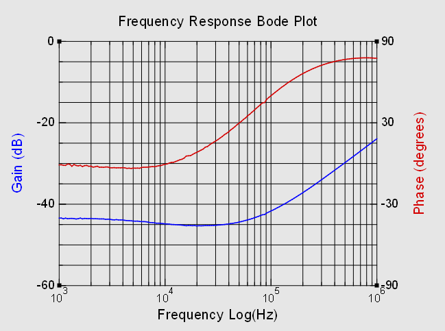

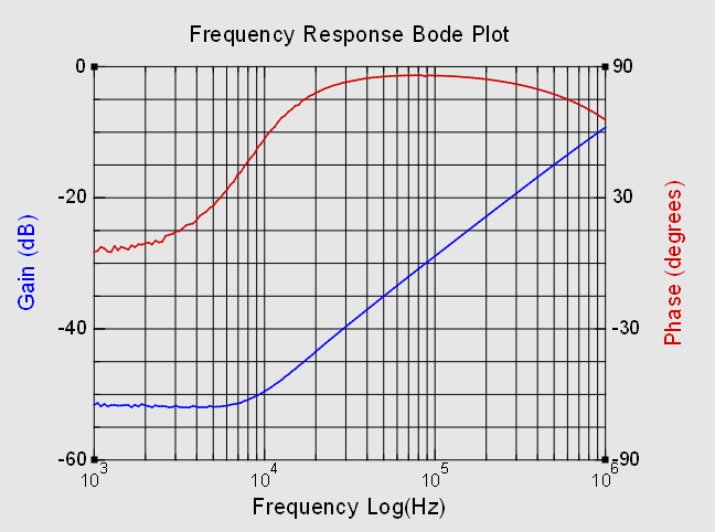

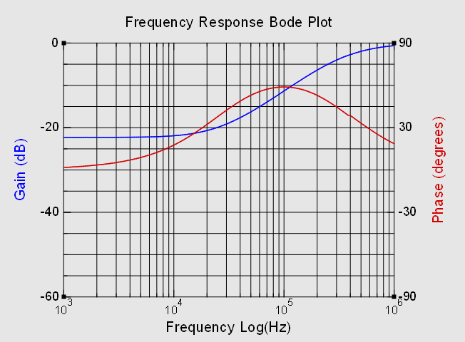

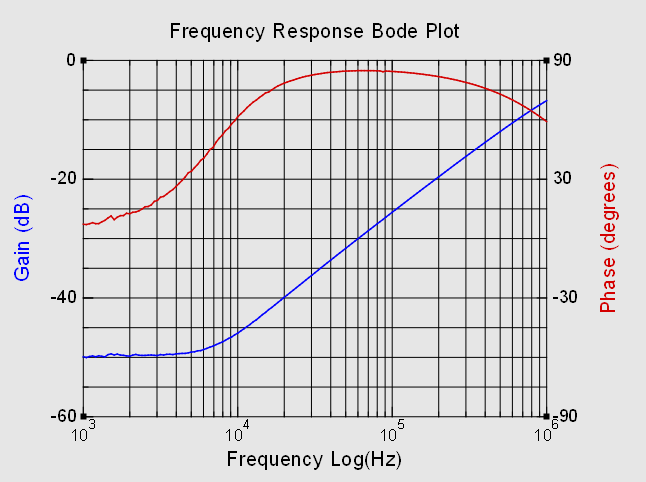

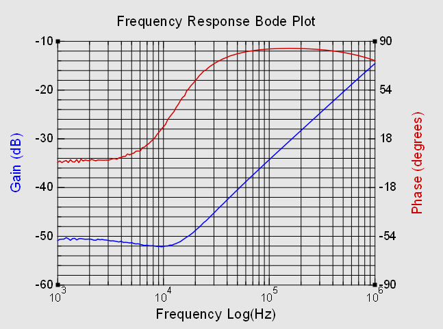

To add some measurement detail related to the feedback inductor part, there are six gain-phase plots below for a passive R-L network attenuator fed by a signal generator, based on a Picoscope 4224A and FRA4 software. The gain (attenuation) is the signal across the test inductor L, with the input signal level presented to a 10 ohm resistor R. In general, the impedance of the inductor below circa 10kHz is negligible and resistive, and so there is only a low voltage signal with close to zero phase shift across the inductor, as shown by the attenuation level. Most of the plots show the inductors exhibiting 90 deg phase shift from about 10kHz to a few hundred kHz, and a 20dB/decade change in gain, which is likely what is required to provide a stable feedback signal in the frequency range of interest.
The 4T part is shown in the photo in post #1 as 1.6uH, as originally estimated by modelling in an REW/soundcard impedance jig. That estimate appears to be somewhat high, as the attached attenuator plot for that part indicates an inductance of 0.84uH, and a turns-ratio estimate of the original 22uH part (with 24.5 turns) would suggest a 0.74uH value with 4.5 turns.
The plots of the ferrite bead/tube parts indicate inductances of 0.6-0.66uH, where 5mm and 6mm refers to the length of the ferrite bead. The ferrite material was not known for each of those parts, although they were for general emi suppression use.
For contrast, one of those plots is of a suitably low inductance smt part ( 4.7uH CTMC1812) I had on hand indicates that various part technologies may not be suitable as the part becomes resistive after a few hundred kHz. Another plot is for another 1812 size smt part applicable to EMI suppression, with a 300mA 70R 100MHz rating, that appears to present about 0.13uH.
