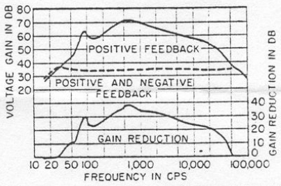

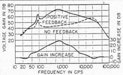

The issue here is PFB improving overall distortion performance.
No, pfb does not do that. Pfb on itself worsens distortion and almost any other parameter, but it does increase gain which enables nfb to use that excess gain as loop gain to improve the amp.
That is clearly explained in the article I linked to.

Never seen a Schmitt trigger in the signal path of an audio amplifier 🙄.No, it wasn't current feedback, it was voltage feedback. In that commercial amplfier for example, the PFB stage was a Schmitt trigger-like circuit.
The tube amplifier designs I was referring to did implement both voltage NFB as well as current PFB, if we can agree that current FB means sending back a signal that is proportional to the amp's output current.

This is just your opinion. Have you read Miller's article?
Not just opinion. I have that article on my website for 15 years.
Anyway, if you do the math, it becomes very quickly clear that pfb increases distortion, worsens the freq response, and deteriorates the output impedance.
Which you would have known too, had you taken the trouble to read the article.
Jan
