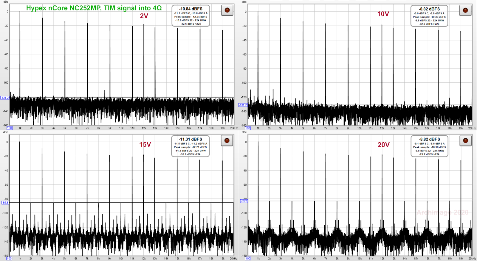

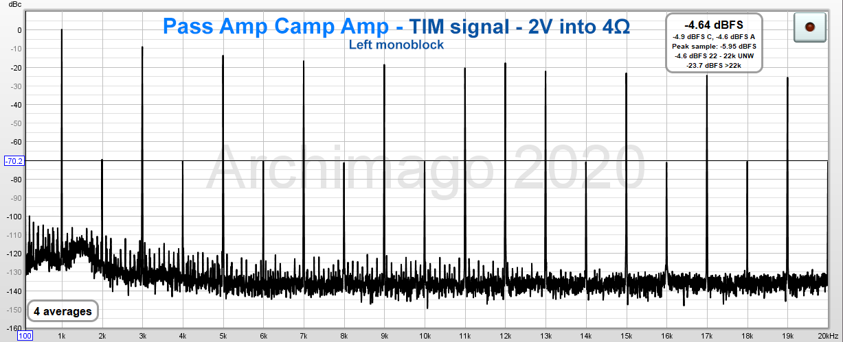

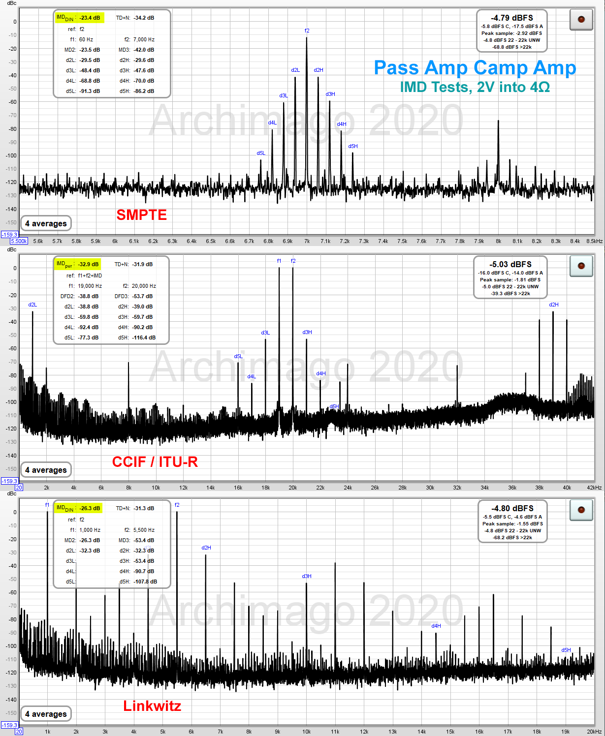

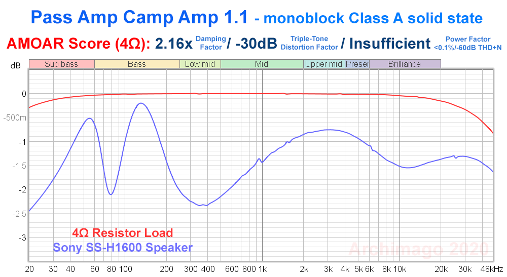

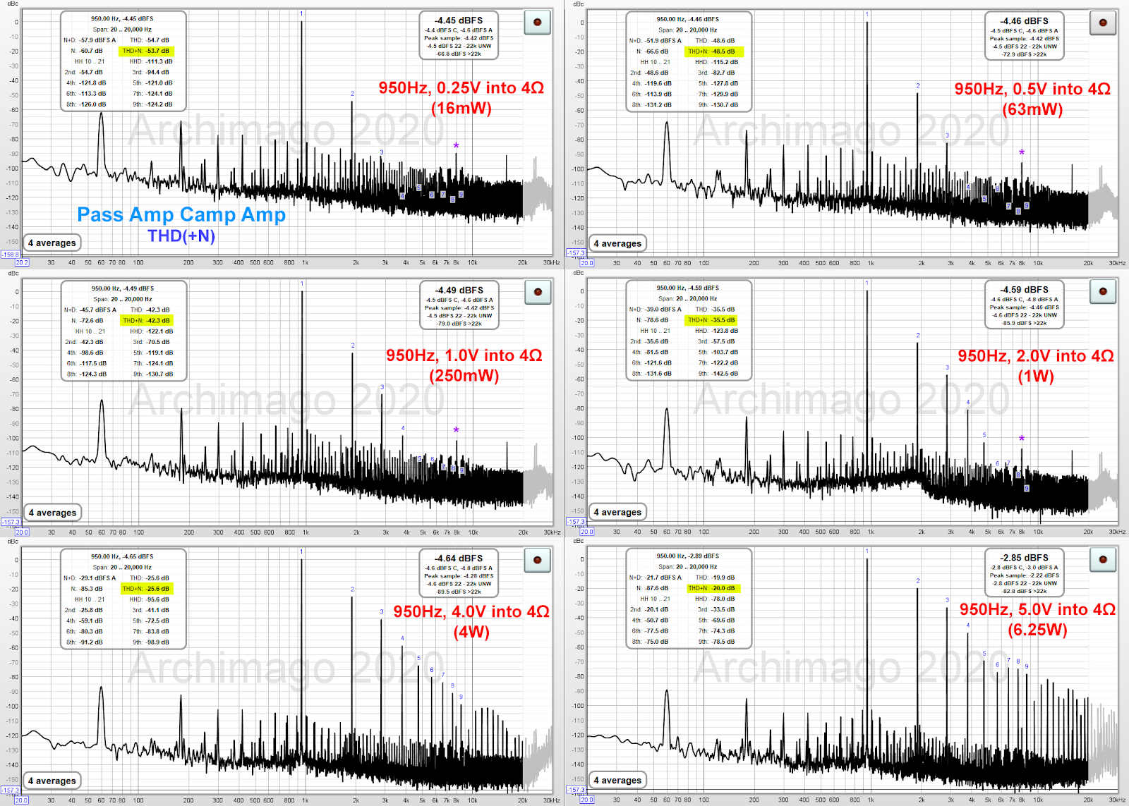

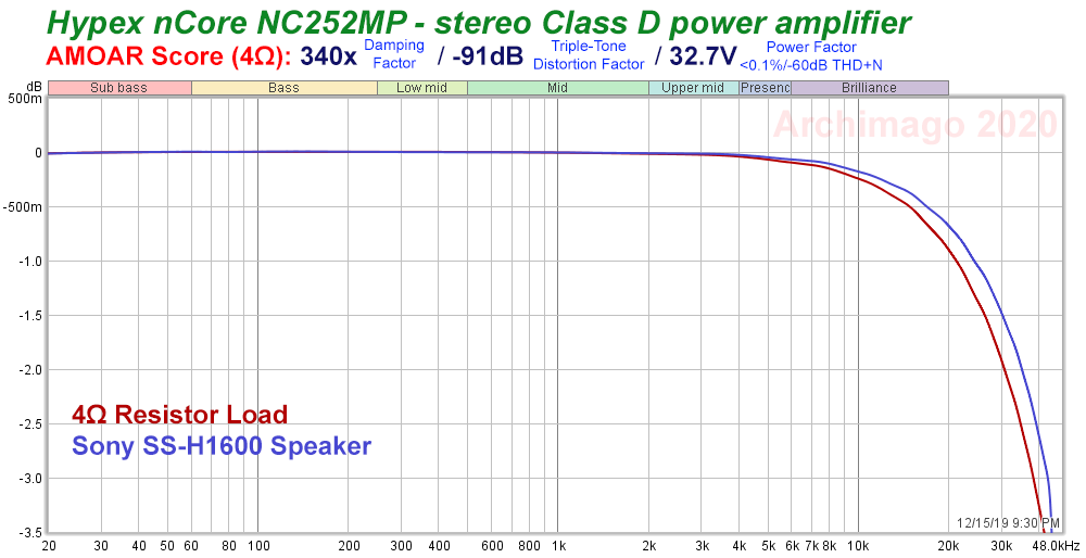

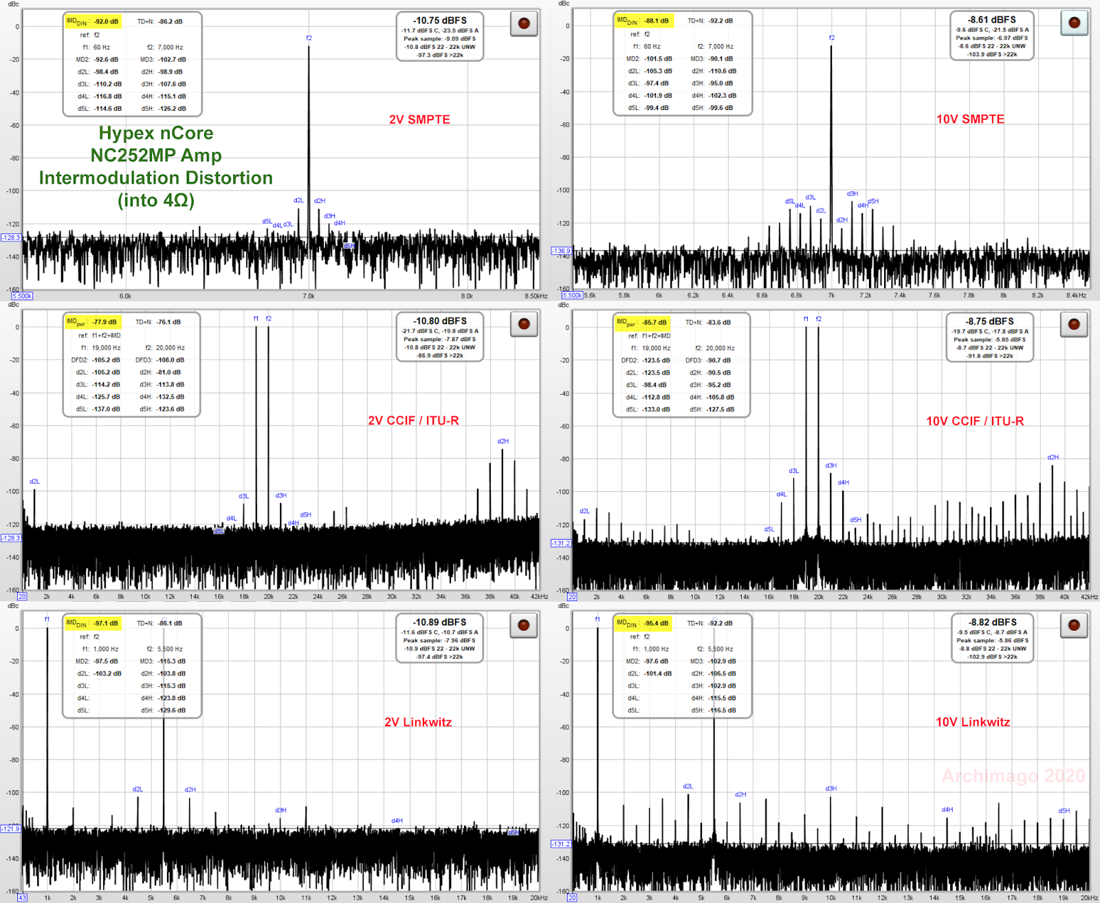

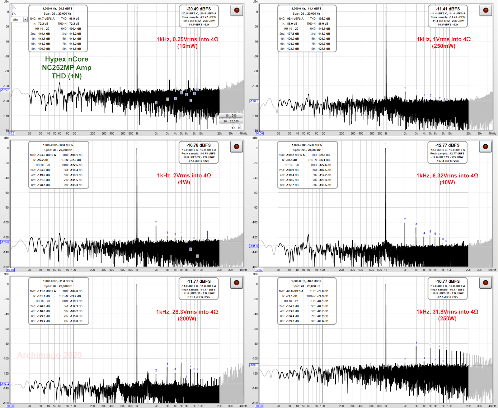

Some measurements from Archimago (I had to attach the images because the editor is unusable for me with inline images)
