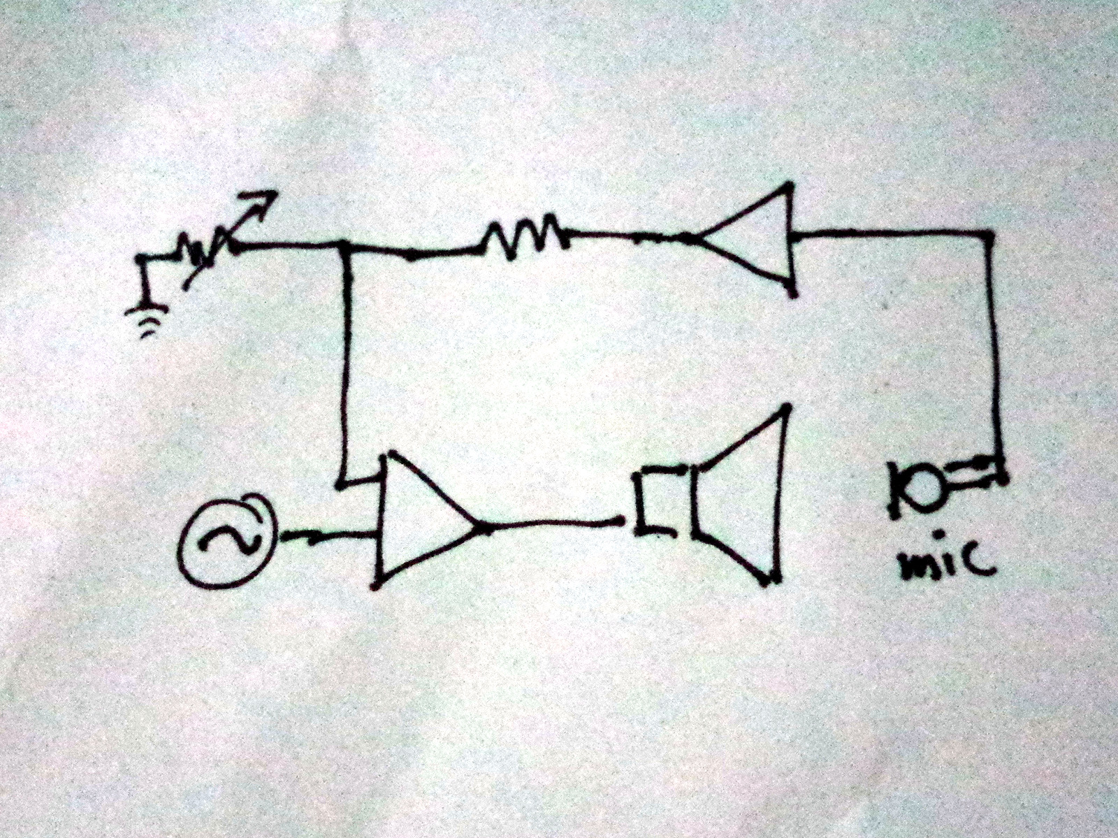

Let's assuming everything is ideal, will this work? 😀
In theory, "assuming everything is ideal" it could work. However (there's always a "however" when it comes to theory vs. reality) you would have to find a way to acoustically couple the speaker output perfectly to the mic while totally eliminating external influences from room reflections and such. Good luck doing that!
Mike
More than that -- you'll also have to do with the speed of sound (a fixed delay, expect instability). The mic can't be at the zero delay source point, that's usually about where the voice coil and front plate are.

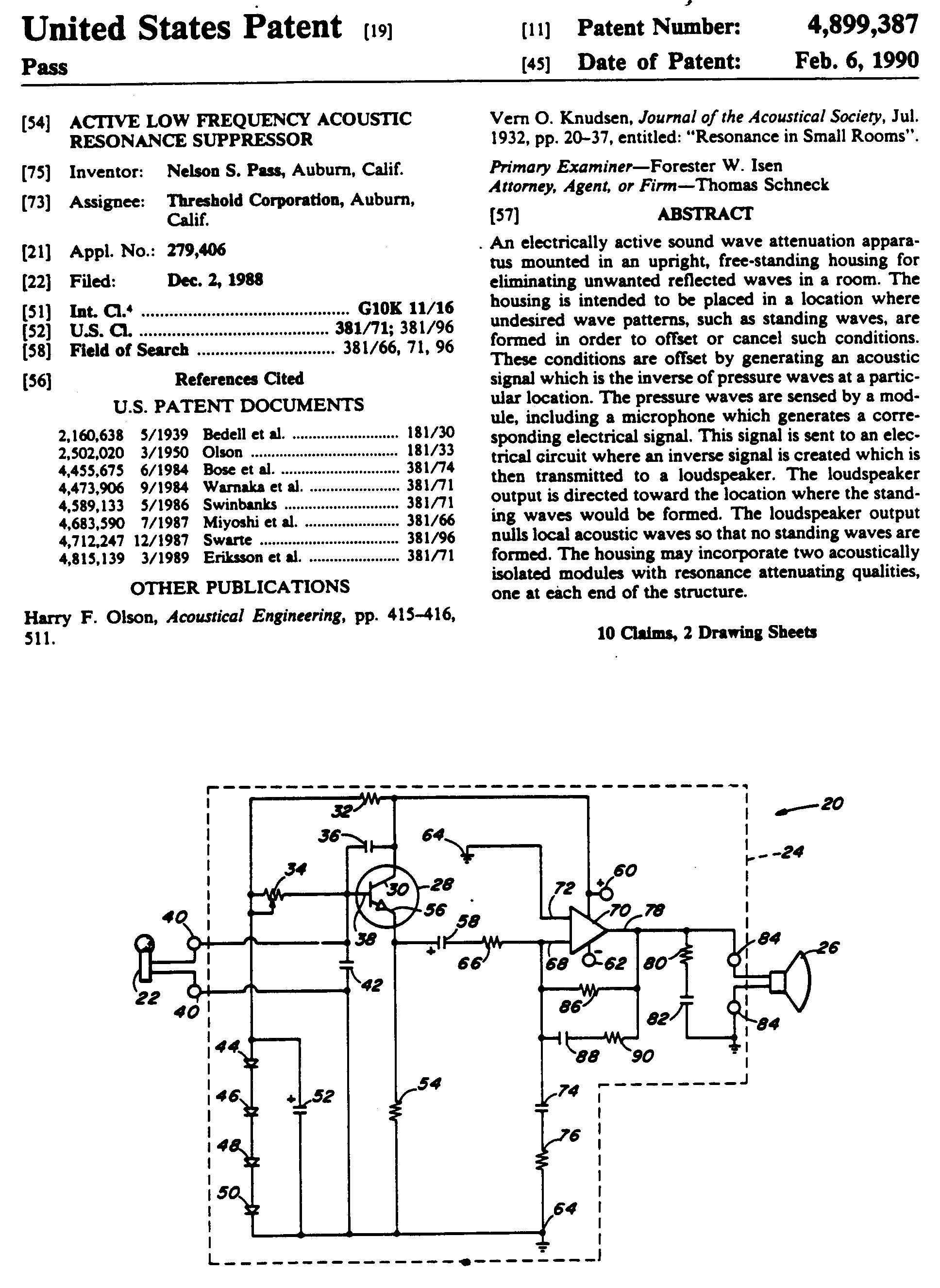

Using a mic for servo feedback of a sub works pretty well, but you have to keep the bandwidth low with some pretty aggressive compensation. Hard to get enough feedback (while stable) to reduce harmonic distortion by much, but the FB can do wonders for compression (at fundamental frequencies) and for keeping response flat.
I made one a few years back using the mic (instead of the usual accelerometer), found it worked best to glue the mic capsule, sideways, right to the cone at the dust cap. It senses local pressure, and the electret capsules have limited signal handling so use of a large diameter woofer is a good thing to do.

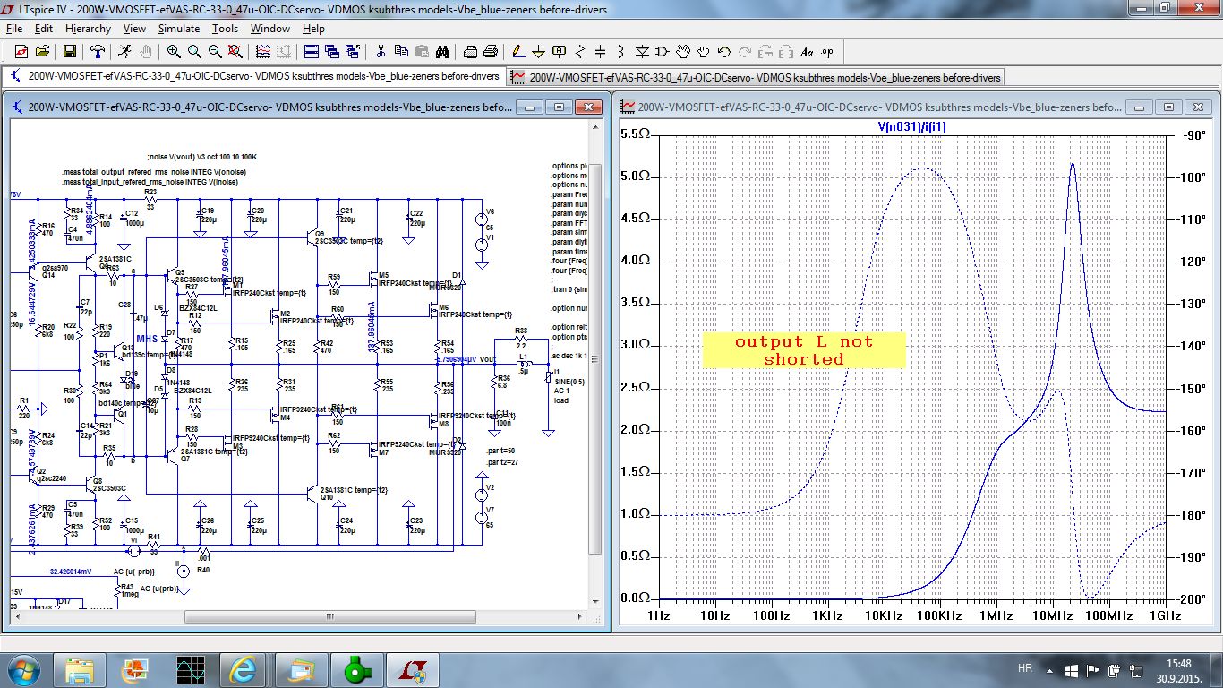

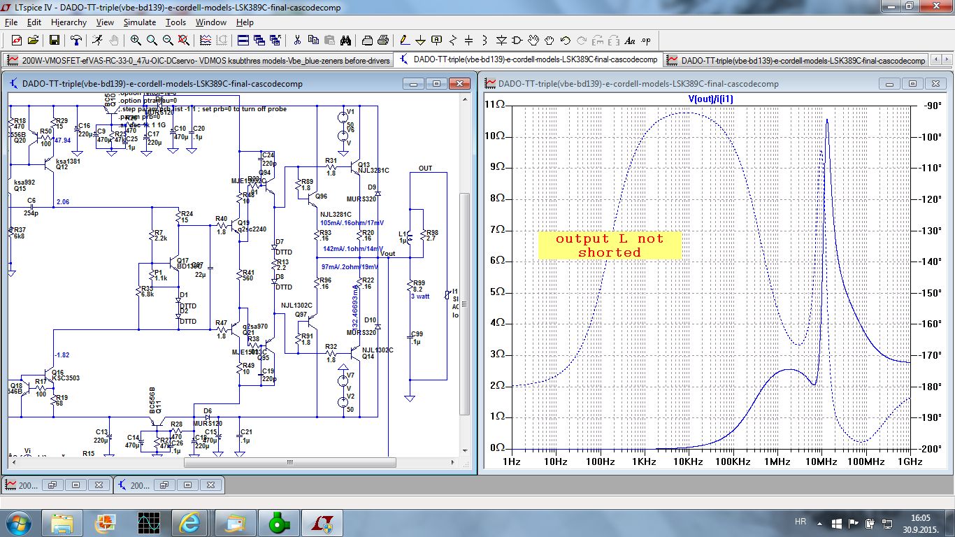

This is an amp with flat NFB up to 20 kHz and here the output protecting coil has much higher influence on the output impedance of the amp than the amp itself. With no coil the ouput impedance rises steady from 1.15 nohm to 19 uohm at 1 MHz.
This is an amp with more typical decreasing NFB and, still, output inductor dominate the output impedance. The NFB lowers enough output impedance in whole audio range.
Some are striving for "absolute measured performance".
So, if you have to use output inductor, it's even worse regarding linearity of output Z.
You don't really have to use it, with output stage not in a NFB loop.
