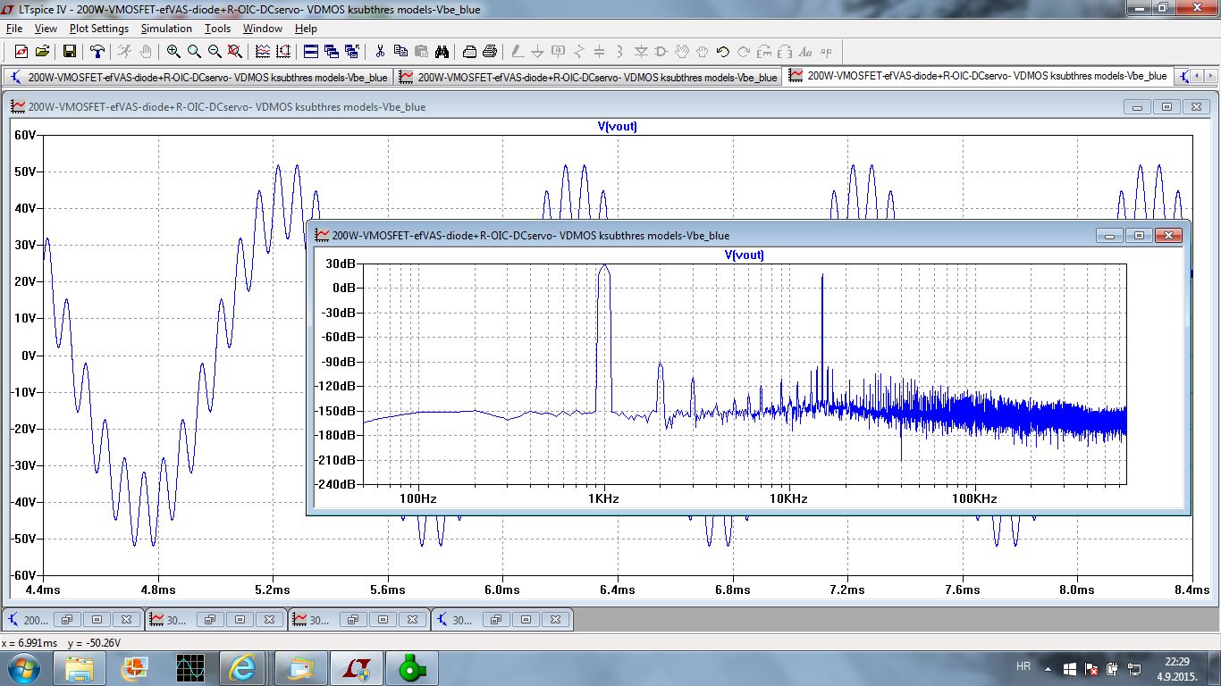

It can also look like this... This is a VFA. evaluated on a single tone this has more THD than the CFA posted above.
I don't know why this test is important to you but here is one CFA at almost full power. Something must be wrong with your CFA.

mostly recently here there has been really bad fanboyism about CFA vs VFA - with many examples where the input topology difference isn't even in play - some of the claimed performance differences look to be coming from other design decisions not required by the CFA/VFA distinction.
for instance any CFA designs shown on diyAudio recently seem to also implement the "flat loop gain over audio" foolishness - but you can have higher/sloping gain at audio frequencies with either VFA or CFA
It's nothing to do with fan boyism. It's about design choices. I built both CFA and VFA of amplifiers and on the sx-Amp (c 60 kHz -3 dB LG), made flat loop gain a design goal. There had been a lot of discussion about PIM and I wanted to see if there was anybeffect on the sound. My big VFA also has extended loop gain (about 40 kHz).
I do not favor either topology over the other. In my book they are both valid design choices.
Regards distortion the sx-amp is high (see the plots in the write-up) and the e-Amp low double digit
I like using the sx-Amp for classical and acoustic music, and the e-Amp for heavier stuff on the B&W's. I have a pair of small bookshelf speakers that don't have a particularly flat response but image superbly - they are a great match for the sx-Amp but seem to lose their 'sparkle' with the bigger amps.
The Ovation 250 is 'semi- retired' now- I need to do a rebuild. This was a straight VFA but has a very 'dark' sound. The guy that sold me the book shelf speakers loved it SMD preferred it over the e-Amp at the time, which he described as a thoroughly modern amp. He is a tube guy BTW.
I did not go for the "flat loop gain over audio" foolishness in my amp. I could not get more then 80 dB at low frequencies as it use simple resistor load (no active load there), but I could boost it up to 20 kHz (compensation) and result was a flat loop gain (and very similar THD at all audio frequencies). I could not get that with any of my VFA amps with CM where it's " normal" to have 120 dB at low frequencies and hardly more then 60 dB at 20 kHz.
I don't prefer CFA over VFA, just CFA is new for me and I enjoy to play with it.
