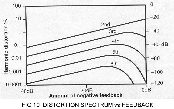

All power to your efforts re open loop linear John Curl. The best sounding headphone amp I ever built was an open loop tube circuit, CC followed by CF. The sonic signature of Papa Nelsons amps is clearly due to his choice of fets, as you have made this choice done in your own preamps.
We know that local feedback, like emitter
degeneration, emitter followers, split-load phase inverters, and anode
followers, doesn't exhibit the Baxandall/Putzeys harmonic multiplication effect.
I am not familiar with the Putzey harmonic multiplication effect, but if
you are referring to Baxandall's famous curve (attached) then you will
find that local feedback (including degeneration) creates the same
phenomenon.
Yes, and in the famous Boyk and Sussman paper about IM distortion, all the examples are local feedback.I am not familiar with the Putzey harmonic multiplication effect, but if
phenomenon.
