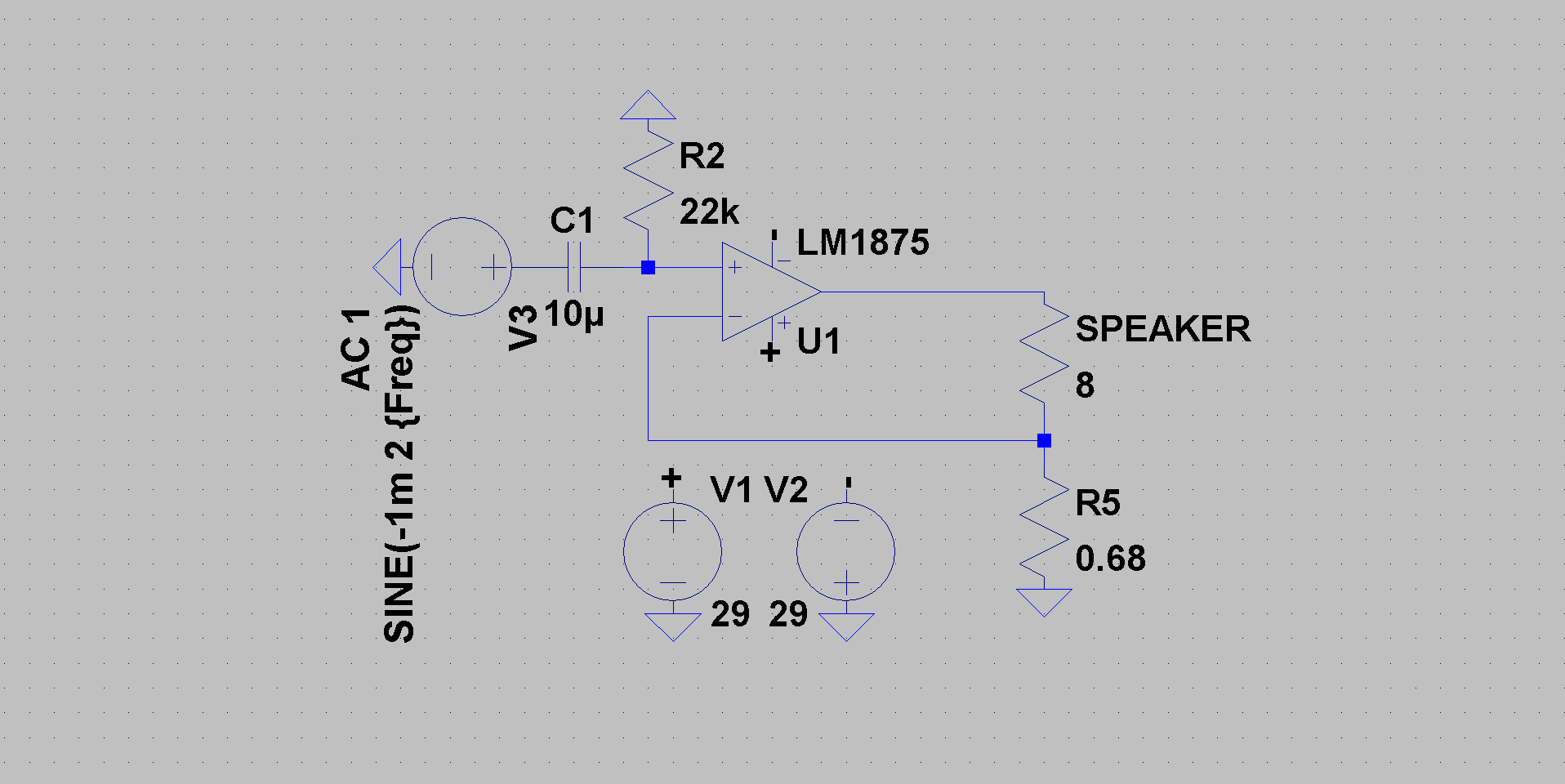

My 2 cents with lesser explanation:
for me with minor issues (no damping of the speakers) this is (attached picture) the only way to use gnfb. All of my transconductance gnfb power amps are the winners vs voltage out gnfb power amps, both diy and commercial designs.
GNFB in preamps is excellent thing but probably for another thread.

I am not aware of any studies showing PSRR varying with input signal. The loop gain varies AFAIK with frequency. PSU ripple will vary with load current, but going from that observation to the conclusion that it is the reason some find GNFB amps objectionable is a big step IMV.
If you have done sims share them - what is the underlying mechanism for your observation? Early effect maybe? C-B junction capacitance coupling hash on the rail to the output rail?
Any 'hash' from the OPS that finds its way to the LTP ends up exiting the LTP stage as a corrective signal that improves PSRR. If the amp is running OL, there is going to be no correction taking place other than local decoupling or any other techniques that are being applied. Please note this does not mean I am an advocate of sloppily designed OPS stages - but how can a well designed OPS with optimized PSRR in OL be deleteriously affected by the application of GNF if it further improves PSRR?

With TMC or TPC, the phase accumulation of the slow OPS can easily be taken care of so that at HF, less feedback is actually going around the complete loop. For standard MC, the only way to avoid instability is to,close the loop at a lower ULGF.
I have rise times on VFA of 1.2 us and on CFA about 700-800 ns - these are typical of modern amplifiers that are comp'd for 60+ degrees phase margin. Whether open or closed loop, you don't want too fast rise times because that will potentially trigger ringing and overshoot problems. This then places greater onus on the PCB layout, decoupling etc.
If you are using an output inductor and GNFB one thing to try is to replace the L with a 1 ohm resistor. This provides quite a bit of damping and you also push any amp/cable resonances up in F.
