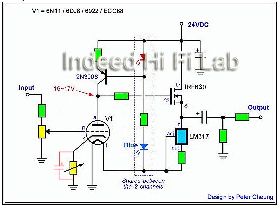

I assume this is what I saw, the blue LED might overwhelm the glow???
Maybe I'm just stoopid, but how is that tube filament getting enough current to get hot? And if it's not, how is the tube passing any signal at all?
Hard to tell without resistor values. But why do you foresee a problem? Same CCS feeding the mosfet is feeding the heaters, maybe a cheapskate solution but it works.
Yeah. I see it now (face palm) 😱
I've been doing battle with a nasty cold virus so I've been sleep deprived all week, my little brain probably isn't functioning at it's best.
That's my story and I'm stickin' to it. 😛
