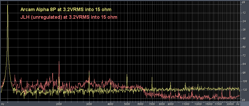

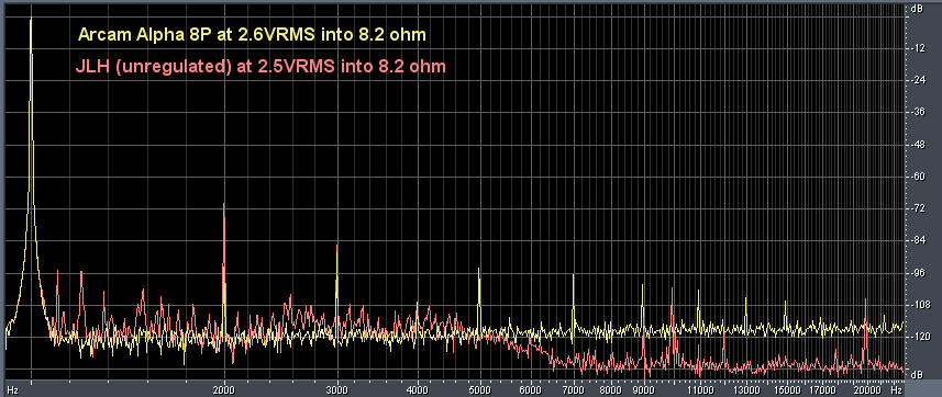

Basic comparison of THD spectrum ,
A class - JLH1969 vs a/B class - Arcam Alpha 8P , two different static load , 8,2-ohm vs 15-ohm .
Your comments ?
