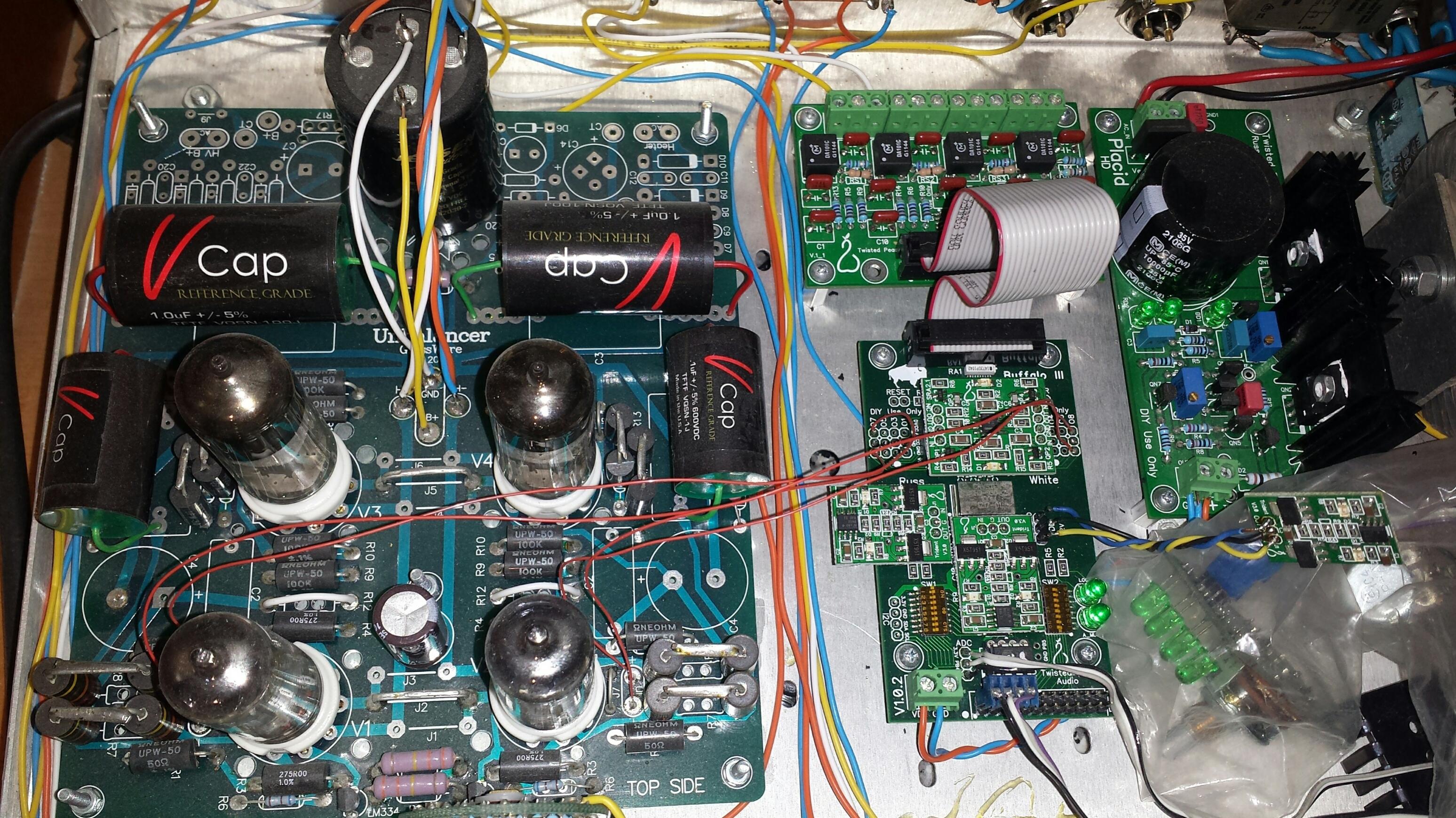

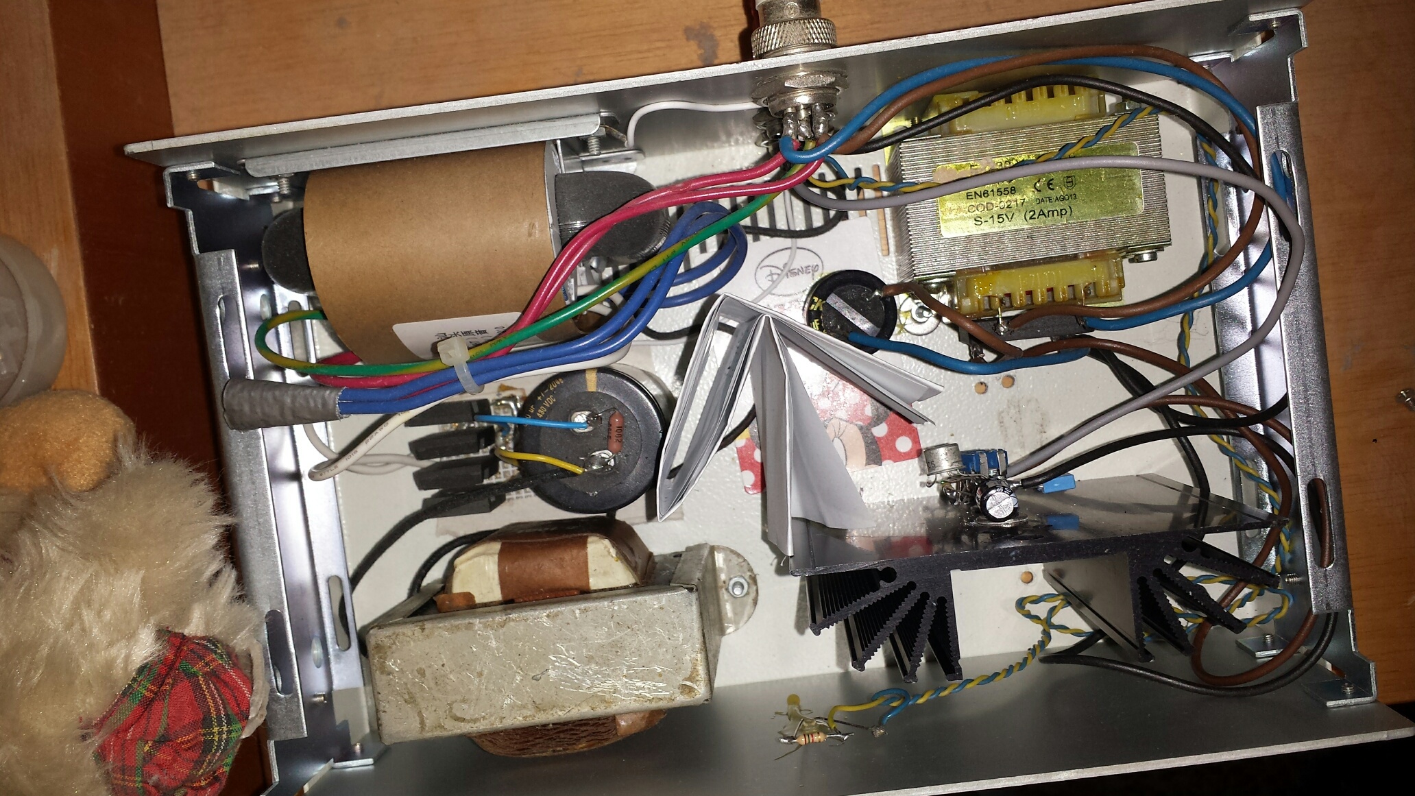

Hello again, I could do two photos. One with PSU and the other with B3 and unbalancer. PSU has two transformers, one with 170VAC 100mA and the other with 15VAC and 2A. I am using four hexfred diodes, one 220UF/350V, inductor of 15H and output to other box with electronics. The other transformer to low turn-on 12.6 V into filaments of four tubes (see unbalancer doc)
