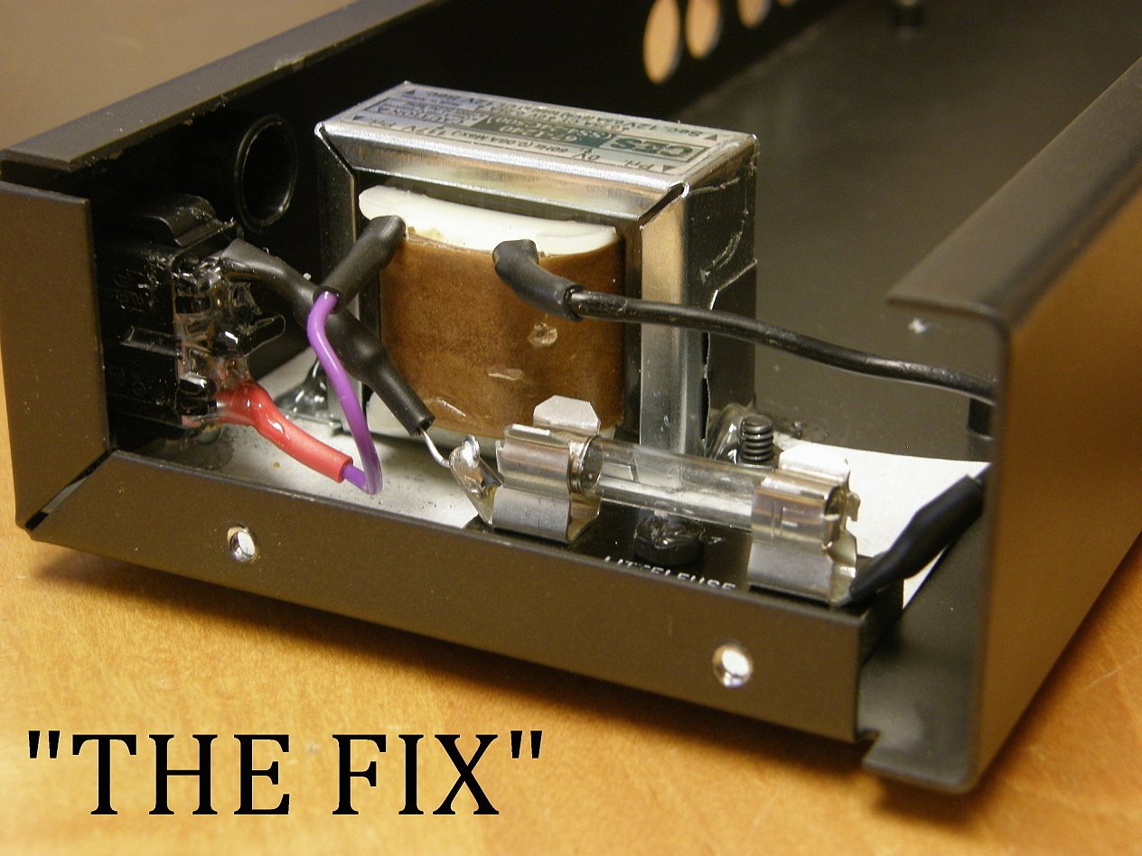

In the meantime, I find stuff like this to occupy myself. I bought a Carver C9 that stated the LED does not come on when plugged in. Popped the lid and folks, I have actually seen this TWICE in C-9 units! Now that is rough shipping to be able and rip the transformer from the board! As usual, this was my fix. Replace the transformer, cut the circuit board for room to mount the new tranny, etc. Bolt new stuff down and be done with it.
