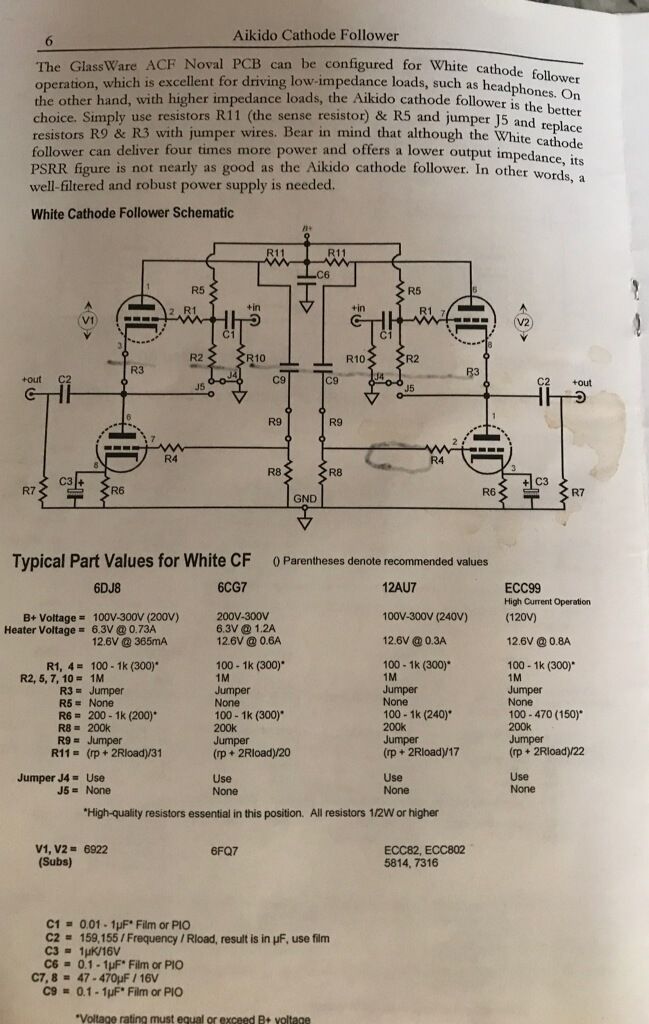

I've taken a photo of the printed manual that came with the board:
Dropbox - IMG_2531.jpg -
Hoping it all makes sense now...

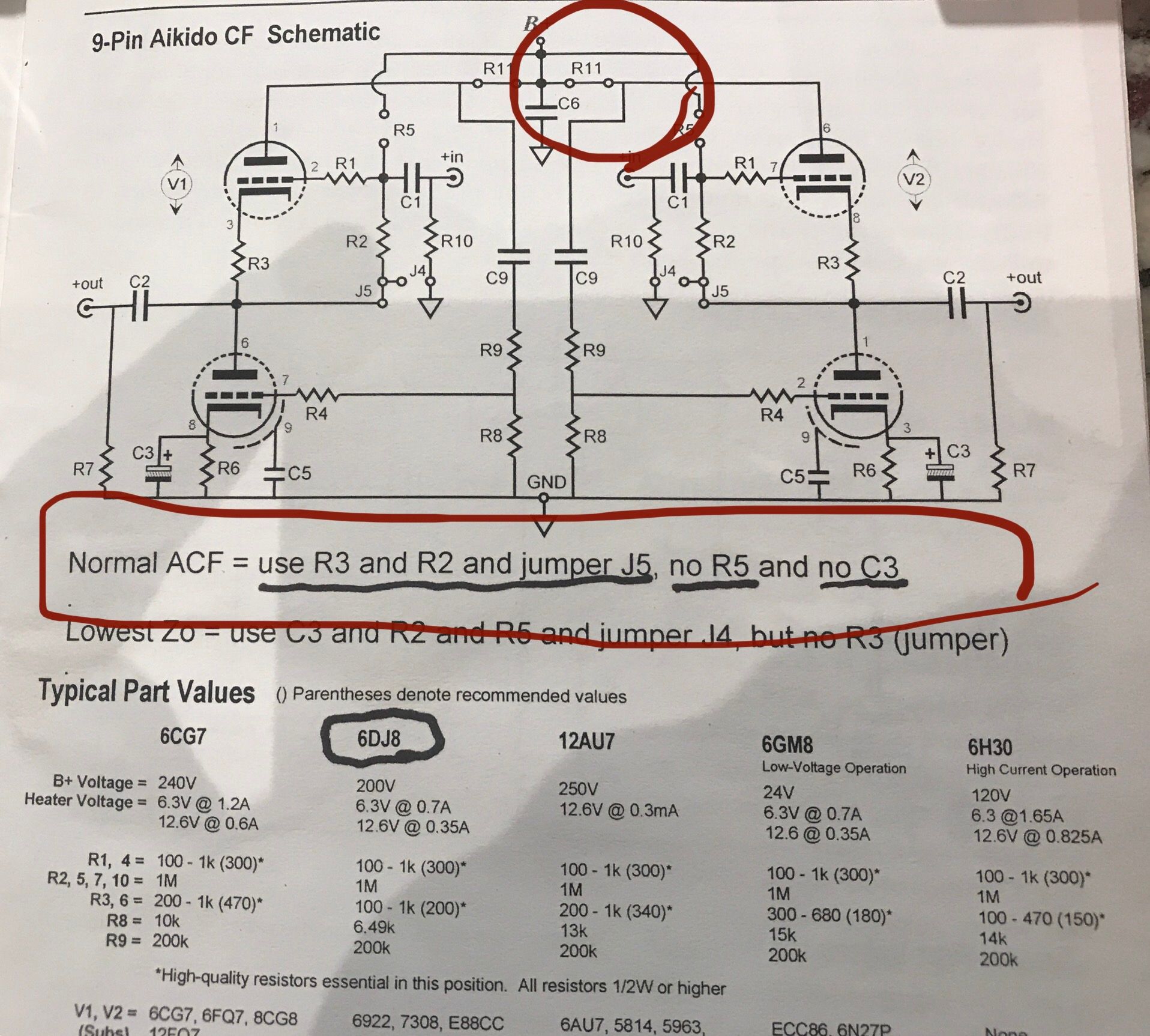

In post #6 you posted a schematic that you said was from the printed manual that came with your board. See the first photo below.
In your last post you link to a schematic that according to you also comes form the printed manual that came with your board. See the second photo below.
Are you a troll?
Are you a troll?
There are 2 possible configurations..
One is the "Normal Aikido Cathode follower ".
That is what is represented by the schematic in the first photo that you reposted.
The other, optional configuration, is a "White Cathode Follower ".
It is what is represented in the second/bottom photo.
Both possible configurations are presented in the manual.
