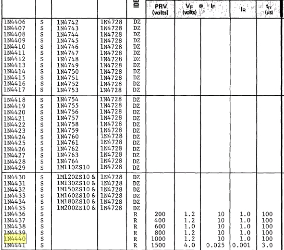

I have an amp on my bench now and have a question about diode markings.
It's a glass diode with 3 thin stripes, Black, yellow yellow, and a last one broad yellow stripe.
It measures about 0v653 reverse, and 0v527 forvard.
Is it a current diode?
/Figge

Here's a picture of it.
/Figge

Confirm where is it or what it´s doing, that will speak volumes about needed parameters.
No need to painfully write the whole schematic, but at least the 4 or 5 components or rails connected to it.
That is doable.
Is it wired in parallel with a relay coil fed from 15V?
Is it biasing a driver transistor or part of a protection circuit?
Etc etc etc.
I'm working on a Dynamic Precision DP-1000.
Someone have been messing around with NPN's and PNP's so I have to figure out how it's ment to work.
Floating rails with a standard 5 pairs BJT OPS, and 5 pairs between rails and ground !
Those diodes are there for biasing the predrivers so to me 1N4148 would do the work.
The clipping cirquit have four of them that works and they measure 0V555 in forward direction and blocks in reverse.
/Figge
