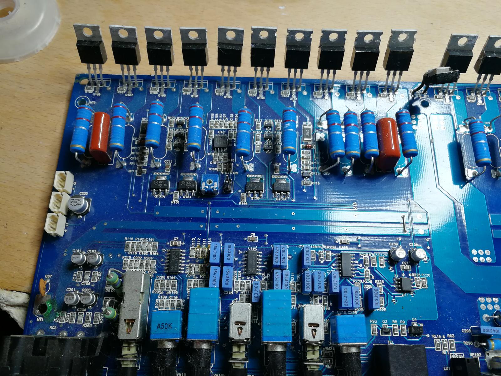

years ago i bought a broken Gladen amp. I tooked it to a guy, i thought he know what he does. It came back with horrible solderpoints and its not working.
Rails +- 45V, at the TLs at pre-amp i have +- 9V.
Output transistors get no bias. Across drive-transistors (AH-16/BH-16) B->E 0,5V.
I stuck a bit. Any schematics or something? Audio Systems 280.2 and 300.2 are very similar to this.

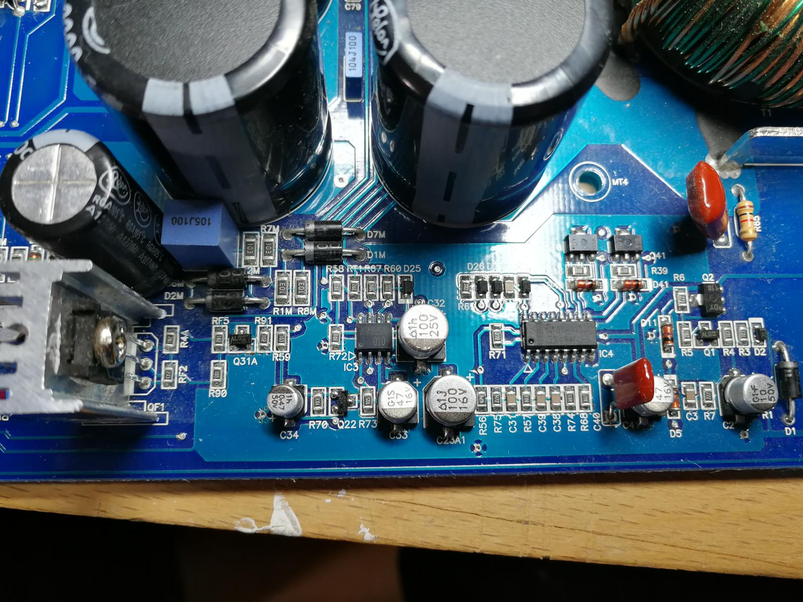

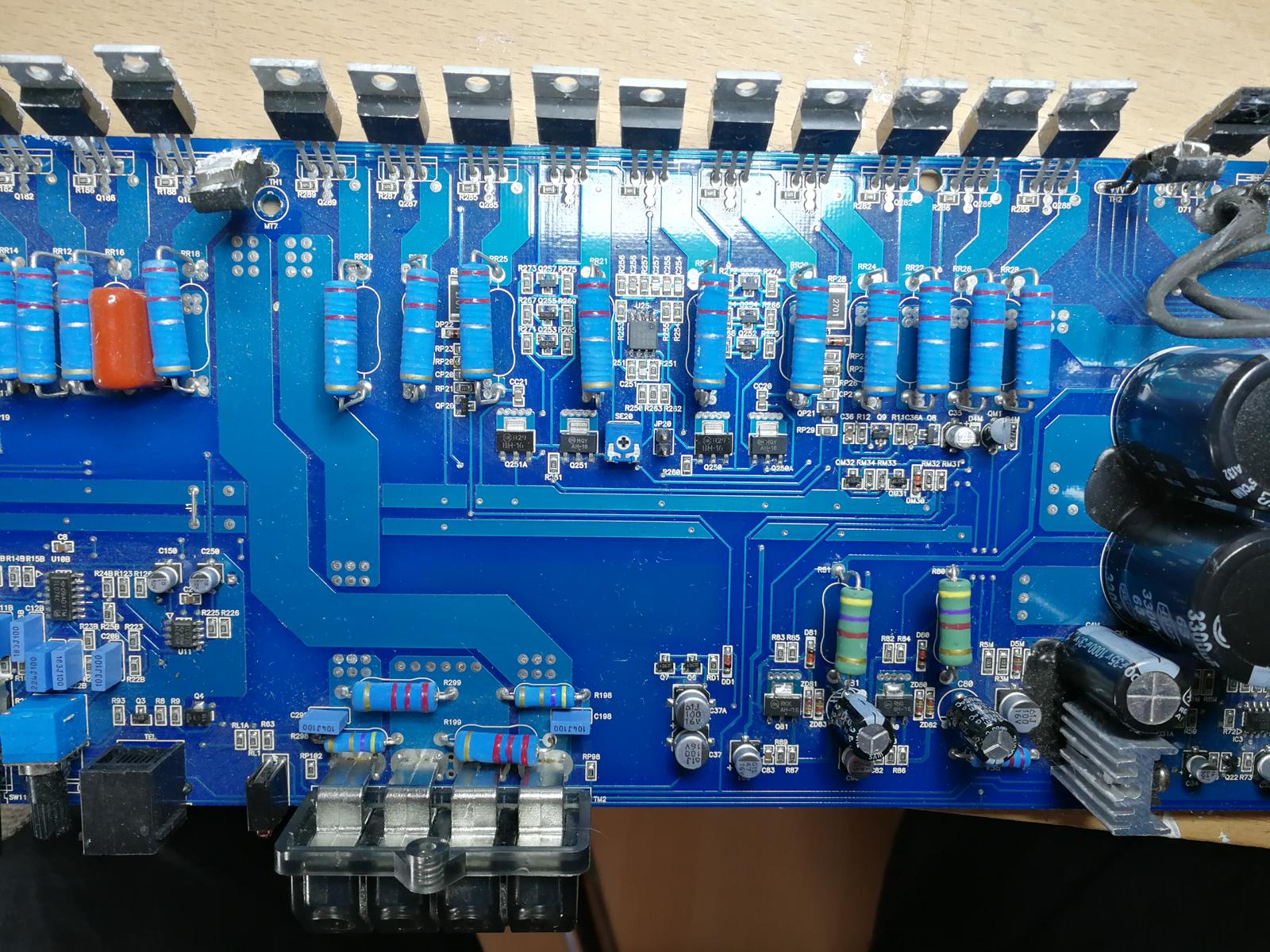

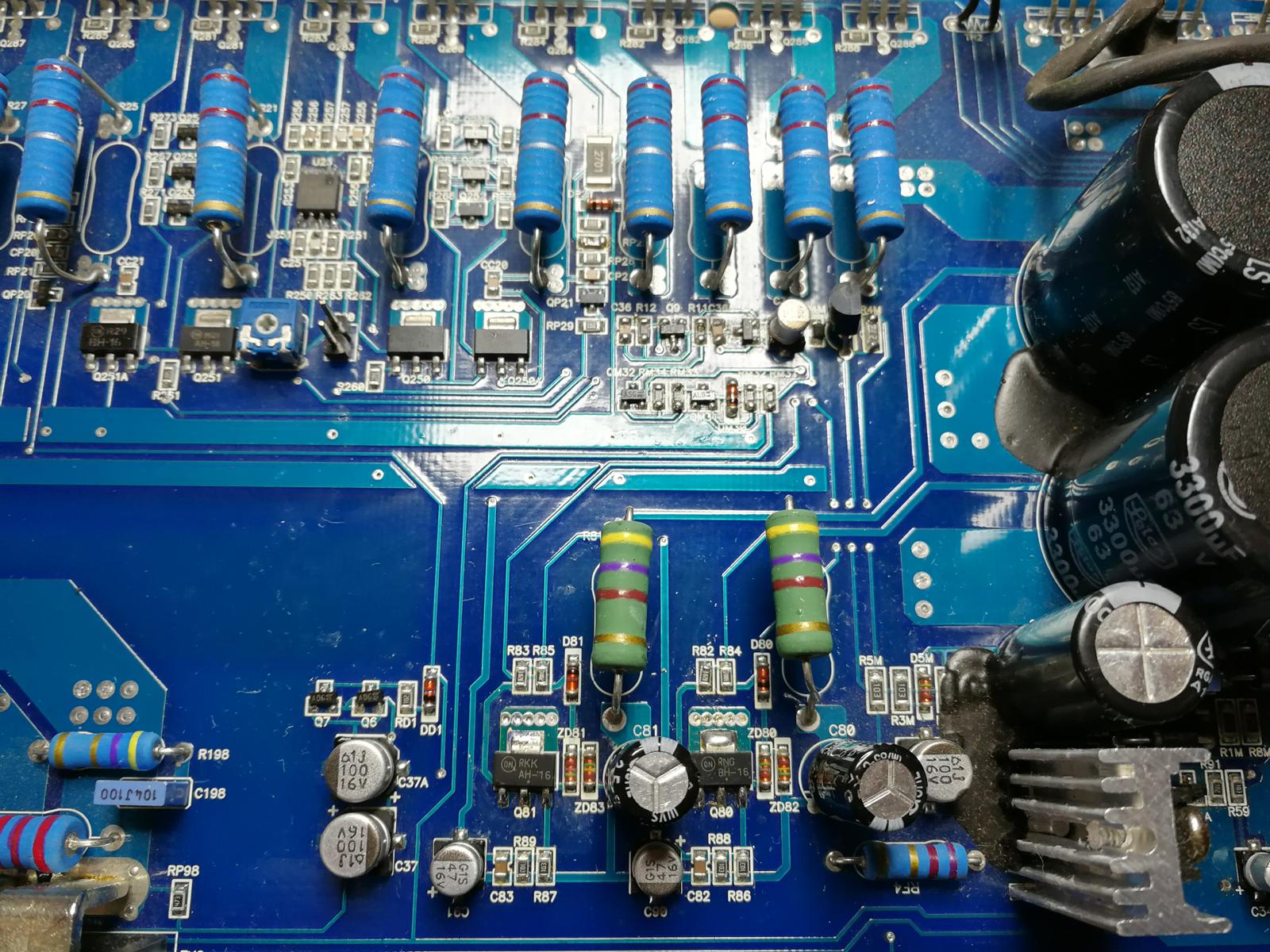

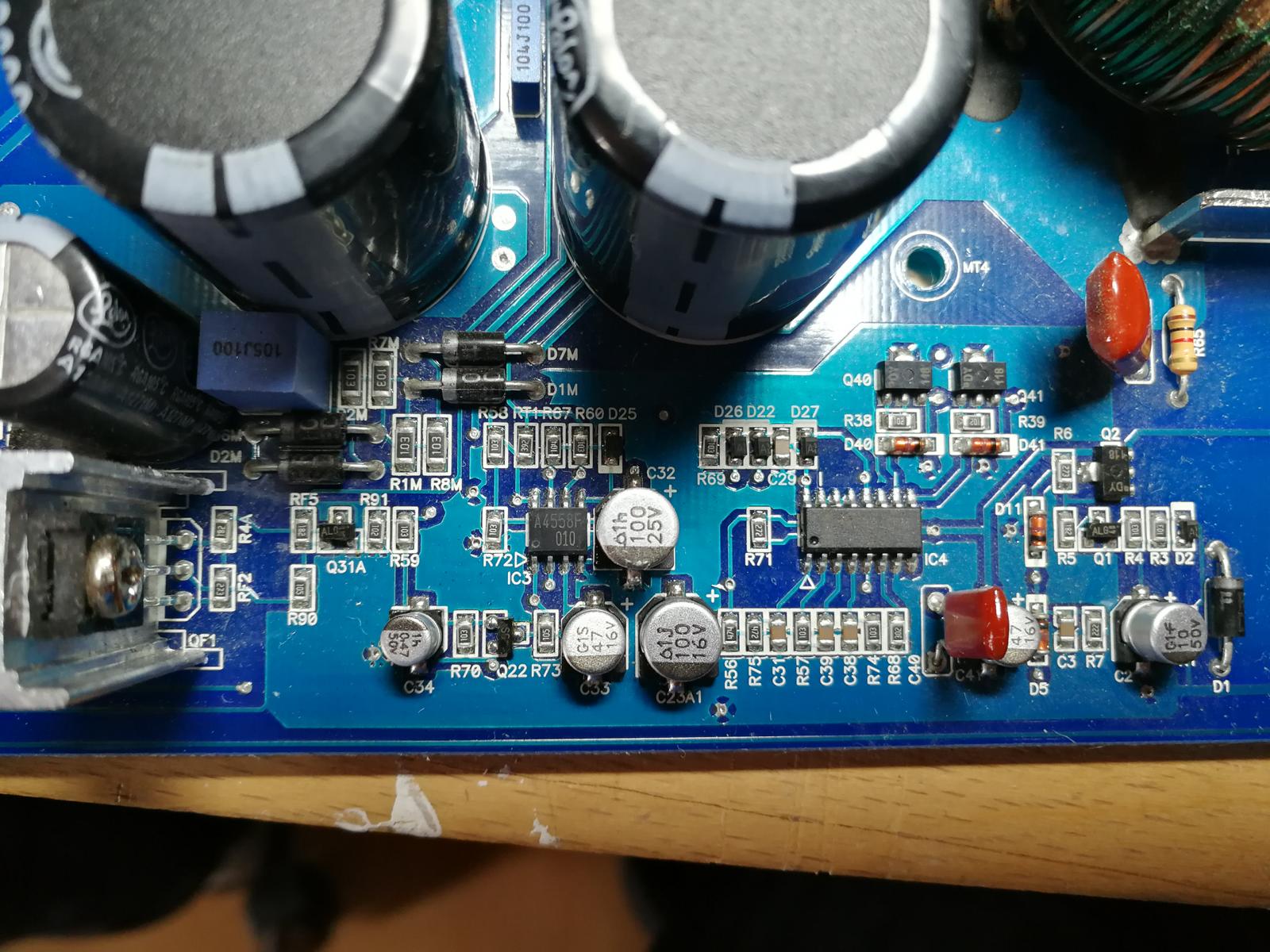

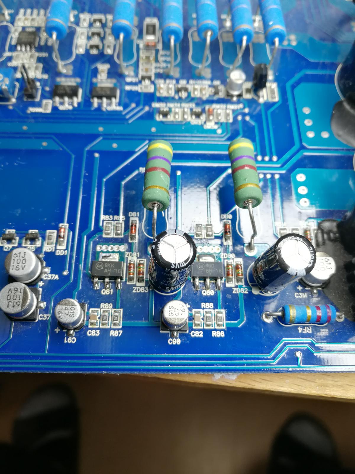

Now the pictures work 😎

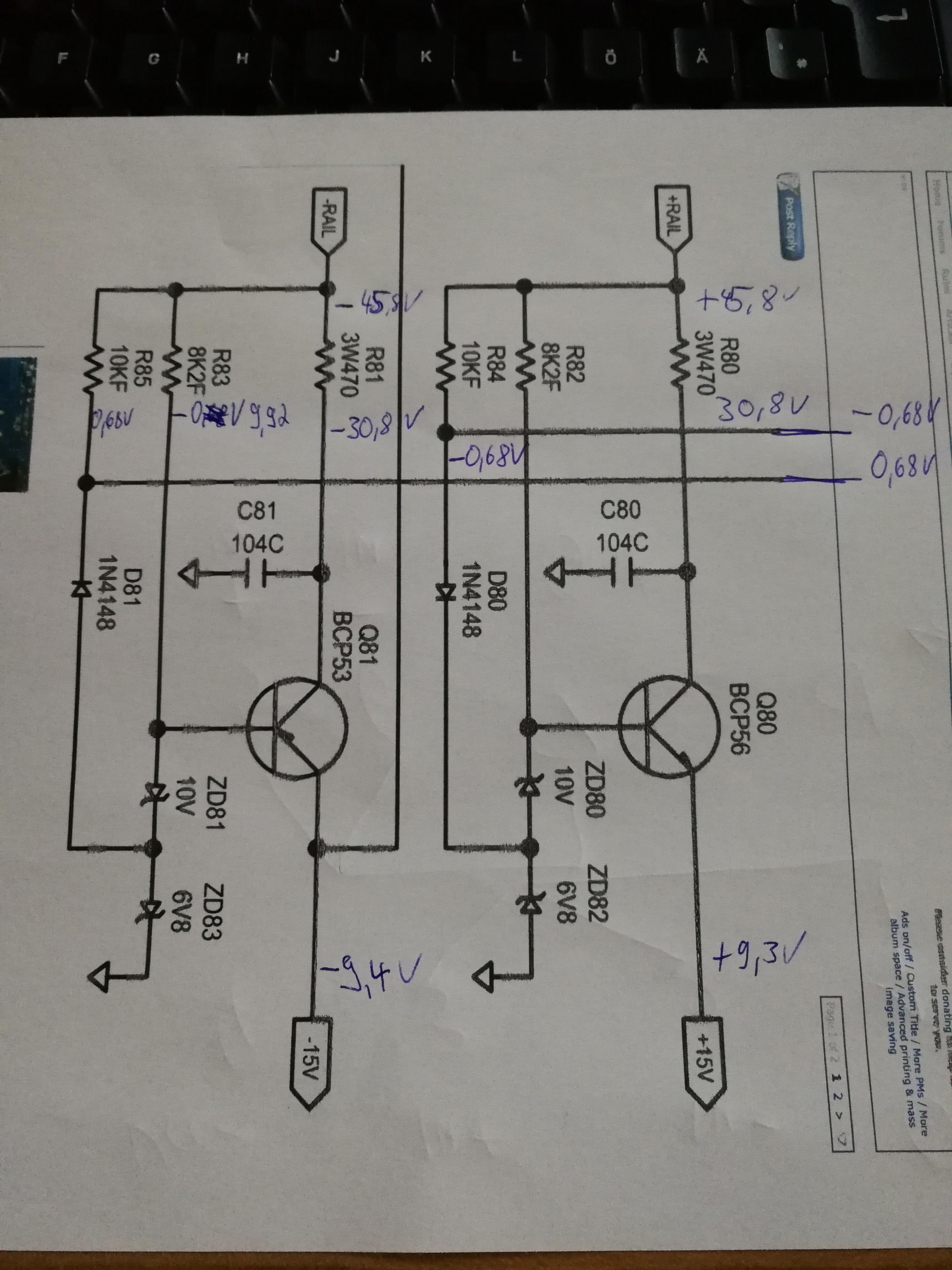

Found this schematic in another Gladen thread.
Measured the voltages against GND.
Hi Perry, thanks for your reply.
I found the problem seconds ago.
I build the shown circuit in a digital electronic circuit simulator.
That show me which voltages i have to measure.
Zener ZD82 + ZD83 both broken. I only have 7,5V Zeners here, but in this short test the amp run. Now i can order the right parts.
