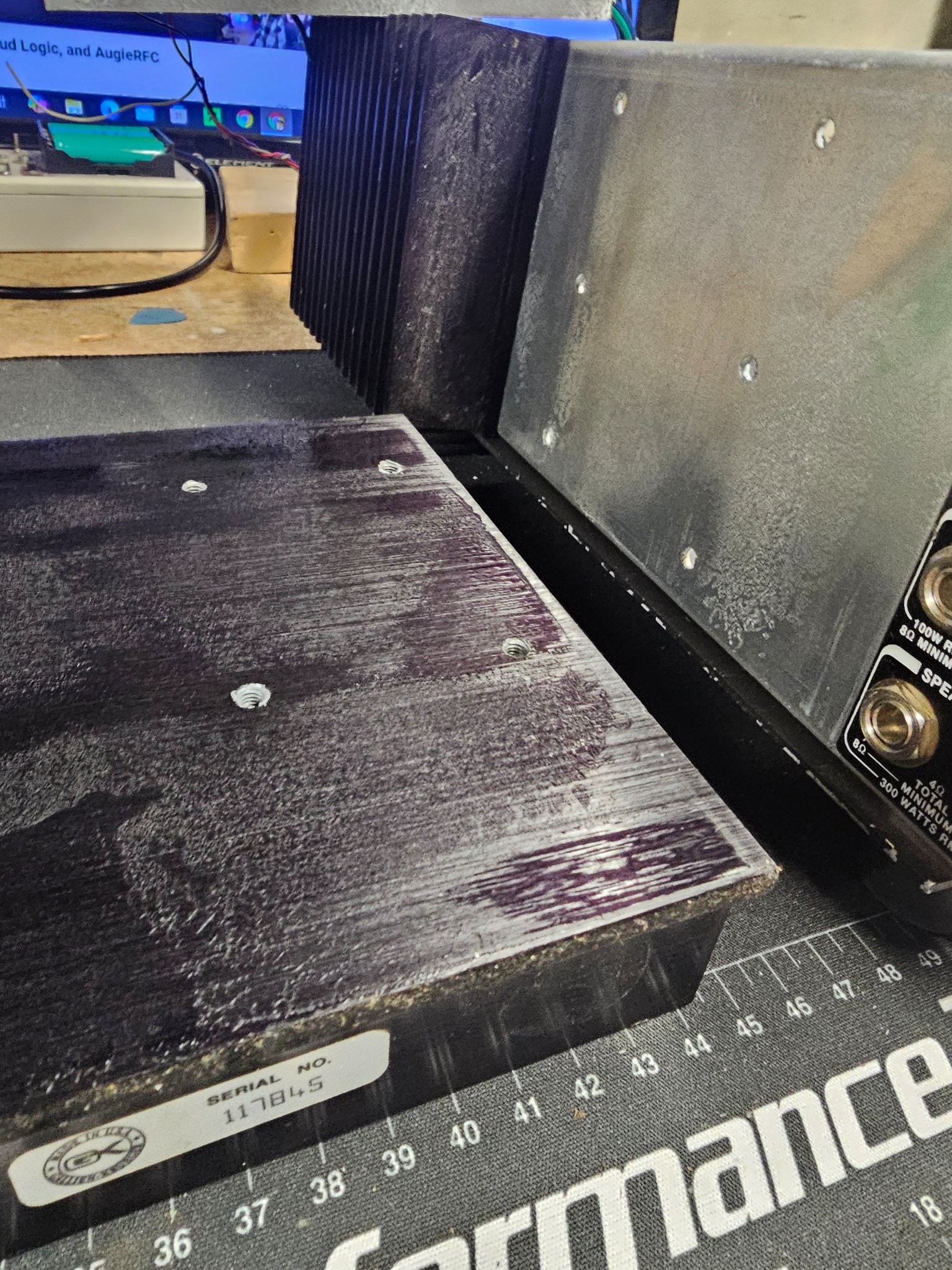

Has anyone ever seen clear thermal grease? Whatever this heatsink was applied with is clear. I thought it was condensation and got my hand all greasy.
When I reinstall, should I use real thermal paste?
Uh, yeah, the heat sink compound I buy is white. The white stuff is the heat conductive part. Dow 340 is the compound I buy.
