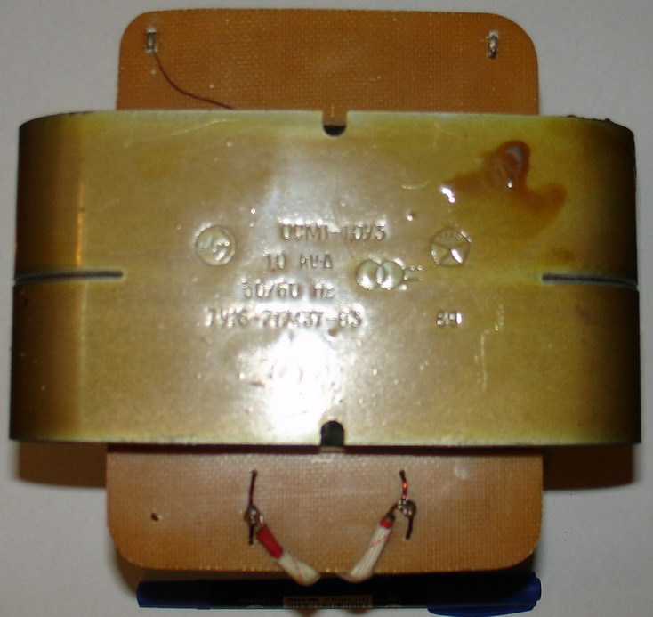

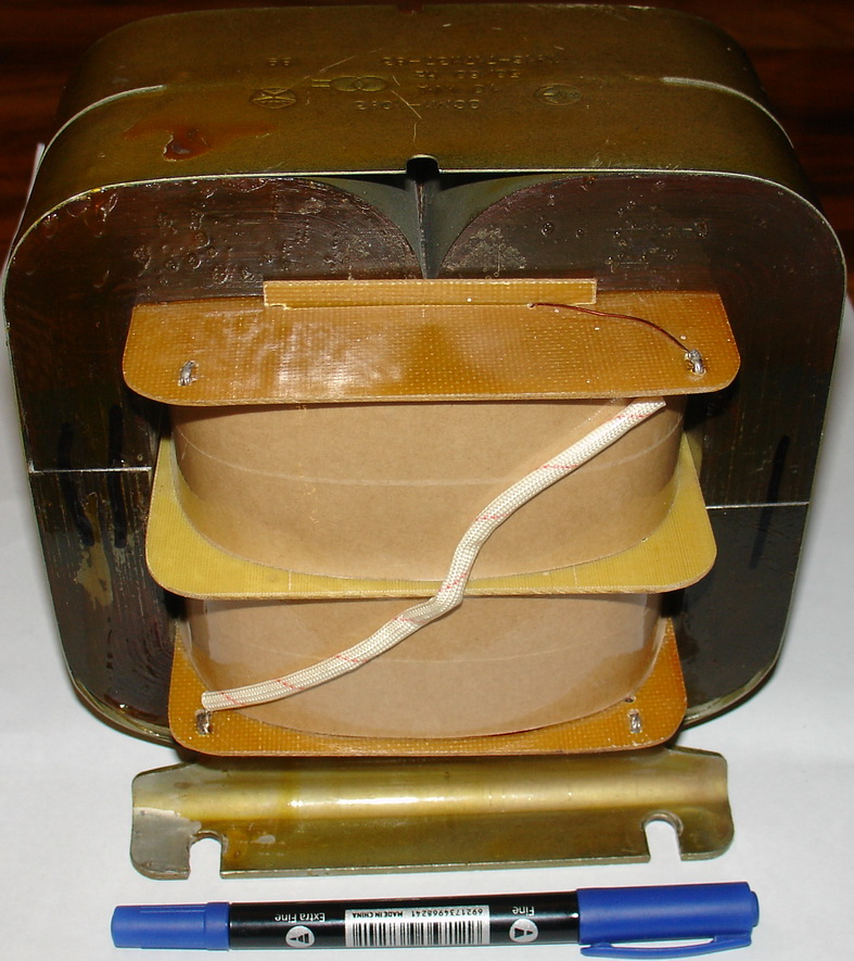

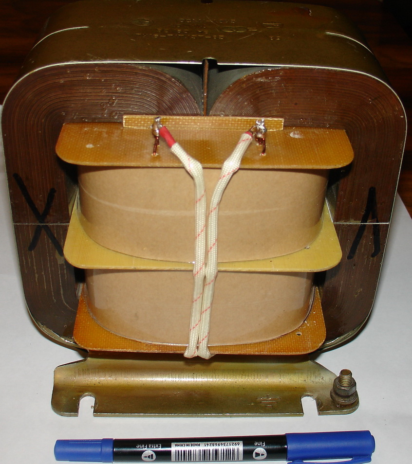

The OPT is a split bobbin design (two bobbins), wire of the primary is 0,5mm (including insulation), wire of the secondary is 1,1mm. Primary's sectioning is 4-8-8-4, secondary's is 2-2-2. Iron core 40cm2.Very nice work 🙂
Give us some info regarding the OPT's used in this project
Chris
All primary's sections are consequent, all secondary's sections are in parallel.
Resulting number of wounds per bobbin is 1838 and 74. For two bobbins (whole trafo) is n1=3676 and n2=74. I used such trafo with both GM70 and GK71. The aim was lower output impedance and lower distorsions.
With GM70 output impedance (1kHz) near 0,8 Ohms, with GK71 near 0,65 Ohms.

Here are some pictures and measurements of the output transformer.
With secondary shorted,
- primary's inductance reading is Ls = 14mH
- capacitance between primary and secondary is 8,66nF
Active resistance is 113 Ohms (primary) and 0,1 Ohms (secondary)
Inductance of primary is near 90H
