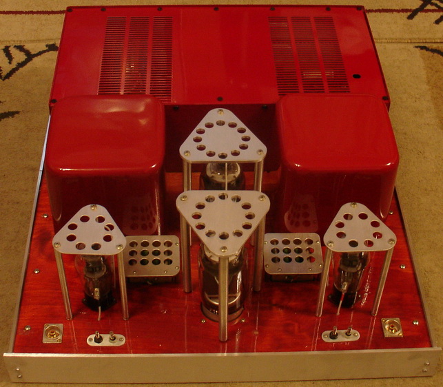

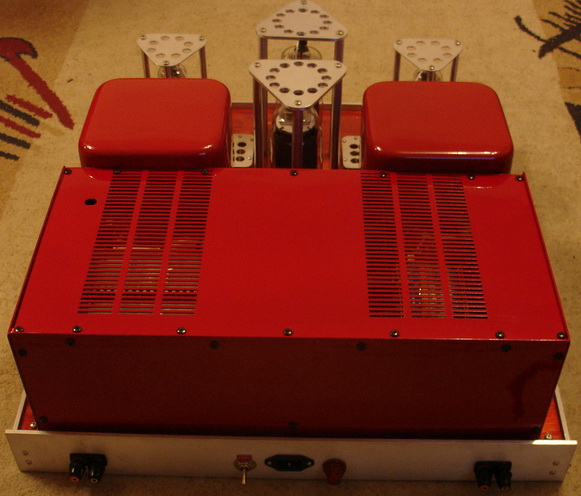

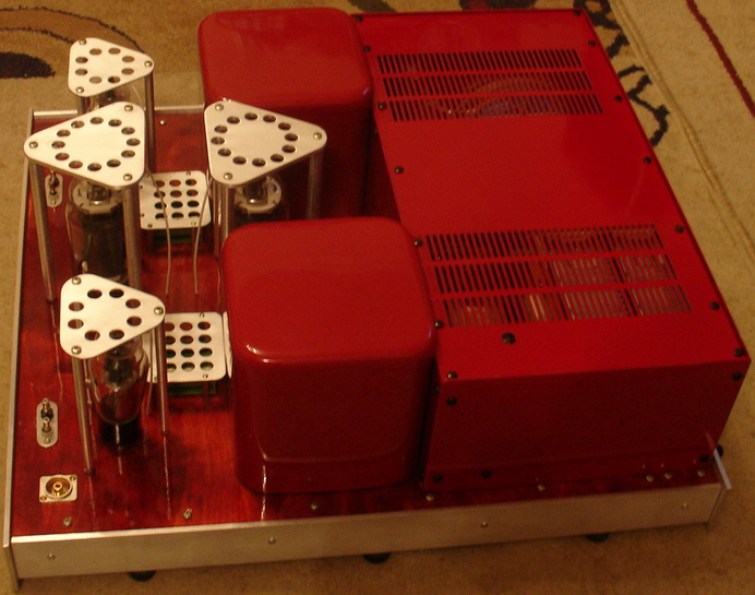

I have almost completed this GK-71 based SE amp, and it sounds better to me than my previous GM-70 SE, 6G-B8 PP, 2C4C SE (these tubes are 2A3 substitutes). G-411 (rare old tubes) are at the driver stage, and 6P9 - at input stage. All tubes are in triode mode, and are quite powerful. Some advantages of GK-71 against GM-70 are: lower Ri (internal resistance) around 1k4 vs 1k7 for GM-70, and, it sounds good starting from 800V, while GM-70 needs 1200V.
The input stage is made as a separate case with volume control (actually as preamp).

I have not tested, actually I used 9K (with impedance of PMC EB1i speakers taken as 3,6 Ohms). I measured frequency dependence of impedance vs frequency with good immittance meater, and it is near 3,6 Ohms within 50...200 Hz. Output trafos are similar to those for GM-70, turns ratio n1/n2 near 50. The core is 40cm2 (50x80mm), made locally (vertical and horizontal sectioning, 4 prim + 3 sec vertically, 2 sections horizontally). The last is very useful for lowering dynamic capacitance.
When I looked passband, at 10Hz I saw only some phase shift (amplitude still the same visually), at highs -1dB is near 30kHz.
GK-71 cathode is on the ground via 1 Ohm control resistor, negative grid bias around 120V, plate voltage near 850V, plate current 110mA.
G-411 cathode is biased by 5W 20V zener at high enough current (near 40mA), shunted by lytic and film caps and silver-mica caps.
6P9 cathode is biased by 1W 6V zener, without shunting (this zener has relavely low noise).
All plate voltages are from separate trafos, finally filtered by mosfet source followers, with good film and silver-mica caps shunting near tube sockets.
For GK-71 filament heating I used 24V-15A SMPS, coolers are taken off since one uses only 3A, and excessive 4v (20V are needed for filament) are damped by 5-stages RC filtering for ripples elimination. Again, filament rails are shunted by film + silver-mica caps near tube sockets.
Signal to noise ratio obtained is very good, nothing is heared from speakers. Acoustic background is very "dark" during pauses.
very excellent!
Dear VladimirK,
the pics of your finished amp are excellent looking and indicate great craftsmanship! Congratulations!!
The color combination of the wood and the metal looks very nice to me. I like it.
Due to your initial post I ordered some GK-71's (not yet arrived) -despite having already some GM70's- because your mentioning of a B+ below 1kV seemed attractive to me. So, one day I'll build a GK-71 SE too.

Thanks, Ulrich, I find this design solution quite convenient (though at a limit of acceptable size), instead of multi-floor or separated cases designs. At least, I needed much less efforts with cases, as compared to previous separate blocks with GM70.
