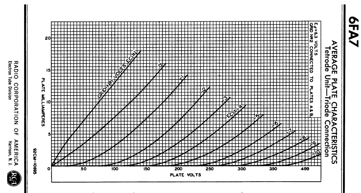

I found a datasheet here: http://www.tubebooks.org/tubedata/hb-3/receiving_tubes_part_2/6FA7.PDFThe twin plate tetrode?
Looks like the twin-plate tetrode was intended for "frequency divider and complex waveform generator" use, though I have no idea how. 😕
That doesn't sound very useful in a guitar amp, and the drastic "tetrode kink" in the curves makes it useless for audio amplification.
But what leaped out at me was the triode-mode curves for the tetrode. It looks like the weird tetrode makes a perfectly well-behaved triode if you just strap the two plates and screen grid together (see attached image.) And that triode could very well be used as a gain stage in a guitar amp...though I didn't bother to work out gm, mu, and rp from the graph.
-Gnobuddy

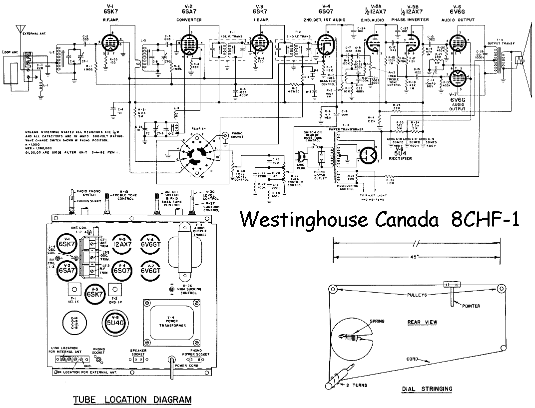

> I did a , 'What is this?'
It is probably a superior AM radio, will pull distant cities. Note RF stage.
It is a DeLuxe-class guitar amp project. Re-rig the IF stage as audio preamp.
Canadian Westinghouse, Hamilton from A43 to W552-A, 143 pict
8CHF-1 Radio Canadian Westinghouse, Hamilton, build 1956 ?

Thank you sir, I could not find the schematic. I probably would be stripping it and putting it in a different chassis, I bent up a few before I retired. I am starting to think I may end up with an excess of amps.
