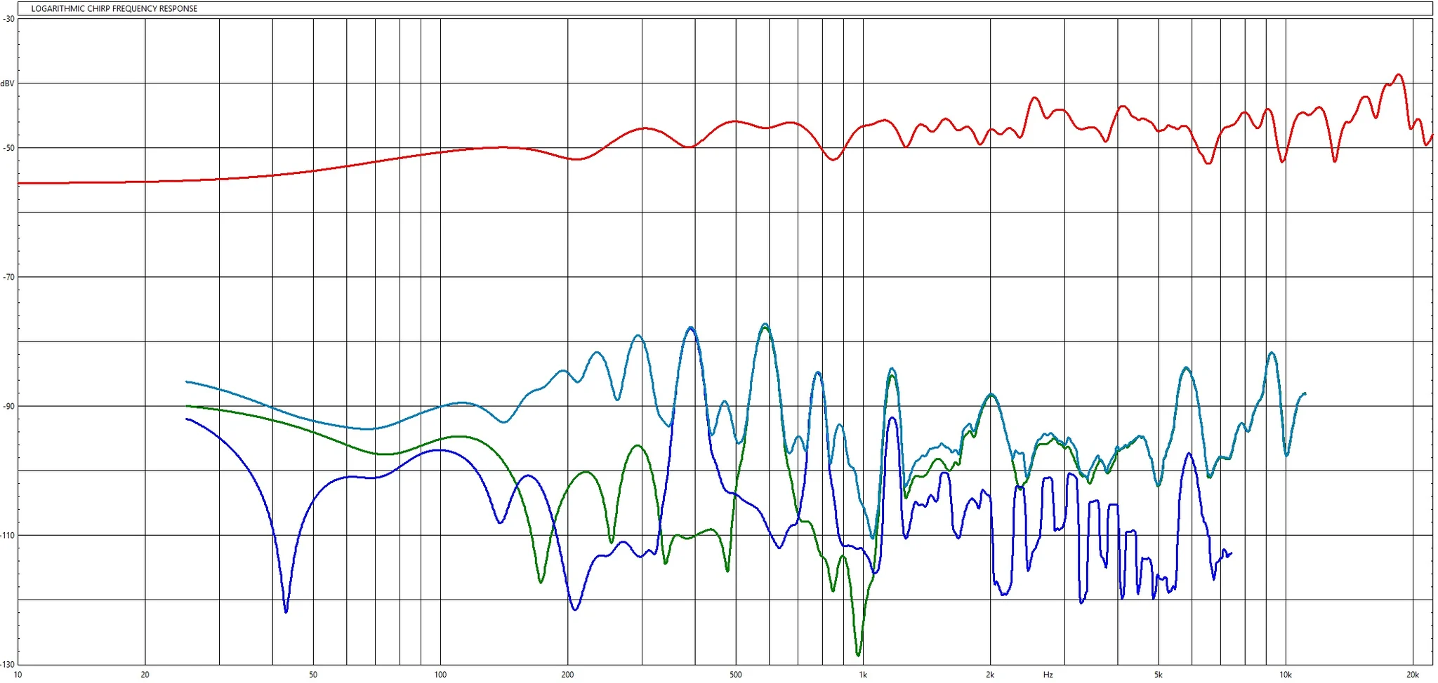

It's fairly difficult to name a ten dollar enhancement that does more to improve speaker perfromance than Kef's metamaterial absorber.
I've posted measurements I've made of the ones I 3D printed. They achieved the following:
1) simplifies passive crossover design by reducing the height of the impedance peak of the driver.
2) It significantly lowers distortion. Someone who knows loudspeaker motors better than I do would have to chime in on this one. I believe it's related to the change in the impedance curve. For instance, I put a metamaterial absorber on a BG NEO3 clone and it did absolutely nothing. I believe the reason for this is because the NEO3 has nearly no impedance peak.
3) Due to the larger chamber size, the tweeter tends to play lower.

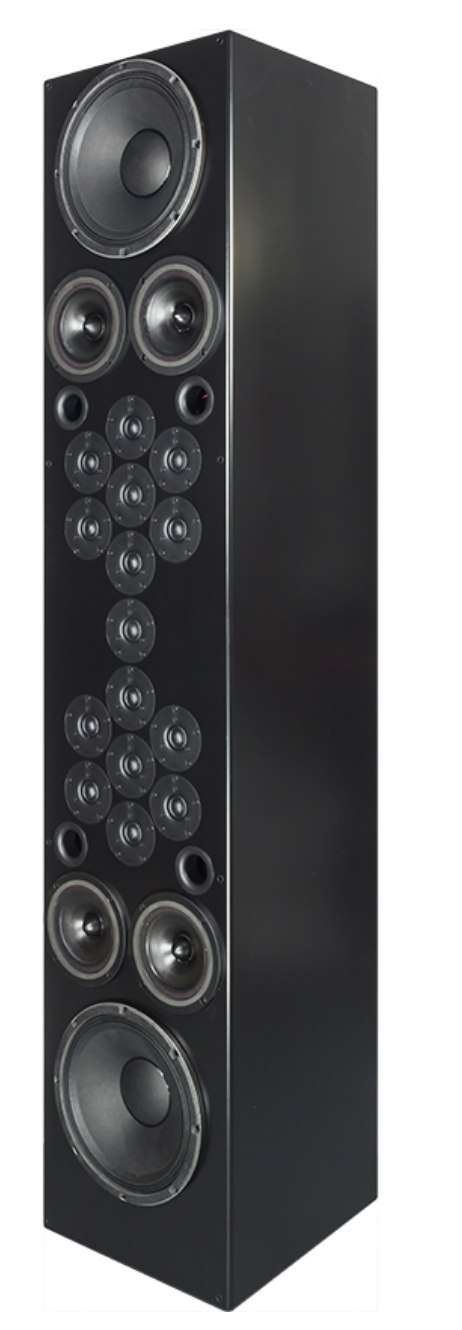

Far as the " brand" using 6 zillion tweeters with horrid center to center. serving no purpose.
yes horrible. Making assumptions how horrible was assumption. until finally seeing some measurements of the things.
Yup did what expected.
