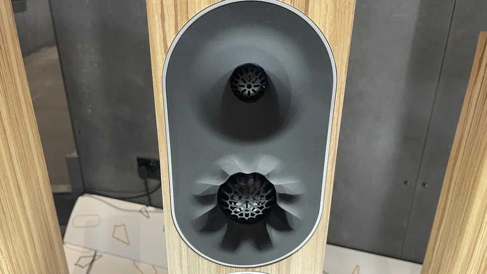

To start off, I present This..... I hypothesize diffraction from the skinny slots/groove in termination of the waveguide... desireable or even on purpose, unknown..... Laminar air flow? Skepticism draws near.... Reduces distortion? Why is there a distortion problem in the first place?
"an unusually complex flower-shaped waveguide to improve dispersion."

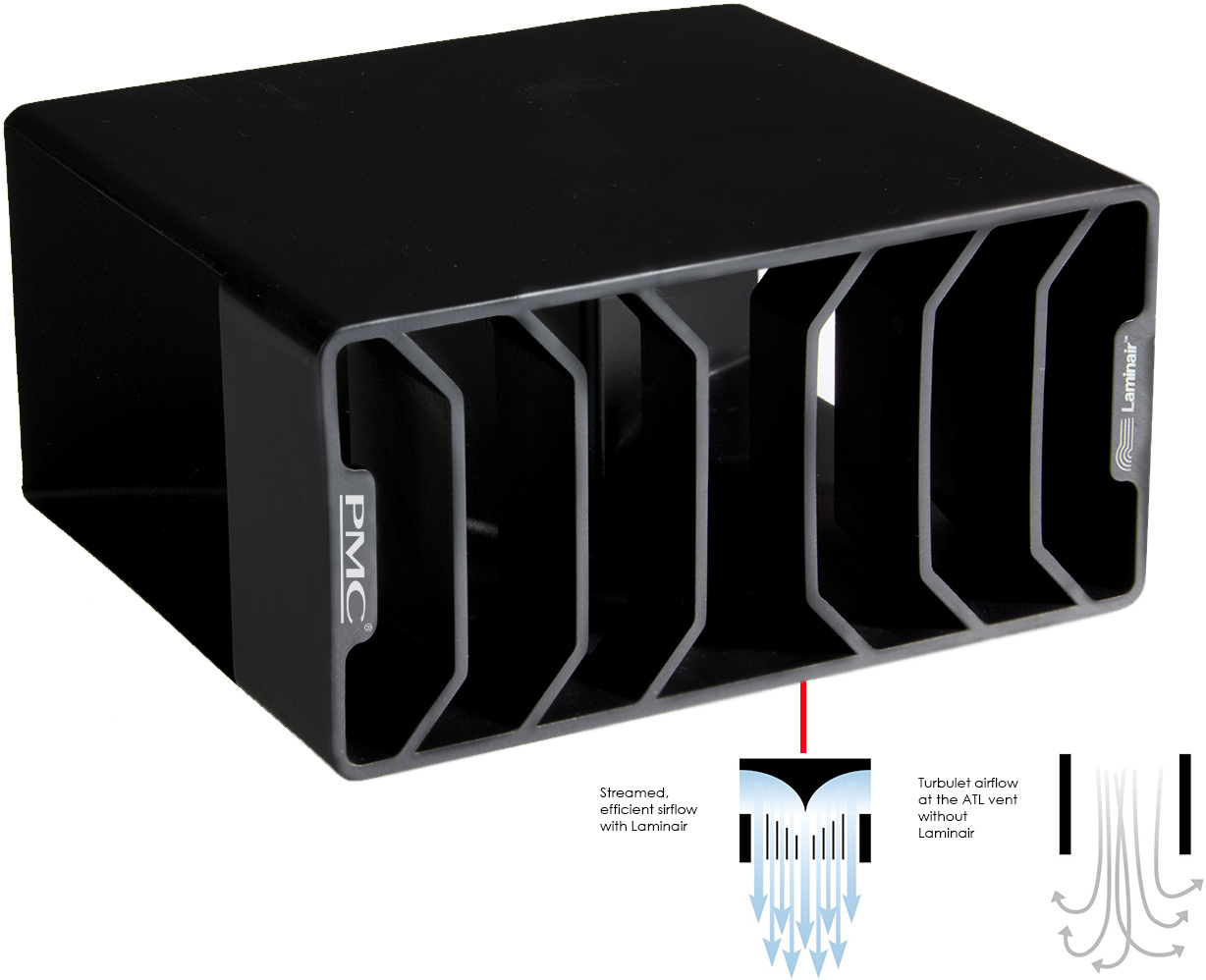

Yes! Any sharp edge inside a port will increase chuffing noise.Laminar air flow? Skepticism draws near....
I tried it and it was disastrous.
One can probably try to force air into laminar flow, but it creates lots of annoying higher pitched noise.

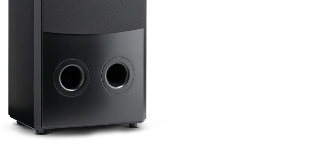

Oh, I thought this was about the first image, presumably a reflex port ... ?I mean this a midrange
ok I see what the laminar is focused on now.

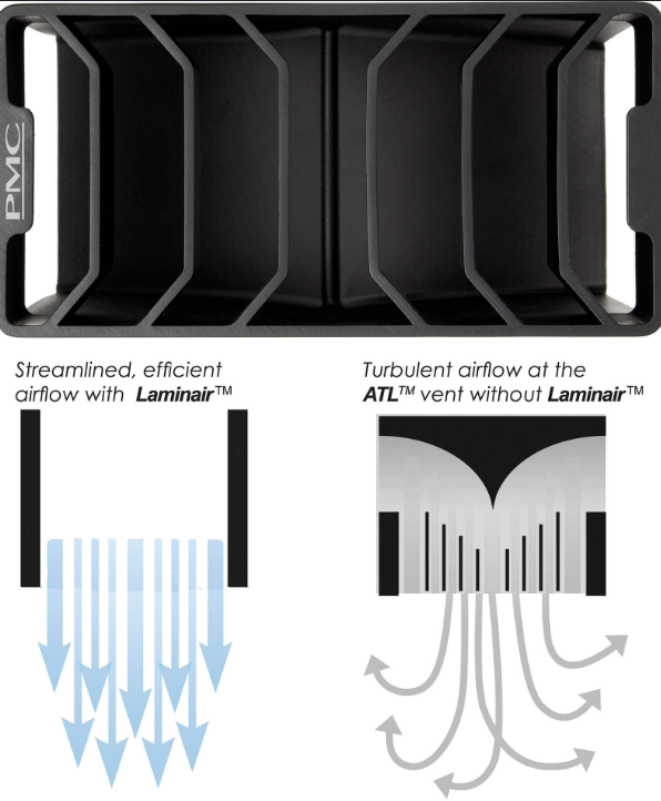

People will believe anything if put in a graph or illustration
Making the illustration on the right black and white really sells the infomercial aesthetic
... even the misconception that a straight air jet at port output is desirable ...will believe anything if put in a graph or illustration
I like your exchanged illustration ... it even took some time to realize it!
I mean its about as credible as the original... Laminar flow is had when the pressure gradient is equal across the the terminus. I regular BR at/near tuing has laminar flow already....Low enough pressure would introduce turbulence but the end of the day, this aspect inconsequential towards sound quality. I might be mistaken but the fins in this creations do nothing beneficial. If any thing there are some consequences of port noise at higher spl levels....I like your exchanged illustration ... it even took some time to realize it!

PMC's "LaminairX" slots at the end of the transmission line are not a "waveguide", they are there to increase the hydraulic diameter of the duct, lowering it's Reynolds number, increasing laminar flow potential, reducing air turbulence, which causes chuffing noise, which is a form of distortion.To start off, I present This..... I hypothesize diffraction from the skinny slots/groove in termination of the waveguide... desireable or even on purpose, unknown..... Laminar air flow? Skepticism draws near.... Reduces distortion? Why is there a distortion problem in the first place?

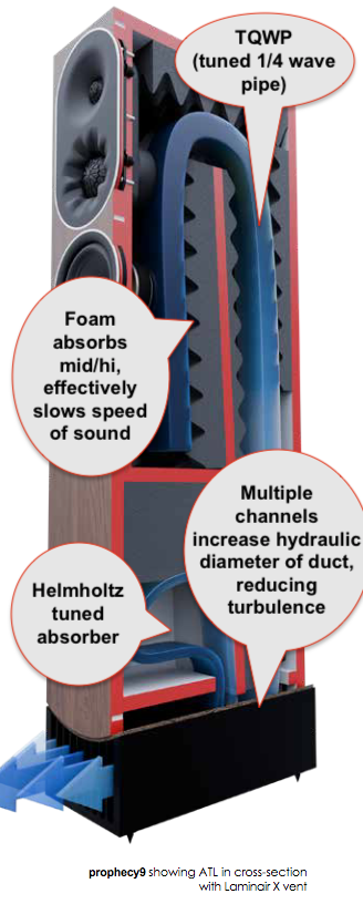

The foam in the transmission line (tuned quarter wave pipe, TWQP) absorbs upper bass frequencies which may be out of phase with the woofer's direct output when exiting from the pipe. That "phase distortion" would cause peaks and dips in frequency response, and multiple time arrivals, "impulse response distortion".
The Helmholtz tuned absorber reduces unwanted positive low mid reinforcement (boom/mud).
The foam also increases the effective path length (effectively slowing the speed of sound), so a shorter pipe can reinforce a lower frequency than it would without.
Like JBL's "High definition Imaging" (HDI) waveguide, PMC's "n-compass" waveguide increases lower frequency loading while not restricting the higher frequency dispersion."an unusually complex flower-shaped waveguide to improve dispersion."
The "n-compass" waveguide provides more low frequency output from the 2" dome without requiring increased excursion (a potential source of HD and IMD), while also increasing upper output and widening the dispersion through relatively low diffraction "slots".
As usual, simple marketing names can't give a full description of technological features, but none of PMC's features are "gimmicks", they are all implementations of proven, acoustically valid concepts.Either way, we are still in the land of gimmick... I wonder what "technology" they are using to push the midrange waveguide.
Reducing the cross-sectional area increases the average velocity and increases the duct Reynold's number. Introducing a significant amount of extra surface area increases the drag opposing the flow in and out of the duct/port. Flow is always laminar next to a wall which would indeed increase the proportion of the air flow that is laminar if the velocity away from the wall hadn't also been increased by the reduction in cross-sectional area which will decrease the thickness of a laminar sublayer. The changed shape will also have an effect. Increasing the friction of the port may not be desirable depending on how the port/line is tuned. PMCs port/lines are often not conventionally tuned and tend not to perform that well by conventional standards.

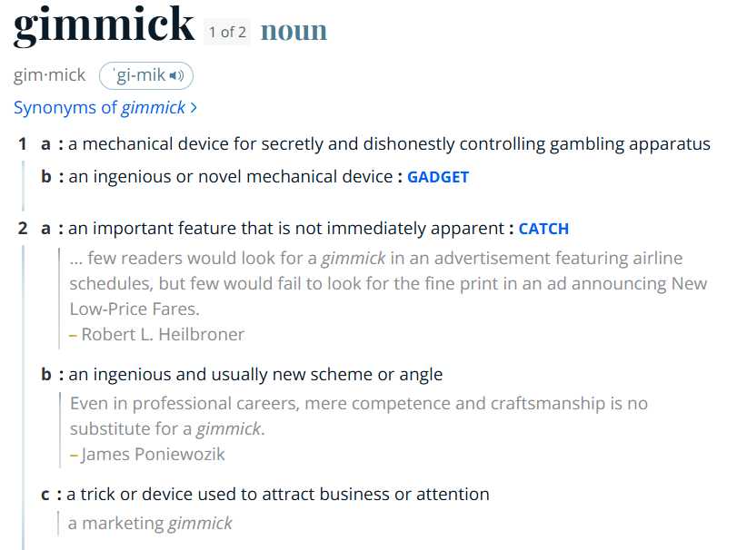

": a trick or device used to attract business or attention
a marketing gimmick"

If the only reasons something is done, is in order to make a sales bullet... thats a gimmick.features that have a weak-to-no engineering case

I hypothesize diffraction from the skinny slots/groove in termination of the waveguide"
That makes sense. The shape increase the perimeter of the mouth, lowering the fundamental at the mouth. It would be nice to see the performance of a waveguide with similar dimension but without the grooves in comparence, to see the difference.The "n-compass" waveguide provides more low frequency output from the 2" dome without requiring increased excursion (a potential source of HD and IMD), while also increasing upper output and widening the dispersion through relatively low diffraction "slots".
